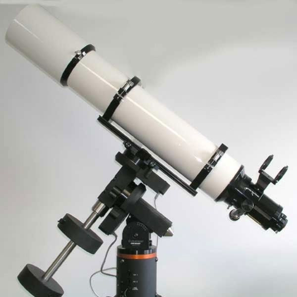

參考圖片:
- 整鏡外型僅作參考,調焦筒與圖片3.5"羽毛調焦有別

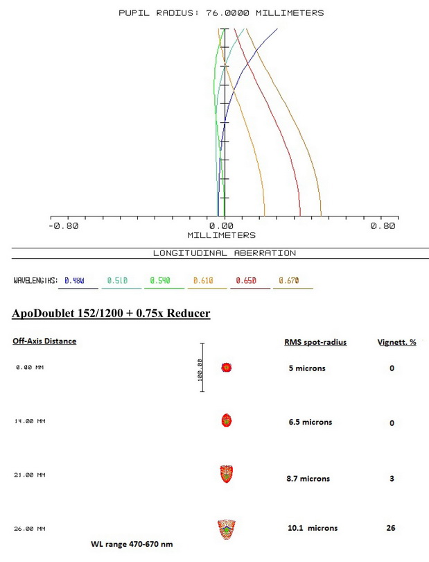

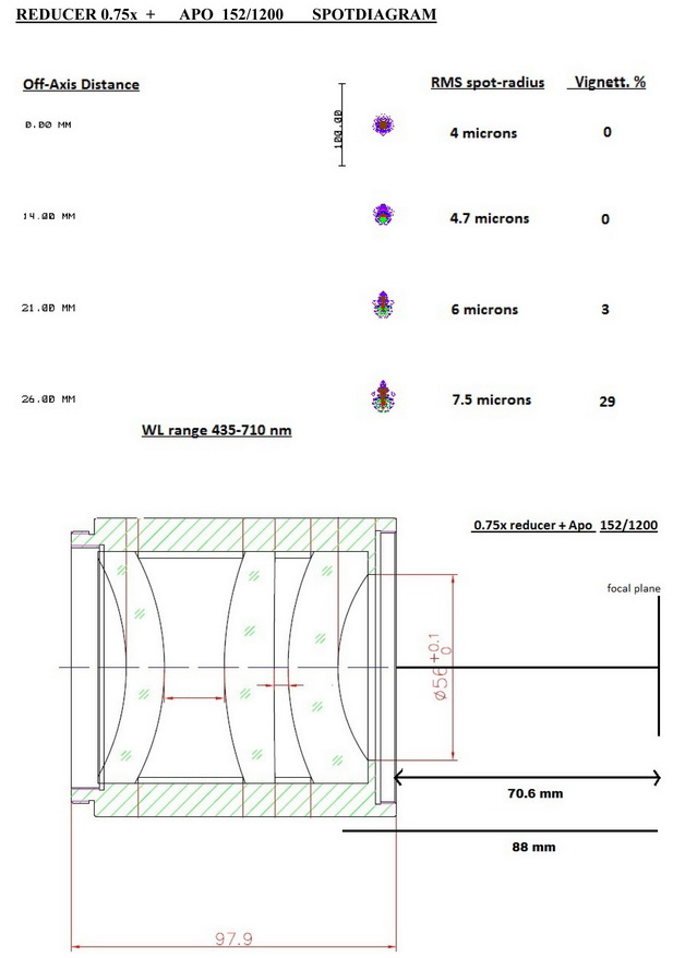

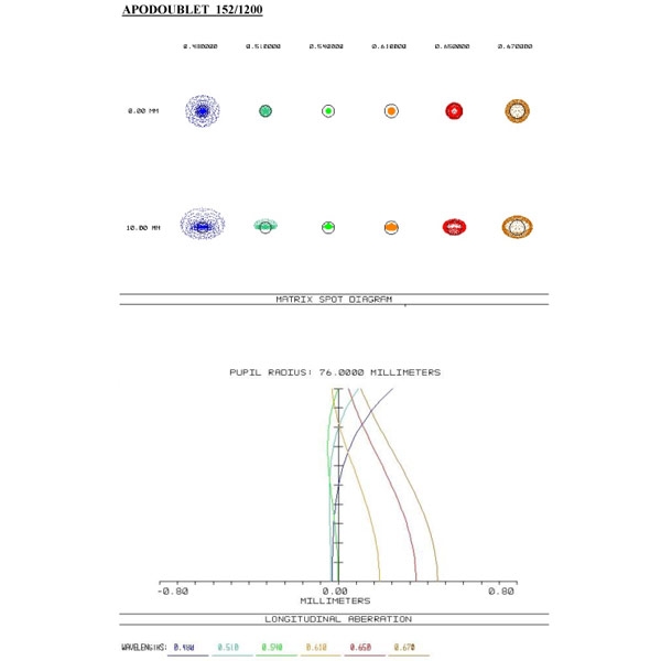

以雙片式空氣頭來說,這台鏡的水平是極高的,Ha接近繞射極限,紫色則是3X埃利盤水平,Strehl測試波段532nm也會在95%以上,那只是Polystrehl比三片式APO稍遜。

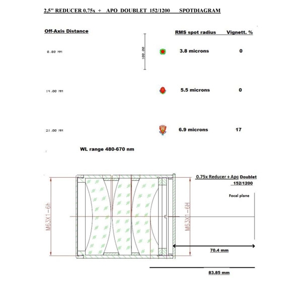

這台鏡的另一優勢是有現成不算貴的0.75x減焦鏡,Massimo Riccardi是按APM型號,逐一以鏡間距離及後焦點去優化,結果在拍攝上至少在全片幅下與APM-TMB系無甚分別。
看APM-TMB 152/1200及APM-Riccardi 152/1200的Spot diagram,若選用3.5" APM-Riccardi減焦鏡,都可覆蓋16803晶片,只是在36x36片幅的角上失光半級光圈而已。
ApoDoublet 152_1200+075x reducer-2.jpg (75.43 KiB) 被瀏覽 14486 次
Apo 152_1200+075x reducer.jpg (88.3 KiB) 被瀏覽 14486 次

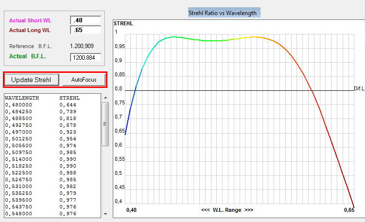

The new 2-lens Super ED Apo has been developed from the best known optical designer Massimo Riccardi. The optics will be produced by the company LZOS in Russia with the same high quality as the 3-lens LZOS Apochromats. The choosed glass material combination is OK4 (Super ED) and OF1 (Russian equivalent to Schott KzFSN2). This combination reaches the best possible colorcorrection for such a large and fast 2-lens Apochromat. This optics is a airspaced Apochromat and all 4 optical surfaces are broadband multicoated. Each optics has an serial number and will be delivered with an interferometrical test report.
Strehl Apodoublet152_1200.jpg (101.74 KiB) 被瀏覽 14438 次

最新的測試報告:
Last night and this morning I could test again the new LZOS doublet.
This doublet 152 mm F/8 was tested by Wolfgang Rohr. The Testresult showed that LZOS exceeedd by here tweaking the theorical performance , only in red it falls down, but red is not sensitive for human eye, so visual testings is not hurted by red.
Taking of the non visible red color, Mr. Rohr found it’s a real apo.
Already nights before I checked the apo on stars and Monn, last night the moons Limp with its craters, Jupiter, Venus and Stars was observered again up to 300 power
This new doublet is amazing, it exceeds the Takahahsi FS 152 in visible colorcorrection
Infocuse there is zero color, zero blue, purple or whats ever on Moon, stars, Jupiter and even Venus showed zero purple color
This for my visual impressions
Best wishes
Markus Ludes
APM-Telescopes
Von: Wolfgang Rohr [mailto:wolfgang.rohr@t-online.de]
Gesendet: Samstag, 4. August 2012 19:26
An: APM Telescopes
Cc: A2=AF-MassimoRicardi
Betreff: Re: LZOS 152

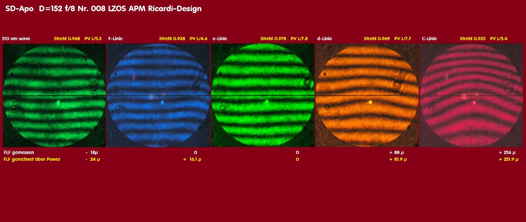

Dear Markus and Massimo,
this SD-APO 152/1216 Lens LZOS APM Design M. Ricardi is better than the design results, but
not as good as the SkyWatcher Equinox: This is a matter of the back fokal distance of red = 656.3 nm wave.
It's the longest one, but at night you just see about 2% of this color.
At first my interferogramms: This shows red with the longest back focal lenght, but at night you just see about 2%.
The Strehl value for F-line and C-line is much better than in Massimos drawing, next picture:

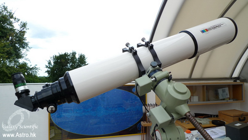

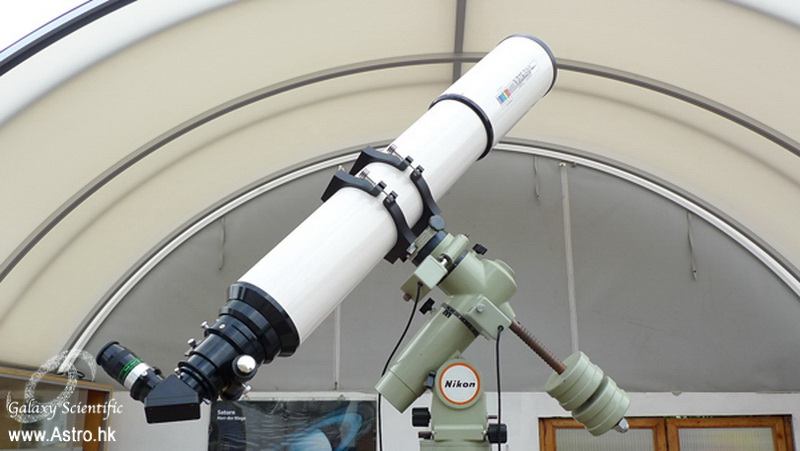

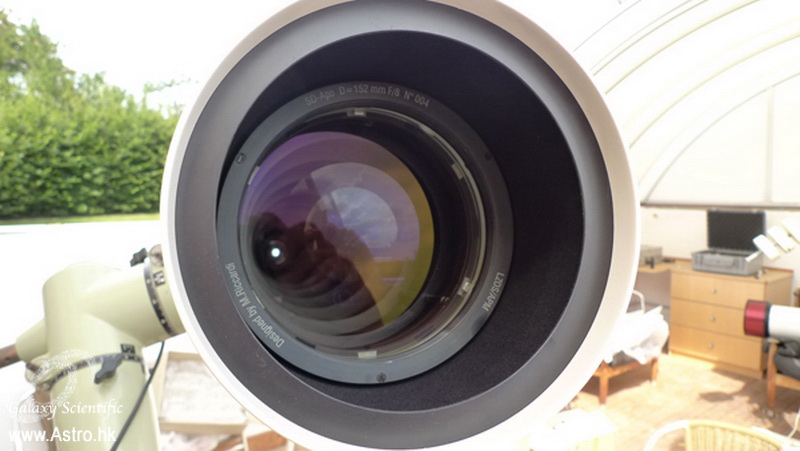

照片
Riccardi 152-5.jpg (123.95 KiB) 被瀏覽 13678 次
Riccardi 152-4.jpg (104.87 KiB) 被瀏覽 13678 次
Riccardi 152-2.jpg (107.32 KiB) 被瀏覽 13678 次
Riccardi 152-1.jpg (112.9 KiB) 被瀏覽 13678 次

文章社長 » 2013-01-15, 12:40

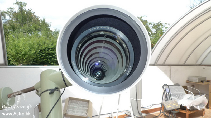

國外的測試報告,光學表現評價極高的,唯一的意見是那些筒內的光欄,這點APM的老闆Markus Ludes很勞氣。的確,鑑定一台望遠鏡不是用"Look at",而應該用"Look through"的,所以大家都對APM-LZOS鏡頭內那些刮痕、玻璃氣泡等習以為常,我收到的小至80mm APO、大至304APO,包裝物料可以是報紙、綿胎、發泡膠混在一起,甚至會看到鏡頭蓋上有一個鞋印,不會像日系望遠鏡那樣重視外包裝。
Quote :
Again I see that reviewers missing scill in telescope design L
How well and perfect a scope is baffled, you never see from front, only from rear.
How well a scope is baffled you do NOT see when you look into the focuser, you see only if your eye or camera is positioned
At the focuse and not 100 mm in front. If your eye go to much on front of the focuse you can see of course not perfect baffle, because baffles are always optimized for the focuse plane
