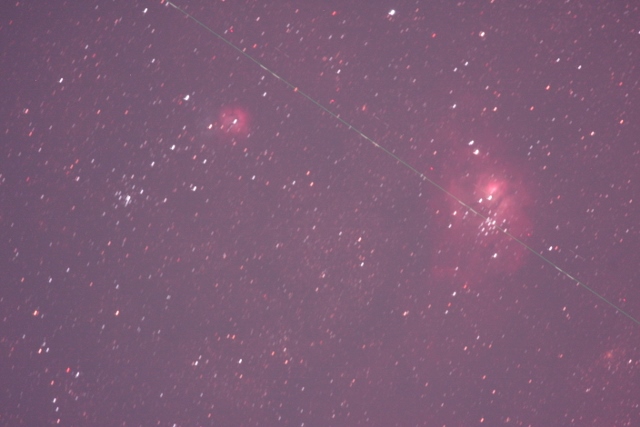

400mm, 5mins exposure 出現拉缐
IMG_6175 (640x427).jpg (130.77 KiB) 被瀏覽 36989 次

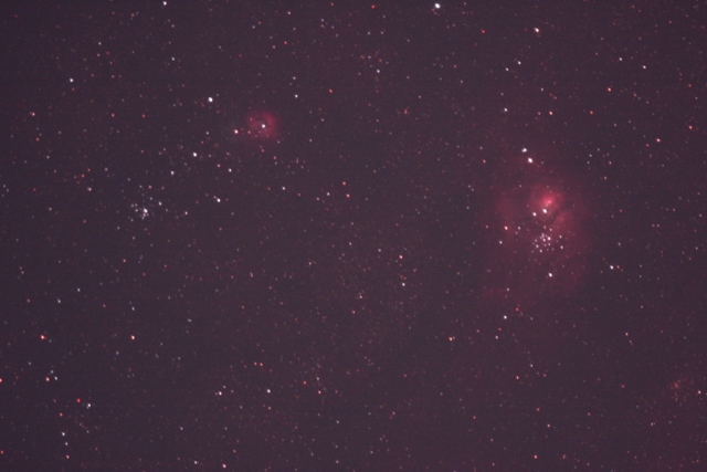

改2 mins exposure, ISO500
改2 mins exposure, ISO500, 對焦調錯
IMG_6176 (640x427).jpg (124.6 KiB) 被瀏覽 36989 次
2 mins exposure, ISO500, 2 hours after, 天體最後位置
IMG_6235 (640x427).jpg (127.84 KiB) 被瀏覽 36989 次
請教 5mins exposure 出現拉缐, 天體位置 拍攝中改變是甚麽問題和改善,
第一次玩, 仲有改善 :D

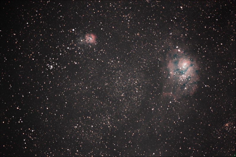

stacking photos: 2mins x 48, ISO 500, Canon 40D modify + 100-400 @ 400mm.
M8 and M20 after 1hour 36mins exposure
M20 updated 07222016 (800x533).jpg (279.61 KiB) 被瀏覽 36975 次

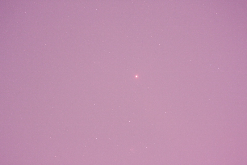

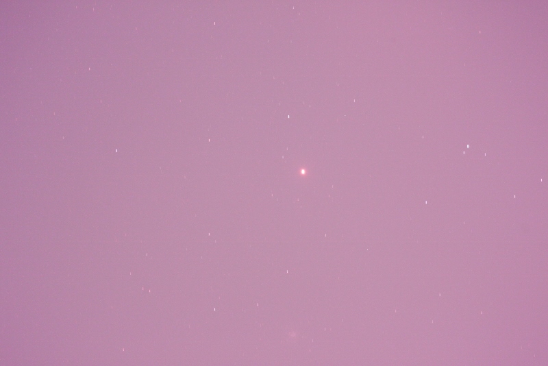

Thanks Willis. I did take your suggestion for 3 mins exposure last light at Clear Water Bay. But the weather was too bad. I could not see Polaris for most of the night with heavy smoke. Without Polaris, it was super challenge to align the stars. LVI II X and Y axis were running crazy, and sometime " star lost" because of the bad atmosphere. 40D view finder had a star but LCD found nothing.
Antares 3 mins A
IMG_6312 (800x534).jpg (146.28 KiB) 被瀏覽 36883 次
Antares 3 mins B
IMG_6310 (800x534).jpg (146.8 KiB) 被瀏覽 36883 次
When using LVI II, the star in the x and y offset screen was always not at the center for all the time, may I know how to correct it? First I align the object to my camera and then turned the LVI to find a guide star. But the guide star was not always in the center. I think I should do a "correct" calibration once when the sky is clear again. I did find an interesting situation, LVI control panel in last night was in "wait" for a long time after I stop guiding. I needed to turn off the power.
Do you have any suggestion for collect star alignment when Polaris is not available? :(

若在天氣太熱或不斷有雲層掠過造成干擾,LVI II有時是失靈的。前者只要在導星狀態便沒事,拍轉目標時便要拔電源三兩分鐘再來。
所以我個人也用LVI I,簡單些。
從你的相片看,相機震動、導星鏡跟相機之間有連接的剛性問題,比極軸問題更大。
你要確定是天氣讓你找不到極星,或是自己瞄錯方位? 若是前者,用極軸鏡也找不到極星,坦白說,那種天氣下其實還是不用花時間拍了。

拉缐我諗電線冇固定,而引起拉缐, 我下次繋好電線

kitkit 寫:stacking photos: 2mins x 48, ISO 500, Canon 40D modify + 100-400 @ 400mm.
這張有些潛力,唯一有失焦,這個在拍攝時的確要注意一點,否則事後沒法補救。

有時無可避免要推至最高ISO,每次拍張5秒10秒以確認構圖及擺位,就算我遙控西藏天文台也是。
對焦也要用類似方法,但彈性大些,例如用魚骨板,對亮星人眼決定,或每次拍1-3秒對比,若是鏡頭的話,對好後用膠紙貼好以免走焦。若用短焦鏡頭的話,有時不用魚骨板直接用星點決定其實分別也不大。
