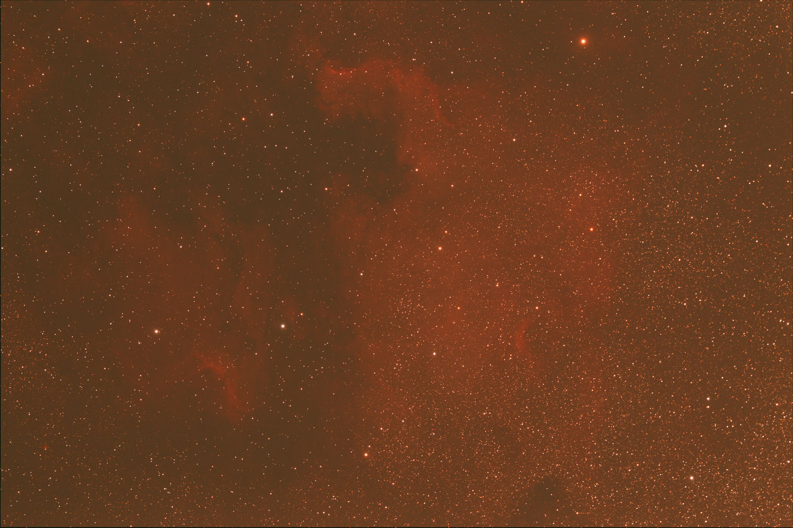

Last night I made a right decision to go to PTC & captured the North American Nebula. To me it is just a practice & I used two flatteners to image the North American Nebula, namely WO FLT (zero power) & the APM Riccardi Super ED reducer (0.75X). After finished the imaging with Riccardi reducer, clouds covered!!! I only got one frame of North American Nebula with the FLT flattener. So I just post the resized raw image.
For the combo of APM-TMB 105/650 & APM Riccardi Super ED 0.75X reducer
APM-TMB 105/650, APM Riccardi Super ED reducer, P2, HEQ5Pro, LVI II, 5DII (Astrodon Modified)
ISO 1600, 16 x @2mins, Dark Frame, Flat Field
DSS, PS

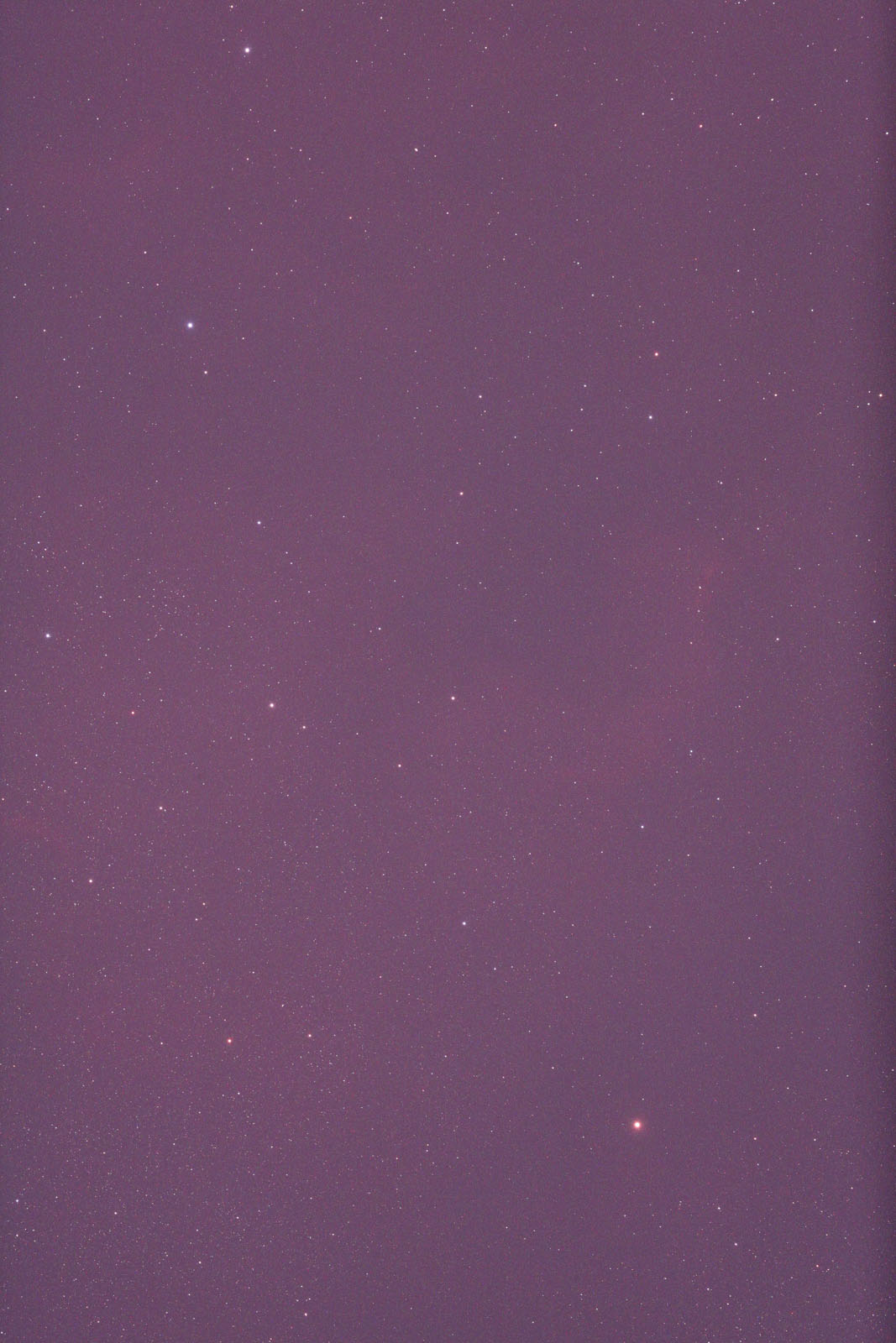

For the combo of APM-TMB 105/650, WO FLT flattener
APM-TMB 105/650, WO FLT flattener, P2, HEQ5Pro, LVI II, 5DII (Astrodon Modified)
Since I only got 1 frame, so just resized unprocessed photo
APM-TMB 105/650, FLT, resized unprocessed raw
APM-TMB 105/650, Riccardi 0.75X
North American Nebula_105 650_Riccardi_Dark_Flat_PS_1600.jpg (305.25 KiB) 被瀏覽 12742 次

Willis,
昨晚好玩嘛,聽聞跟其他人交流得很開心! :mrgreen:
想問一下:
1. Reducer 那一張左上角是否有少許变形
2. 另外黑邊是否因失光導至?(一般失光是圓形,不是長方形)
你都知我弱,想了解一下! 虛心一問,不是玩嘢!:mrgreen:

funoooo 寫:Willis,
想問一下:
另 Willis 有沒有試過 LVI divering 功能於 5DII?
1. There is a bit distortion at the upper left corner, I guess it is due to imperfect of the adapters or orthogonality of camera's CMOS.
2. I notice this problem for sometimes when I use my 105/650 in birding. I discussed this with 社長 and benben88 before. I found the problem is that some of the light is blocked by Canon's body. I tried to use Nikon's full frame camera, D700. There is no such edge vignetting. Basically the shape of the light cone of Riccardi is flatter and therefore blocked by Canon's body. If one use CCD camera, there is no such blocking. u can reference to 社長's 105/650 + 16803 photos. No vignetting occurred.
Anyway, this is my first time to apply flat field. And I learned it's functionality.
PS* It test Dithering next time.
