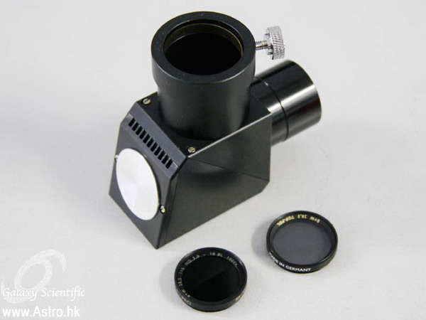

Herschel Wedge太陽菱鏡被認為是觀看白光太陽最安全及優質的方法之一。其原理是置於望遠鏡後,以一片楔型菱鏡把入射光及熱量95%折射,只讓5%反射至目鏡端,並配合2片ND3(減光1000倍)及偏光鏡進一步減光,偏光鏡的特點是可轉動目鏡以因應倍率調節舒適亮度,或攝影時適合的曝光時間。
與現時常用的鏡前減光膜相比,太陽菱鏡的造價較貴,但影像質量最高,而且可靠耐用得多。
警告:Herschel Wedge 必須配合ND3及Polarizeer / Green Continuum等濾鏡使用,以及嚴格依從以下次序
- 望遠鏡 > Herschel wedge > ND3.0濾鏡 > 偏光濾鏡 > 目鏡 或 相機
- 望遠鏡 > Herschel wedge > ND3.0濾鏡 > Green Continuum 濾鏡 > 目鏡 或 相機
若僅作高倍拍攝而非目視,可以按曝光需要而略去偏光濾鏡或Green Continuum
以1.25” 規格計,適用於2500mm焦距望遠鏡或以下,若主鏡焦距更長的,可選用略貴的Lunt Solar System的2” 型號 (見最下圖,香港現貨供應,但要注意望遠鏡後焦點是否足夠)。
星河科研社已引入首批小量,下週抵港:
套件包括:
Lunt / APM 1.25”太陽菱鏡
1.25” ND3濾鏡、偏光鏡
手提鋁箱
全套港幣2230元

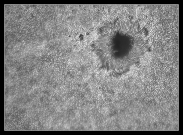

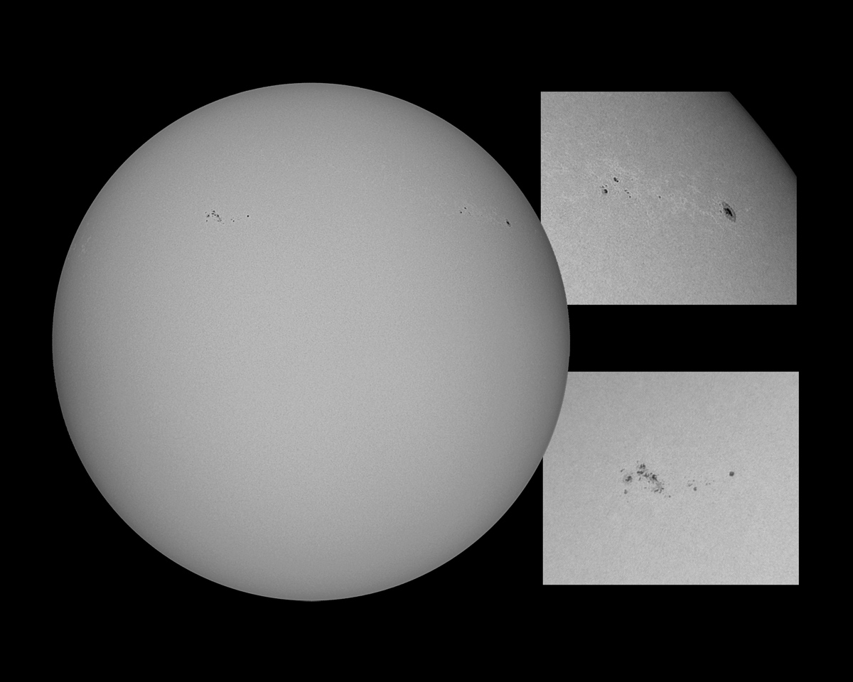

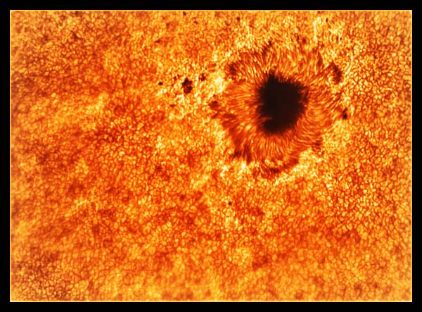

Is it both 4.jpg & 5.jpg are taken with the Herschel Wedge?
Re: 德國 APM 1.25”Herschel Wedge 太陽菱鏡
文章David » 2010-02-27, 10:15
I have never taken any pictures with Herschel Wedge. The visual impression is more like 3.jpg rather than 4 and 5. It may not seem like a big difference from ordinary solar film, but once you've seen the real thing, you will not use those solar film again if image quality is what you go for.
I believe 4 and 5 were taken with very large aperture scopes under excellent seeing.
May be I can try to take a full disk picture using APM 80/480, with Herschel Wedge and Baader Solar Film separately. Need good weather... :x

David 寫:I have never taken any pictures with Herschel Wedge. The visual impression is more like 3.jpg rather than 4 and 5. It may not seem like a big difference from ordinary solar film, but once you've seen the real thing, you will not use those solar film again if image quality is what you go for.
I stained 4.jpg into Ha color like. The detail doesn't look like Ha image. But the texture is quite unique. I wonder if Equinox 120 and Herschel wedge can achieve such quality or not.
文章社長 » 2010-02-28, 11:22
willis 寫:Is it both 4.jpg & 5.jpg are taken with the Herschel Wedge?
對,都是1.25" Herschel Wedge的,但Markus說忘了拍攝數據 :?
不過邏輯上看,Herschel Wedge本身只是一個光學平面,所以這些圖片主要用來說明Herschel Wedge對影像質量 "do no harm" 就夠了。
據我經驗,要用100mm口徑或以上才可拍到這樣的細節,所以你的Equinox 120應沒問題。後焦點不用太担心,因為和1.25"天頂無分別(但FS60可能不太夠),效果好一點用DMK拍會好些,若用單反則後焦點長些,效果也弱些。
我的經驗是,用老款Herschel Wedge在APM-TMB 105/650上目視看太陽,那些米粒組織、臨邊昏暗等層次感很好,太陽呈立體感的,相對於Baader Film的層次感會好。
另外拍攝時也可以考慮用一片好的綠色濾鏡取代那片偏光鏡(Baader的叫Green Continuum,非常窄頻的,但沒有1.25"),因為折射鏡的綠光修正度最好。
