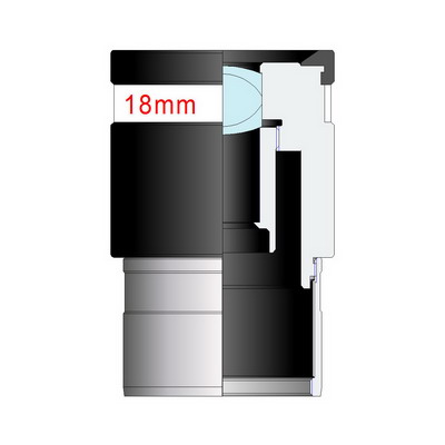

18及21mm型號規格:
F18mm
1, Diameter of field stop 10.0mm
2, FOV 30°
3, Eyerelief 15.0mm
4, Total length ca. 55mm

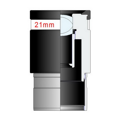

F21mm
1, Diameter of field stop 11.8mm
2, FOV 30°
3, Eyerelief 17.5mm
4, Total length ca. 60mm
