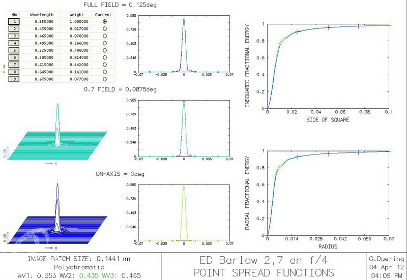

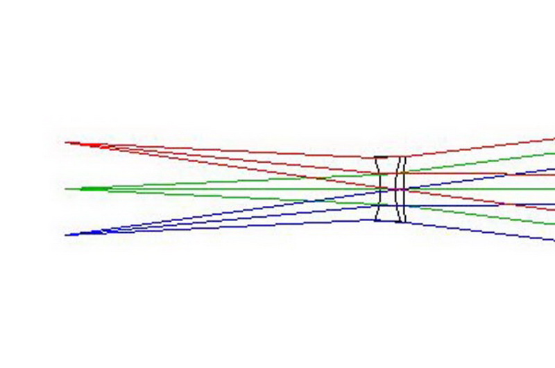

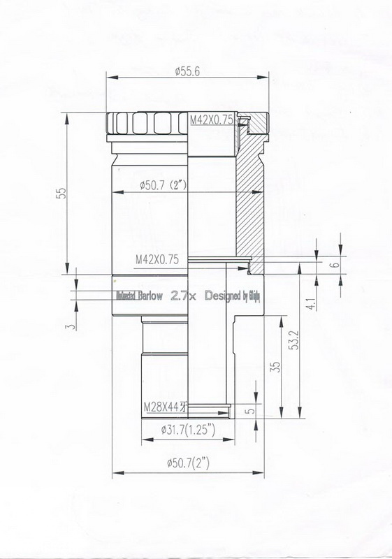

APM-comacorrected 1.25“ EB Barlow 2.7 x
Designed by Gerd Düring/Germany
Due Forum discussions pushed, Gerd Düring in Germany designed us a new improved coma corrected ED Barlowlens, optimized for parabolic mirrors with f-ration F/4. The
Barlow use as ED-element the chinese ED glas FK61 ( similar to Ohara FPL 51), the lenses are soft cemented and applied on both sides with a broadband multicoating with over 99% transmission for the wavelength from 400 nanometers to 700 nanometers. The optimum backfocuse is 105 mm from center last lens. The focal length of the barlow is – 62.9 mm. The clear aperture of the barlow is 22 mm.
The Barlow offers with its 22 mm aperture in secondary focuse with 100% illumination a photo-visuell field of view of over 30 mm diameter at the 105 mm backfocuse. The 2 part adapter is photo-visual optimized, visual with optimum backfocuse of 105 mm with a new APM-Deluxe-Centerinclamp, this top Deluxe adapter , 55 mm long, can be unscrewed , then you have a photographic T2 Thread ( M42x0.75) for use with DSLZ and T2 ring.
First images show that APS-C works perfectly.

不知道理解对不对:

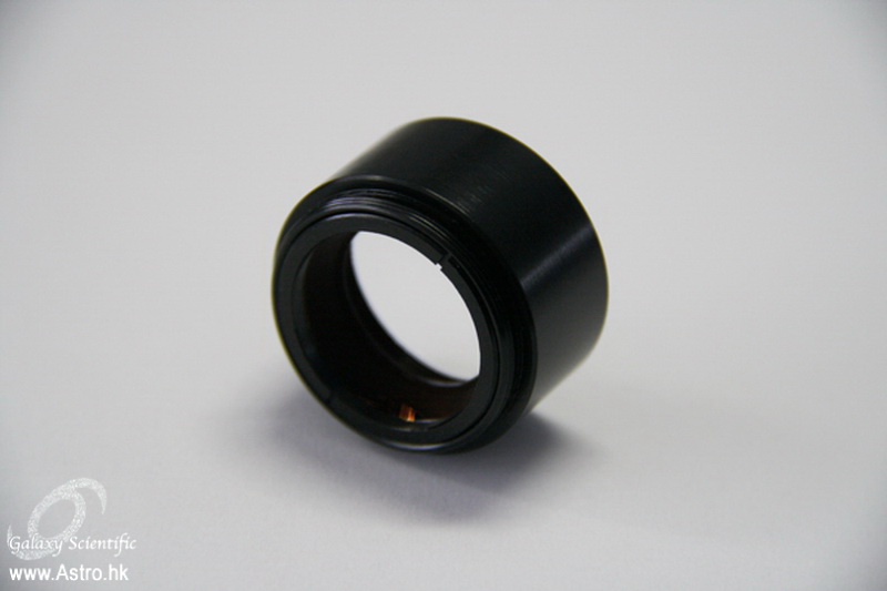

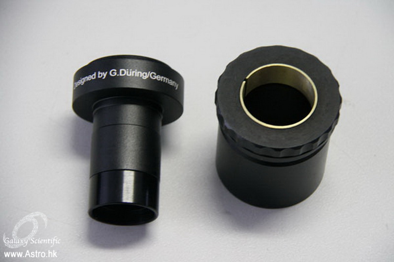

1. 2寸接环是用来目视做目镜的adaptor的。
2. 2寸接环可以扭下来,然后相机T2接口直接接1.25寸部分的T2口就可以了,这时候后截距是105mm
3. 看图2寸接环上还有个M42*0.75环,那是干嘛用的?

1. Yes
2. 扭下來便可以接T Ring
3. 沒有的,只是手擰環來鎖緊目鏡
