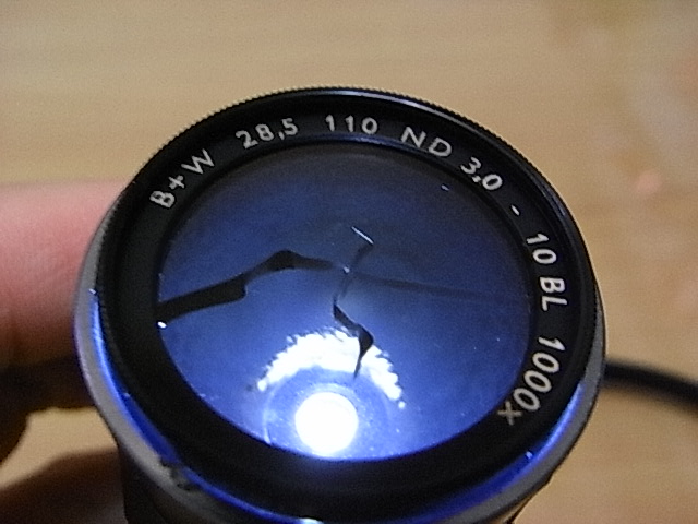

文章willis » 2010-06-07, 21:29
My ND3 has gone! Today I found out the reason that why there are unknown marks on my Herschel Wedge images since last solar observation in 25/5/2010. The marks on the image would not rotate with the camera. And I found there was no dust on the CCD, the filters and the Herschel Wedge. There were no visible damages in any optical parts. However, the problem was more pronounce in high magnification. Today I detach the ND3 and inspected it under the sun. Gosh! There were cracks on the ND3. I remembered that last time I reversed the order of assembling the Herschel Wedge. The ordering was:
Objective side, ND3, Herschel Wedge, Polarizer or Green continuum, Eyepiece side
This ordering term out to be wrong. My ND3 cannot stand for the heat energy and micro cracks formed! I need to buy a new one now! Dear Herschel Wedge users, don’t repeat my silly fault. The correct ordering should be:
Objective side, Herschel Wedge, ND3, Polarizer or Green continuum, Eyepiece side
社長, do you have stock? Please reserve one for me. Thanks!
Poor Willis
Cracks under strong light
No visible damage under normal light
Unknown marks on the image
120ED0003 14-39-30_green.jpg (234.22 KiB) 被瀏覽 63510 次

Willis,小弟中學時用日本的 "Sun" 濾鏡看太陽,當時沒有Herschel wedge的,那片小小的濾鏡很接近焦點,承受了所有熱量及光量,在連續觀看太陽5分鐘後,就在我的目鏡前爆烈,當看到一道光線從裂縫滲進來時我才知道出事,馬上移開眼睛避禍。當時沒有保留那片濾鏡作紀念品,你的能否讓給我做教材? :mrgreen:
你應興幸是自己親身發現這個問題,否則在學生或女兒觀看途中出事就不妙了 :?
現時有ND3存貨,因為德國這些小濾鏡要停產了,除你以外,我以後不能獨立再賣庫存了,因為手上的都跟Herschel Wedge數量配套的,另外你要的小配重也帶了。

Hi Willis, sorry to hear that. :(
I took it to see the Sun yesterday. It's a very nice product. But be careful of the order of stacking up the lens and filters.
