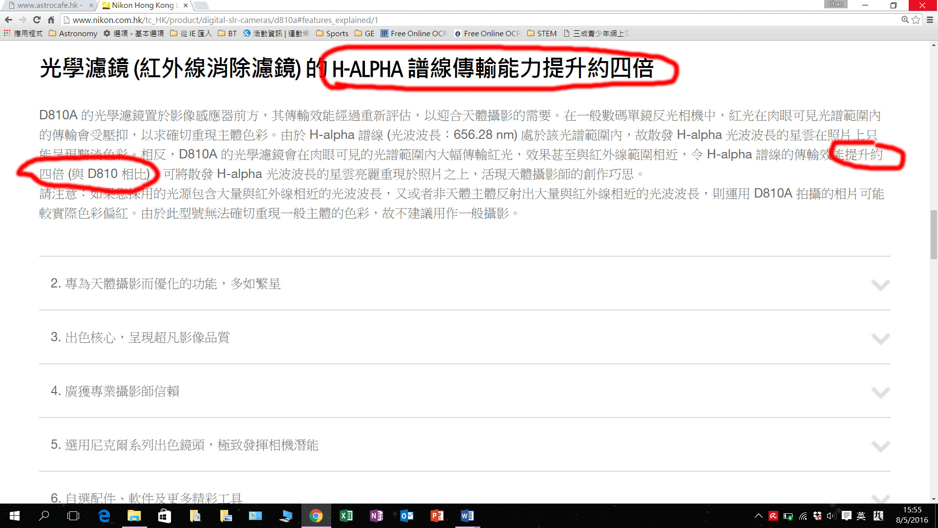

Cannot find the transmission cure in Nikon website. But found this description. The D810A has 4 times the Ha transmission in comparison with D810.

我還是比較有興趣看看際實數字,為何作為天文機,這麼重要的數據都這麼神秘? :roll:
