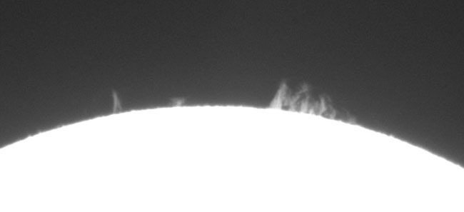

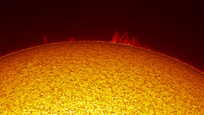

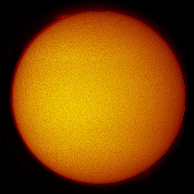

這是兩張相片的拼圖,光度和反差非常平均,接駁區域不太明顯。
LS50F的日珥影像

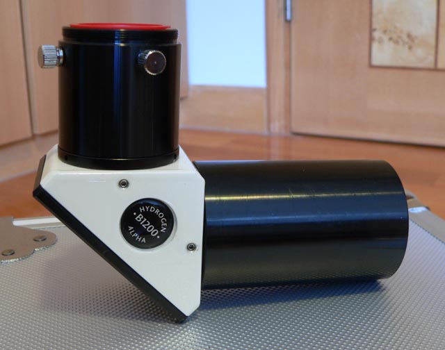

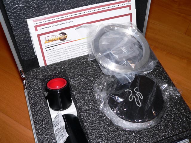

補貼一些器材的圖片:
阻隔濾鏡B1200
LS50F和B1200。(圖中的接環要另外購買)

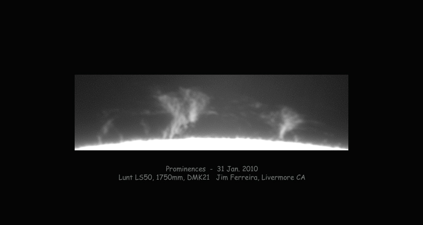

可見一片小小的Lunt LS50F日珥濾鏡配映美精DMK21相機,已可拍得這樣的日珥照片 8-)

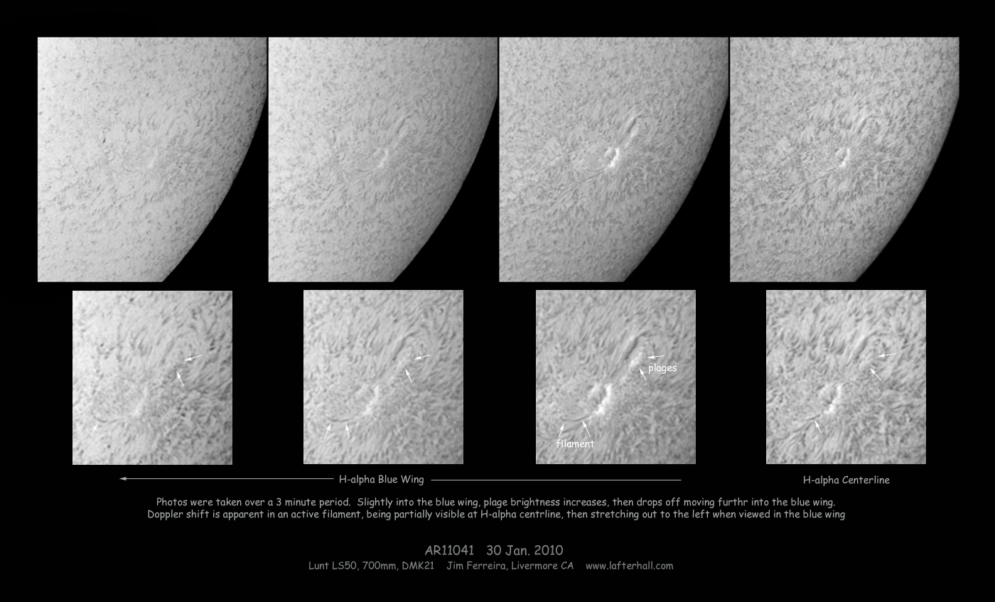

Here are 4 images of AR11041 with the filter tuned progressively into the blue wing. Changes in a small, active filament (arrowed) can be seen in the 3 minute progression into the blue wing. Changes in brightness of plages can also be seen.
Though the LS50 be little, it be mighty....IMHO.
Having some kind of good time now!
Jim

Shot with a Lunt LS50F filter fitted to a 4 inch ED refractor, DMK21 camera.
Jim
Livermore CA
