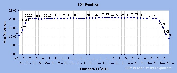

Dear all,
Just setup and is now testing Ethernt version of Sky Quality Meter and its paid version SQM Reader pro software to record continuous data of sky darkness.
In comparison with other meters measuring relative sky brightness, this meter can convert the sky darkness in terms of sky magnitude/sq arcsec (or near eyesight limiting magnitude).
This may be useful to compare darkness in different observation sites with absolute data rather than making relative comparisons.
A sample graph taken recently is provided here.
Raymond Tse
SQM data graph
20120910pm-20120911am SQMGraph.jpg (50.11 KiB) 被瀏覽 34378 次

The graph was just a test but not scientific. The main purpose is to check the cut off point where imaging is worth trying and no longer necessary. For this month, the beginning imaging time should be 7.15 pm whereas imaging after 5.15 am is ineffective due to increasing sky brightness. This may be useful for remote imaging where you cannot assess the sky darkness by eyes at all.

Raymond TSE 寫:The graph was just a test but not scientific. The main purpose is to check the cut off point where imaging is worth trying and no longer necessary. For this month, the beginning imaging time should be 7.15 pm whereas imaging after 5.15 am is ineffective due to increasing sky brightness. This may be useful for remote imaging where you cannot assess the sky darkness by eyes at all.
以香港的大氣透明度受不同風向影響甚大的情況下,我很同意加裝SQM會很有用。

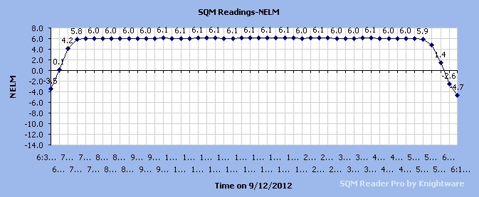

Another unscientific graph last night of eyesight limiting magnitude before applying any offset.
