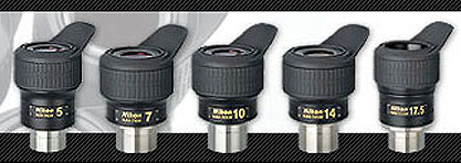

我的好友,德國APM負責人Markus Ludes對目視觀測是很有一手的,也是鑑定各類望遠鏡及目鏡的專家。 viewtopic.php?f=13&t=85 最近代理了日本Nikon的天文目鏡,表現得很興奮,我問他一個問題,就是跟 TMB Supermonocentric 目鏡在月面行星上的表現,當然心底裡是有答案的。
引述電郵內容如下,也對各同好有一定參考價值:
yes 8 lenses with many airspaces always sharper the the worldbest planetary design with 3 cemented lenses :lol: (這句他開玩笑)
what I find myself : old test Zeiss Ortho against Radian. Zeiss is sharper and has better contrast , no question , if you looking as a real planetary observer for finest details the zeiss is the way to go.
But if you just occassionaly watch the Planets , the Radin offer a more relaxed view due the larger FOV and better eyerelief, so non experienced observers may prefer the Radian
same is as mono and NIKON
btw the old NIKON 7 mm 72° ( spotting scope eyepiece 60x775x) has better contrast less straylight then the new astro eyepiece
so when I observe Planets and I have time and I am relaxed, then I use Monos , but if I have not much time and just want to look to Planets then I use Naglers, Ethos and and others
Markus
