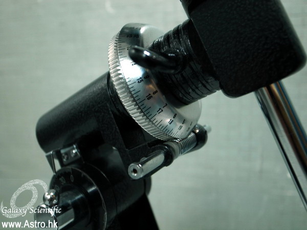

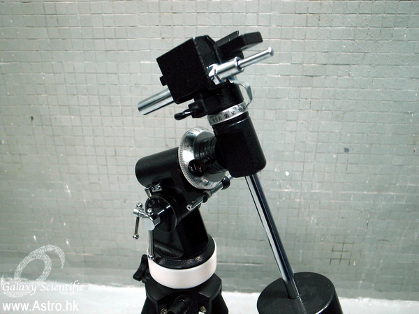

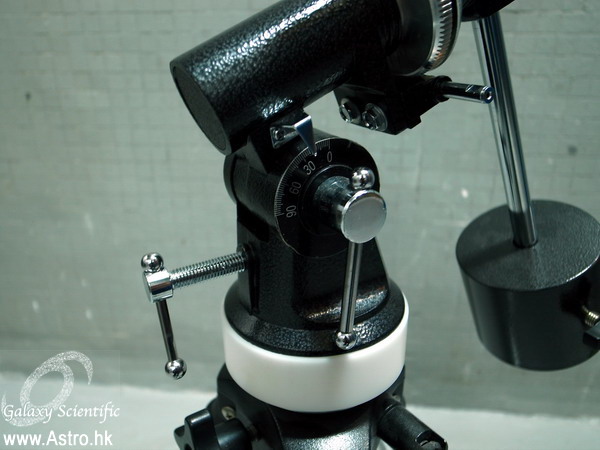

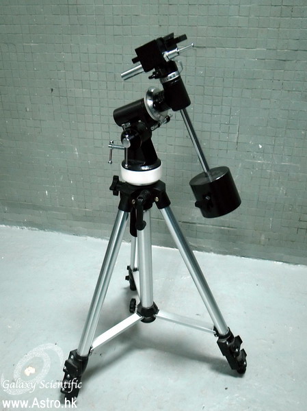

以下是未裝摩打及外置極軸鏡的EQ1,但用了一片加固墊接駁在相機三腳架上。稍後發報其他照片:

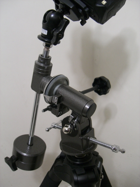

真巧. 近日把手上一台EQ1改造. 把 declination axis 這部分拆了, 裝上了 QHD-51Q 雲台. 未連重錘, 淨重1.2kg. 51Q可負蛓 4kg.
改造的原因, 一是便攜, 二是EQ1的雲台本是直接用於抱箍, 不能接鳩尾板. 現在能接上 Nikon D700 及 85.4 了.

我昨天也有個衝動把EQ1的前端拿掉換個雲台轉接環,但後來才發現了一個可能性,或許我會放台APM 80/480上去,對某些表面亮度高的天體拍攝以大量短時間的盲跟曝光照,例如以ISO6400拍100張10秒的,以我在高美古實驗所見,有機會可以把整個馬頭天區的形態表現出來,當然這種方法是不可能跟疊加較少量長時間曝光的相比,但很有可塑性。

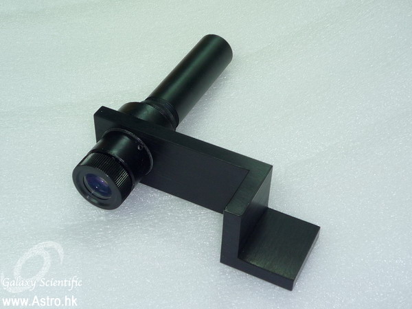

at the moment I will just use my self-designed external polar scope for the Paramount, see below, which is good for hours long planetary imaging with my 203 APO, but it should be ok for the EQ1 also. Let's see.....
Now I decided it's better not to use the standard camera adaptor, but attached an aluminum board to the mount which in turn connecting to the camera.
if our test is successful these several days, or better yet, let's understand the capability and limit of this setup, and then you can explore the full potential in Taiwan :P

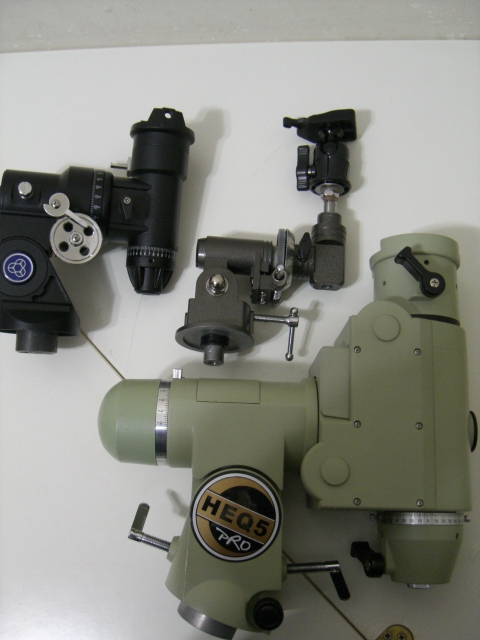

Thanks 社長. The GA4 with ED80 is pretty good, but not the story with a little finder. Most likely your precious recommedation will be value added.
For the modified EQ1, I will consider using with the 85mm/F1.4 and 10-20mm/F3.5 only, and heavily rely on the GA-4 set for the guiding.
Working on: 8x50 viewfinder + GA-4
Compare with HEQ5 Pro and JE100A
Closer look on modified EQ1
EQ1, QHD-51Q, D700, 85/1.4

Hi Horace, in my humble opinion, I guess you will likely experience flexture in your setup. Those ball heads won't work for astrophotograph. Also normal hand screws on tripod won't secure cameras stable enough, I use 杯頭縲絲 and fixed with 六角匙.
Well, I am too old to do manual guiding anymore, so either I take it easy and use a single axis motor for blind guide, or just go ahead with dual axis autoguide.
the right motor for EQ1 to do guided photograph is the deluxe version with hand control, the clock speed is generate by quartz, very stable over temp. The normal box shape motor is not stable, it's tunable and will varies over temp or time.
the white 賽鋼 disk is to reinforce the support of EQ1 on the tripod, which is also vital to pinpoint star photos.
just my 2 cents... :roll:
Re: Project EQ1 - 星野攝影行動
文章horace » 2010-03-10, 01:01
Thanks. Yes, I agree with you. The upper part of ball head section is the weakest area. You know, basically the EQ1 is too light to stand firm on the tripod. For the lower section, my tripod has a leg-pochelle stone-bag pouch which supposed to do much better. I will take your advice and see any improvement I can take. Talking about the blind guiding, I have a JE100A with single axis motor. But I think I am interested in some handmade works, just like your external polar scope.
