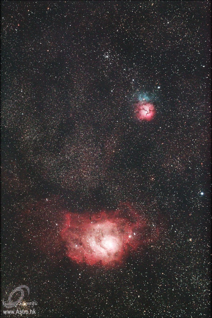

昨晚天氣稍為好轉,但雲層仍不時掠過,根本不可能長時間曝光,天亮時可見天蠍人馬及銀河,坦白說,在墾丁南端貓鼻頭的環境和香港西貢大浪東灣相若,拍些照片聊勝於無而已。
今早檢視照片,發現相機焦平面並不準直,照片右側特別是右下角星點拉線,現正研究問題所在,不知是否剛自製帶到台灣的接連環有問題 :shock:
儀器:APM-TMB 105/650 APO折射鏡、TMB 3.5"平場鏡、Sky Watcher HEQ5 Pro赤道儀
導星:第一代LVI導星器、9x50尋星鏡加2x巴羅透鏡、有效焦距350mm
相機:Canon 5D Mark II Modified、IDAS LPS P2 光害濾鏡、ISO 1600 ,疊加13張累計曝光7.5分鐘。
地點:台灣墾丁貓鼻頭
處理:無平場、無暗場(室外26攝氏度)、僅Photoshop curve stretching
M8 M20_resize.JPG (350.28 KiB) 被瀏覽 332182 次

This is my version. I processed it with ur original photo. In fact, if ur original photo is not good, I cannot bring the color & contrast out. Here are the steps in Photoshop:
1. Level: Tune the Level in individual RGB channels in such a way the three RGB histograms match. There are 3 buttons below the histogram. The general rule is that 3 channels should be similar in position and width. If the DSI is red dominating, red channel can be boosted more.
2. Curve: Different celestial objects got different curve shape. In this case I used 4 tags to shape the curve. The bright part of the curve is quite close to the original straight line. The dark part of the curve is suppressed in order to make a dark background.
3. Reduce Noise: Use navigator to magnify the image to about 300-400%. set the Tolerance to about 20-30 and use the Magic Wand Tool to point at a dark or noisy point. Apply strong noise reduction. Done!

I very much like how the M8 and M20 are framed in these pictures.
I actually like the top, original one better. It feels more natural and less 'digital' to me. But it is just a very personal opinion.
Re: 失敗的M8及M20
文章willis » 2010-03-17, 22:49
David, what about this one? This is less "digital".

没拍暗场,真是可惜。在大致相同的温度下,补拍一下暗场吧。
对焦精准,跟踪也不错(没看大图)。绝对属于成功的。
社长谦虚了。

社长,对于暗场,看来你有偏见,我要为暗场争取“名分”,哈哈。
我在零下20度都拍摄暗场,为什么呢?长时间曝光,相机的CCD肯定要发热的,热噪声一定会出现,还有一个不要忽略的随机噪声。
而为什么我们在导出的图中觉得噪声不明显呢?因为,你还没做星云的提升,在图片后期处理的时候,你要不断的拉曲线和色阶,其实,对原始图片是讯息的强制加强,这个时候,热噪声和随机噪声会变的明显了。
暗场的作用就是要消除热噪声和随机噪声,暗场越多,对随机噪声的压制越显著。这就是为什么要多拍暗场的道理。
说的不对,请其他大侠来指正。

簡單兄不要介意,我也是開玩笑而已,我也知道平場暗場很重要,實際上我的改版5D Mark II就是附有晶片溫度計,可以準確製作暗場的,以過去兩晚的情況計,晶片溫度要比室外高12度水平,一旦曝光完畢便即時下跌,開始曝光則上升得很快。
我是為這些照片,分別是ISO6400 x 2min、ISO1600 x 2min、ISO1600 x 6min都各拍了8張暗場的,其實最好多一點,但有點累,回來找方法把相機放進衡溫冰箱再製作暗場也可以,反正拍攝時晶片溫度都有紀綠了。

第一张微微偏绿一点,第二张对比度强了些。我喜欢第三张,如果叠加了暗场,会很精彩。
