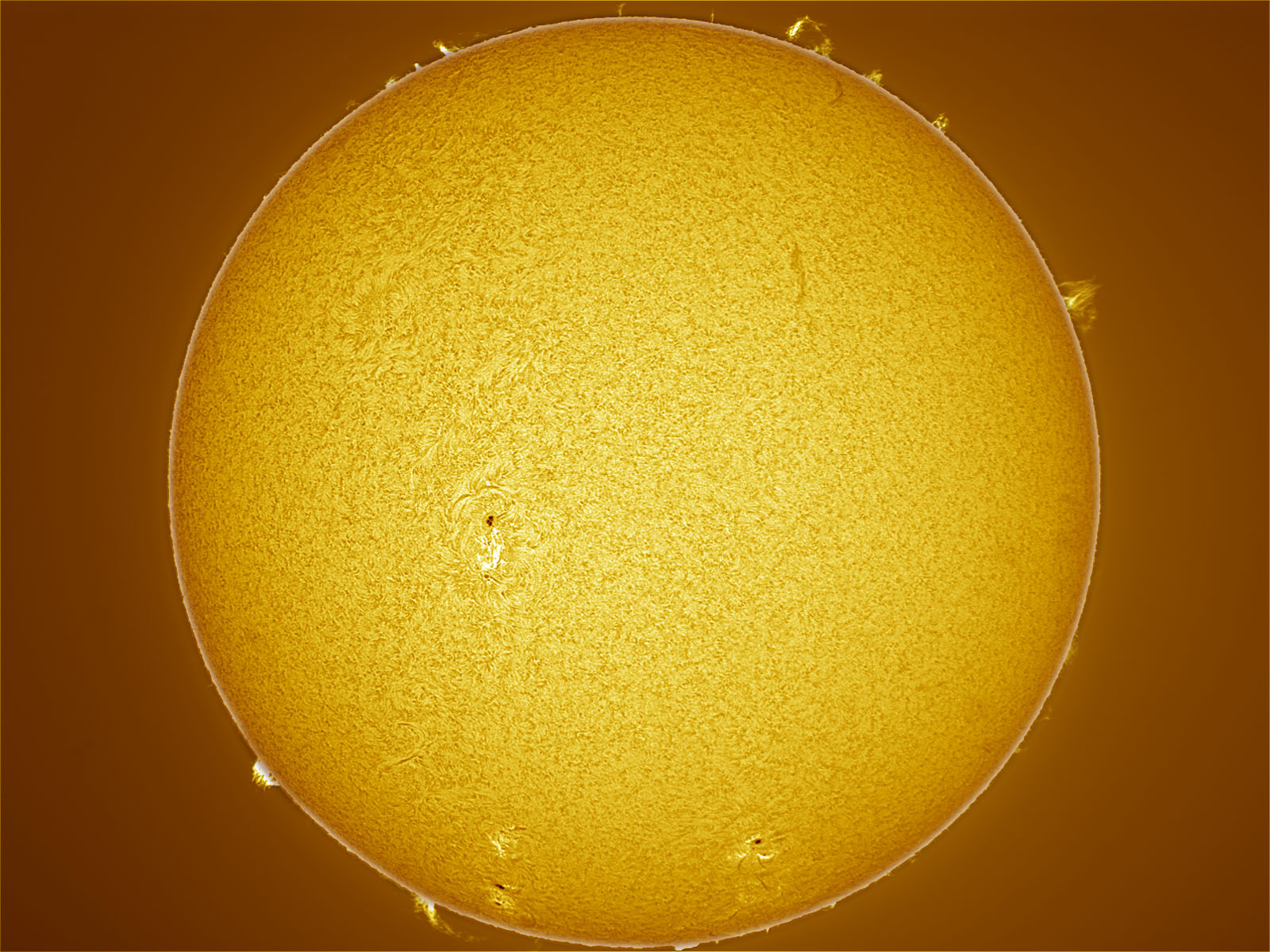

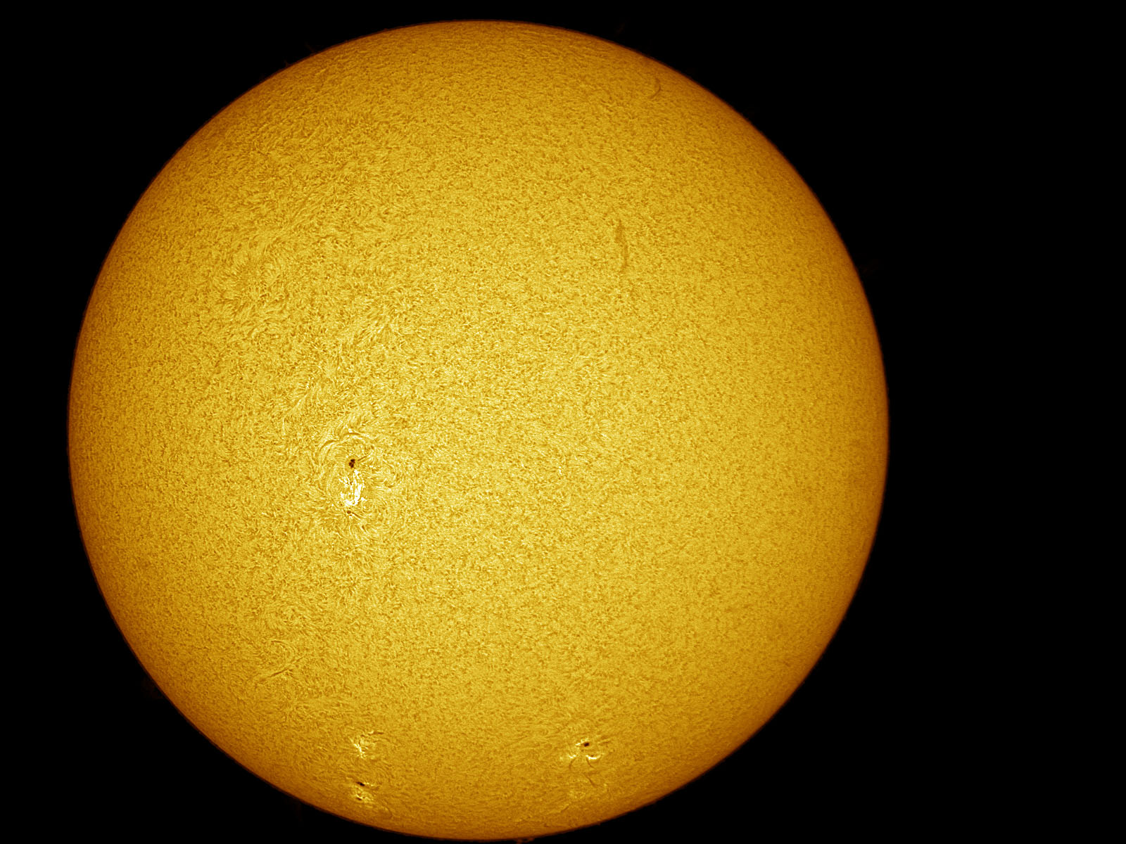

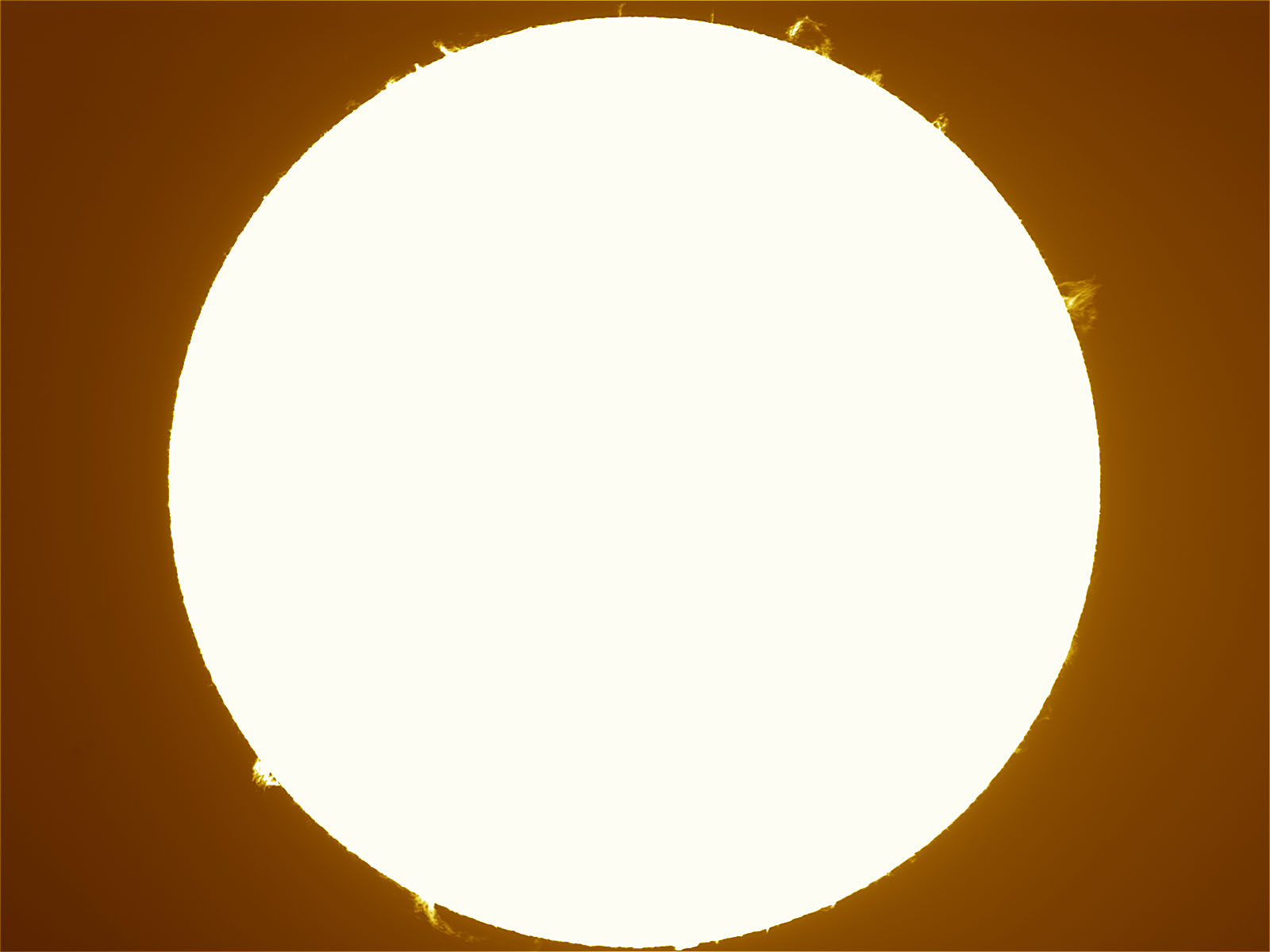

The new DMK 51 got nothing special in terms of operation, but a larger sensor size. I expect it can do a full solar disc imaging with LS80T (f=560mm) without drifting. Indeed, it does, see the attached photo. However, if you want to image the prominences and there are big prominences, one needs to rotate the cam so that the shorter side of the sensor can capture all the prominences. Of course if there are too many prominences around the sun, there is no way help. In practice, I never encounter such case before. So if one wants to make a composite photo of solar disc and prominence, do image the prominence first. Get the camera oriented properly during prominence imaging and then the solar disc afterward. This eases the post processing.

好像影像質量一般,細節有點粗,視寧度不太好? 好像我用DMK41+APM 80/480 + LS75F的效果還是好些 :roll:
今天地球處於遠日點,所以DMK51配LS80T的560mm是可以,但剛好而已,LS60T會空間大些。

No! The images were not taken in yesterday, but 28-6-2012 (look at the file's time stamp). As u mentioned that the eccentricity is 0.0167.
viewtopic.php?f=7&t=3137
After simple calculation, the visual size of sun disc at Perihelion will increase not more than about 3.3% compare with that of Aphelion. The DMK 51 is able to image full disc at Perihelion, although the margin is smaller.
About the images, I am still learning how to process solar images. :? I feel bad about the composite solar image. This is exceptionally bad! :cry:
