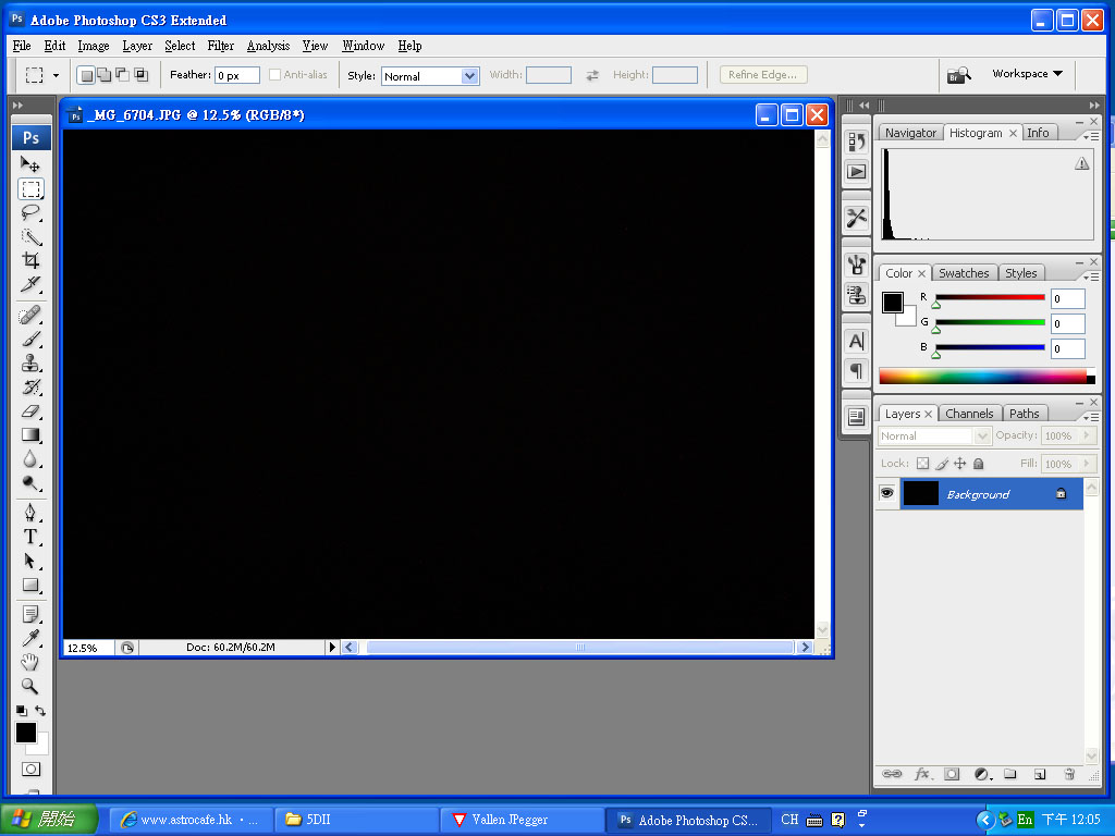

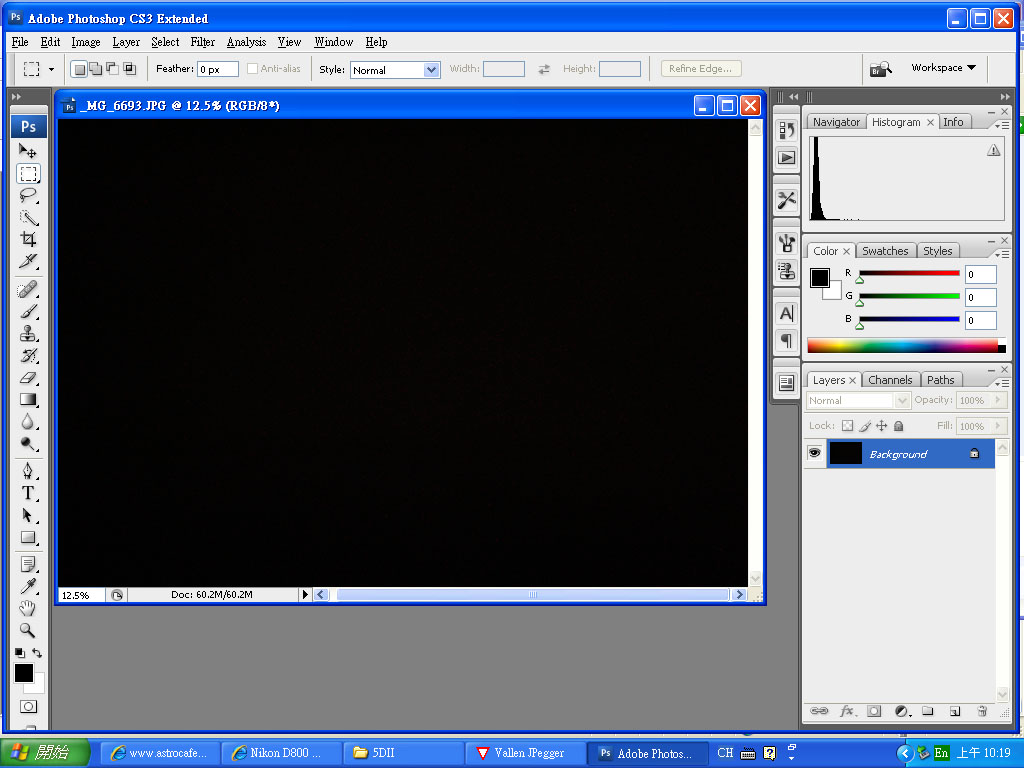

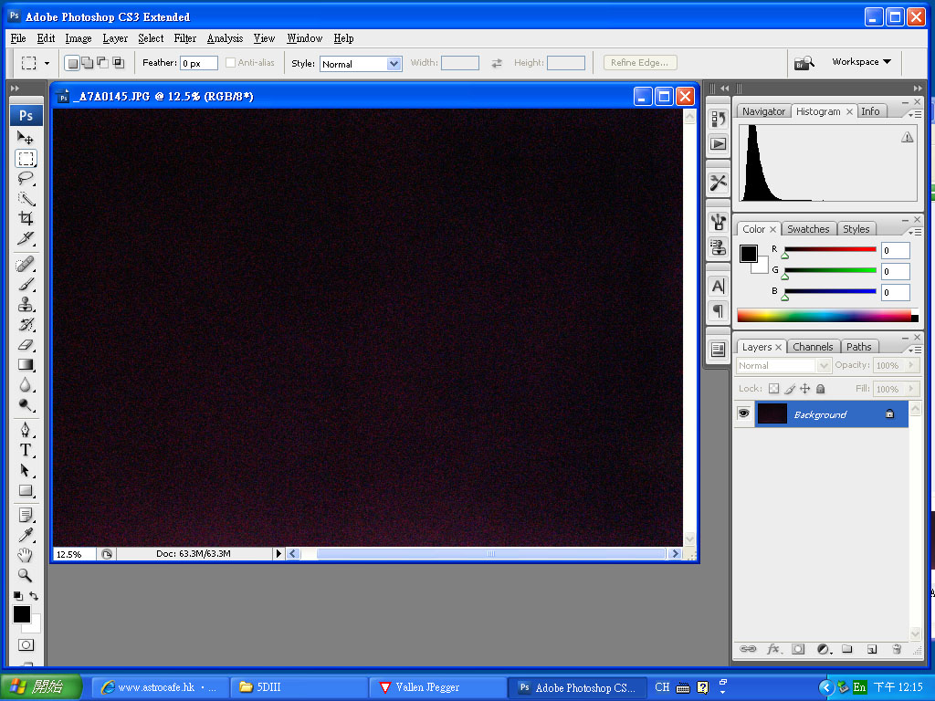

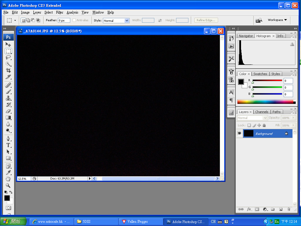

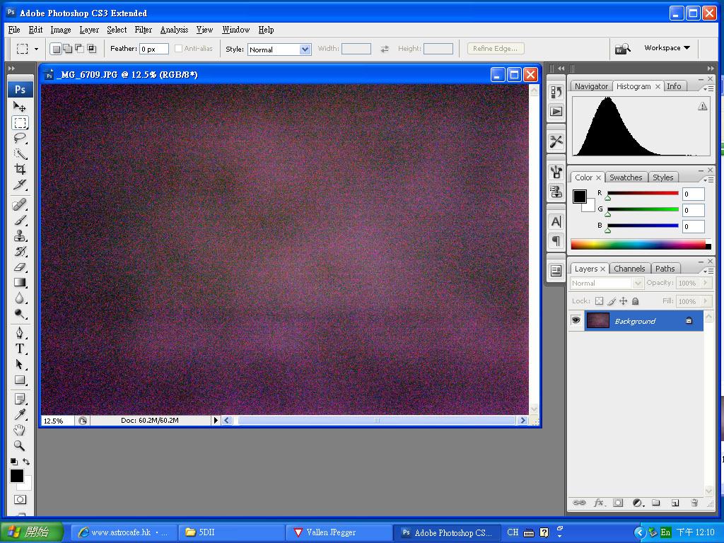

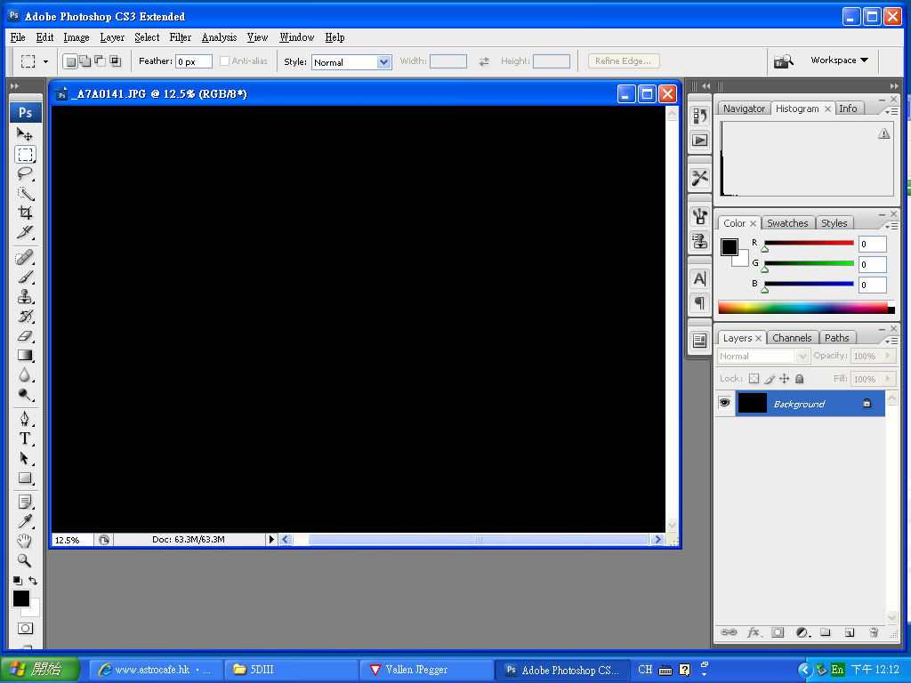

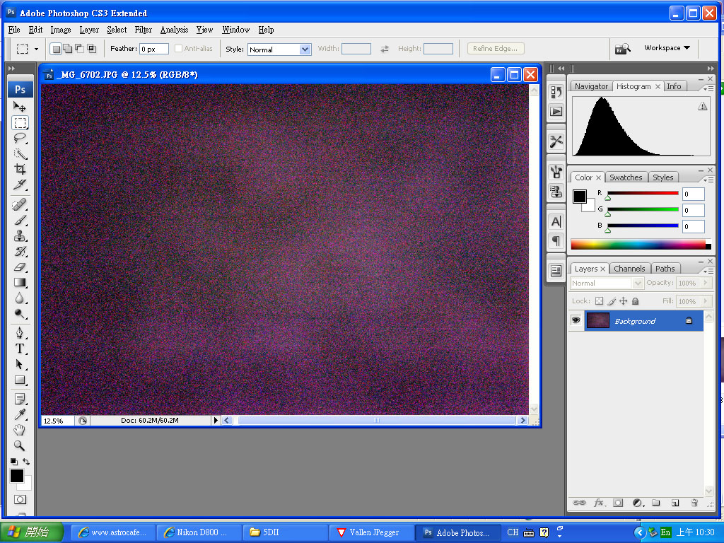

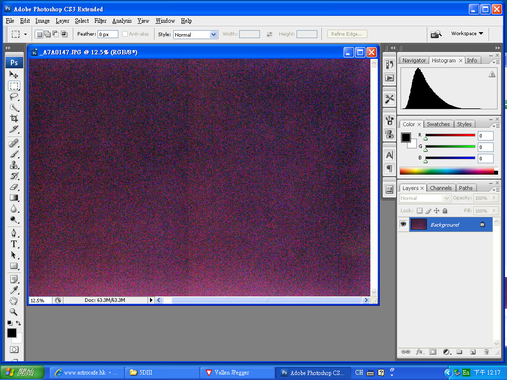

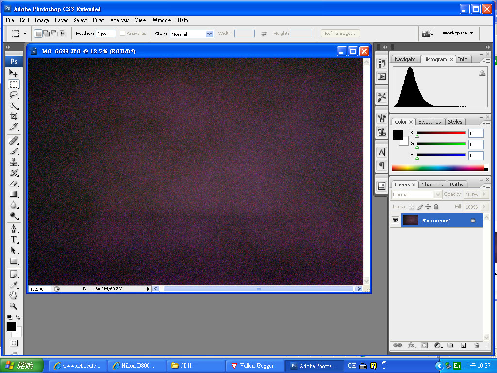

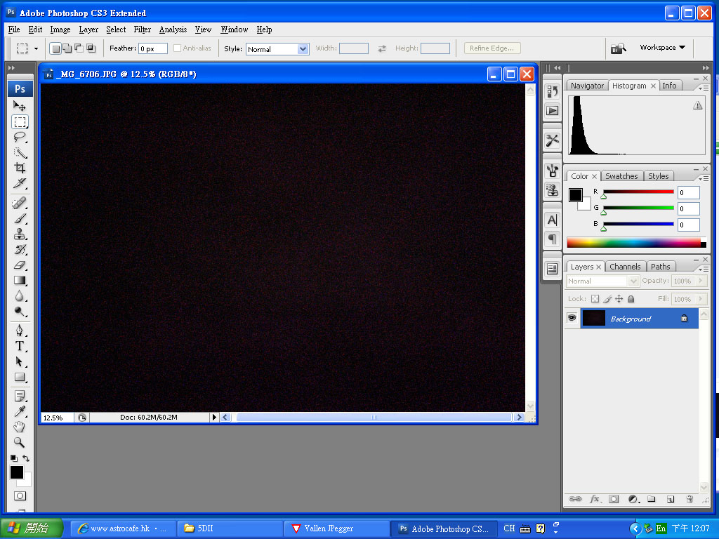

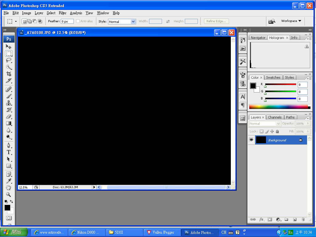

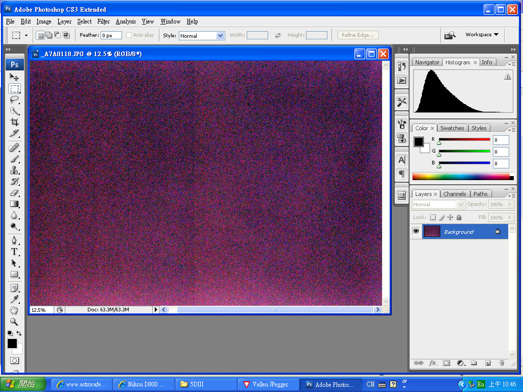

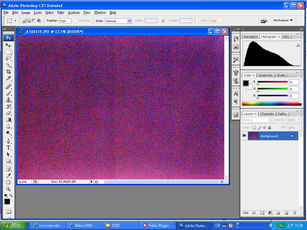

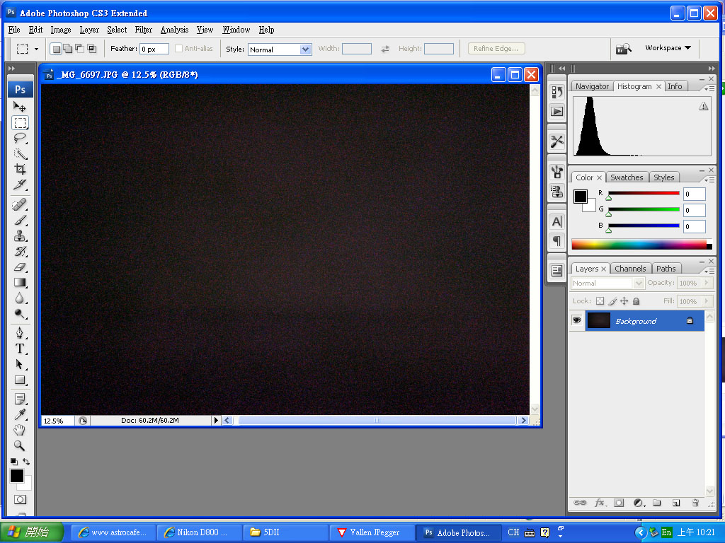

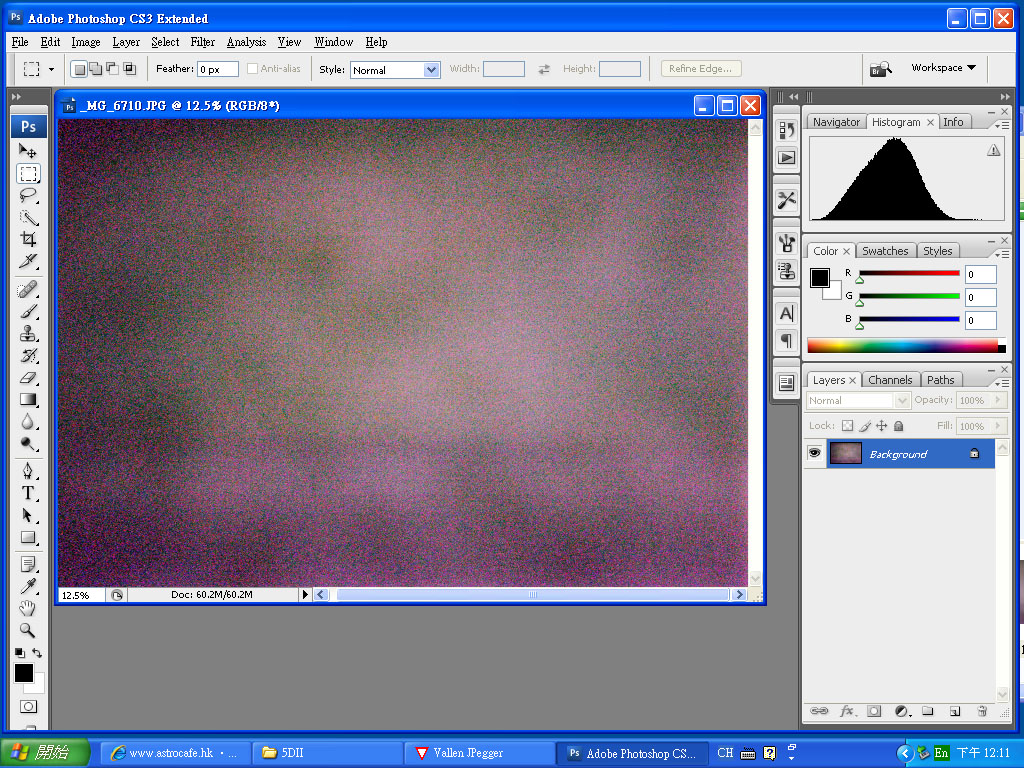

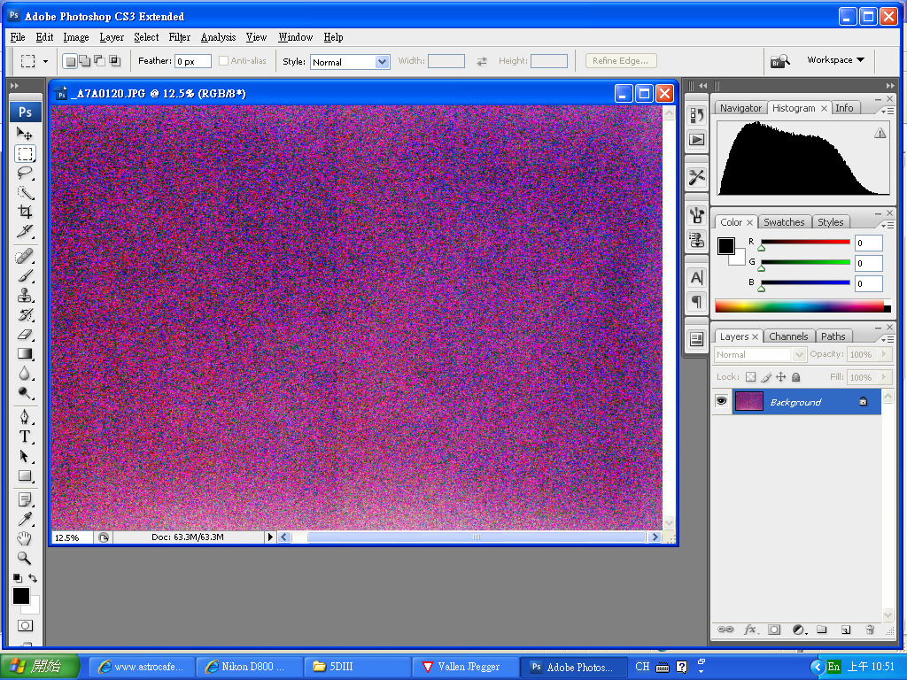

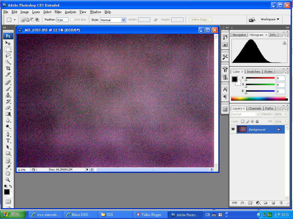

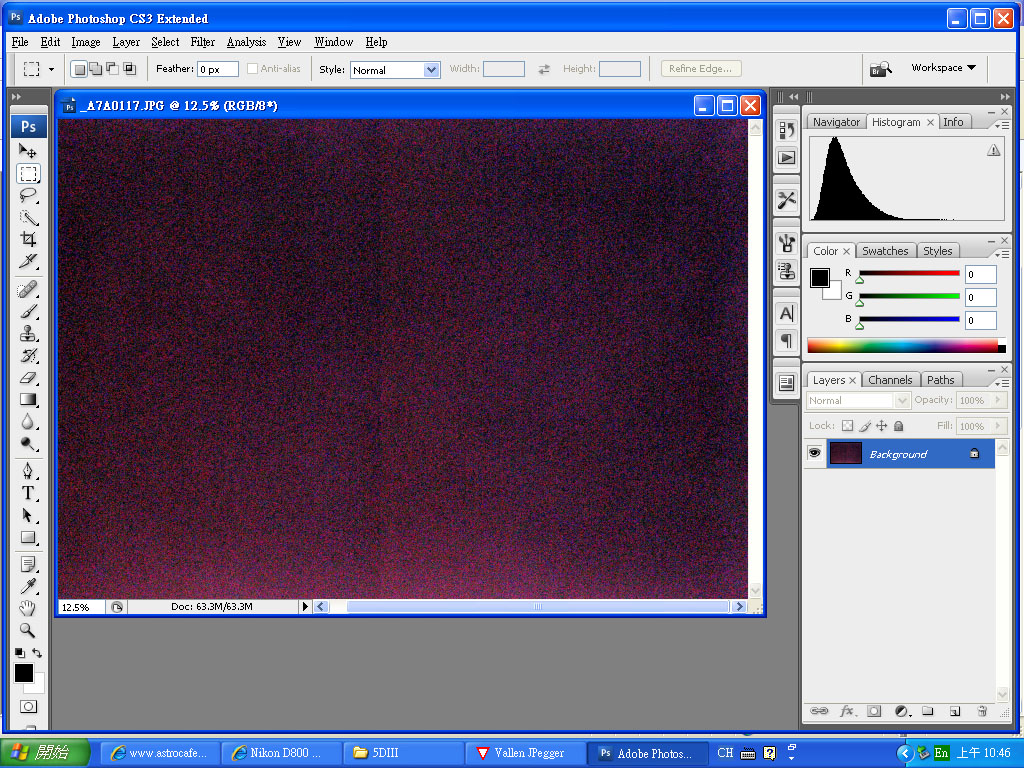

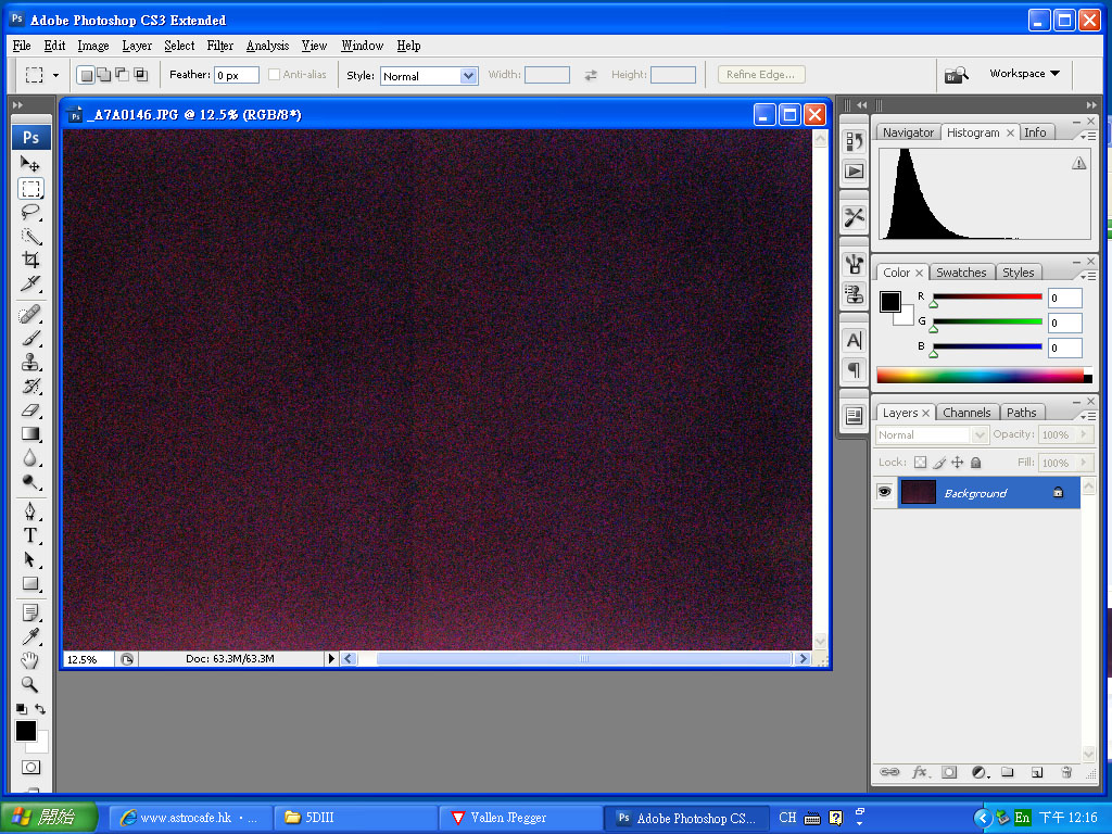

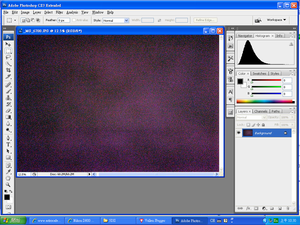

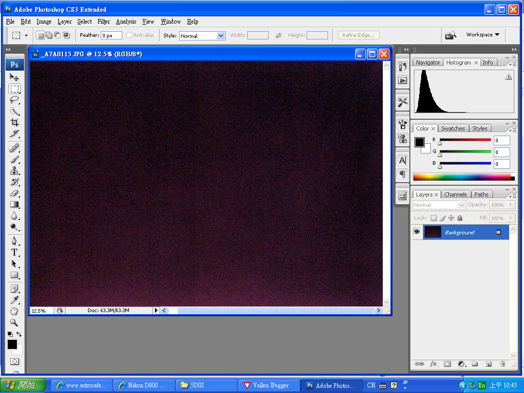

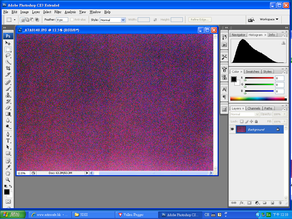

As my colleague bought a new 5DIII, I performed a side-by-side comparison of dark frame under a control condition. Both cameras are unmodified. The experimental conditions are following:
ISO: 400, 800, 1600,3200, 6400, 12800, 25600, 51200 (5DIII only), 102400 (5DIII only)
Noise reduction is turned off
Exposure time: 5 mins
Room Temp: 24oC
For the 5DII, basically the noise is low up to ISO 1600. One can see there is only a narrow peak at the left hand side of the histogram. However, when the ISO is push to 3200 and beyond, there is significant increase in noise. The histograms are wide spread distribution.
For the 5DIII, the trend of the noise performance is similar to that of 5DII. But the limit is further pushed. The noise is very low up to ISO 3200. In fact, if you compare the 5DII's ISO 1600 histogram with 5DIII's ISO 3200 histogram, the later one got less area! That is the 5DIII has lower noise. However, if we look at the 5DIII's ISO 6400 histogram, it couldn't beat 5DII's ISO 1600. Since I did the test in 1-stop ISO increment only, I guess the 5DIII should beat 5DII by 1 1/3-stop to 1 2/3-stop.
Here I don't mean the usable ISO of 5DII is 1600 for long exposure. Whether the noise is acceptable is a personal matter. I just pointed out that the noise would increase significantly under this experimental condition. In addition, If one is satisfied with the noise level of ISO 1600 of 5DII, one should also satisfied with ISO 4000-5000 of 5DIII.

willis 寫:For the 5DII, basically the noise is low up to ISO 1600. One can see there is only a narrow peak at the left hand side of the histogram. However, when the ISO is push to 3200 and beyond, there is significant increase in noise. The histograms are wide spread distribution.

Yes! If 5DII's ISO 6400 can satisfy u, 5DIII's ISO 12800 can also satisfy u. In fact from the histograms, the noise of 5DIII's ISO 12800 is lesser than that of 5DII's ISO 6400. Maybe even ISO 16000 (1 1/3-stop) or ISO 20000 (1 2/3-stop). Nowadays DSLRs ISO performance is very good. I guess whenever there is new generation of camera, there would be at least 1-stop advancement in ISO. Think about a few yrs ago, we hardly imagine that the ISO over 100000. In 2010, Nikon's D3S groundbreaking ISO 102400! Canon follows later. Now the D4 & 1Dx, they have ISO 204800! On the other hands, the advancement of reducer is much slower. If it is not impossible, it is very difficult. The fastest reducer of Tak is 0.72X. This is still not 1-stop. For 1-stop faster, the reducer should be 1/Sqrt 2 = 0.71X. The price for fast reducer are the difficulties in correcting the vignetting, coma & chromatic aberration etc. The advancement of ISO helps to reduce the effect of tracking error and allows telescopes with regular focal ratios to explore their potential in astrophotography. That's why I told u that never mind ur 80/600's focal ratio 7.5 last yr. As u can see, the ISO performance of both 5DII & 5DIII are very good. I am sure that next generation, say 5DIV, the acceptable ISO for u will be at least ISO 25600.

I checked! Forgot to turn off the high ISO NR for both cameras! They are set to "standard". I will test them again today! Thanks for reminding!
There is no obvious hot or dead pixels in 5DIII's ISO6400. ISO 6400 is true ISO for 5DIII. ISO 51200 & 102400 are expanded ISO.
Re: Noise Performance: 5DII Vs 5DIII
文章willis » 2012-06-19, 12:36
Redo the experiment with both Long Exposre NR & High ISO NR turned off. The result is similar to previous one, but 5DII's ISO 1600 got a bit more noise increment.

Under normal situation, I prefer 5DII's ISO 1600 even in HK summer. So according to my testing, it should be ok for me to use 5DIII's ISO 4000 in HK. Of course acceptance of the noise level is a personal matter. Well, probably I need to wait for the launch of 5DIV before my next upgrade to 5DIII. :lol:
