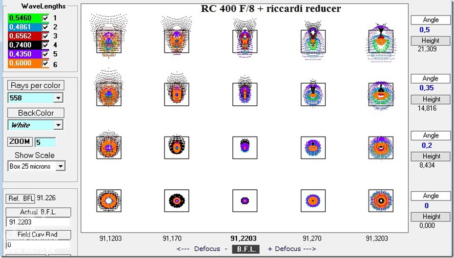

文章社長 » 2012-05-13, 19:09
標準型號,在400mm f8 RC上,成像極之優秀 8-)
注意樓下的Spot diagram已有點過火了,其實740nm對改濾鏡單反,甚至冷凍相機用的Astrodon濾鏡,也是用不著的,亦即在我們常用範圍,全片幅下星像是在25um方格內:
http://www.astrodon.com/custom/_2e2a/co ... forWeb.jpg
http://www.sciencecenter.net/hutech/idas/uibar-iii.htm
而高橋的旗艦攝星鏡FSQ106,Spot diagram只計算至Ha波段656nm:
http://www.takahashi-europe.com/en/FSQ- ... .spots.htm
這是一個例子,歐系及日系攝星鏡其實對自己有不同水平的要求。
Quote
That’s incredible ,my reducer seems working in very accepttable manner even on RC.
As you can see below I added it (the bigger one) to a 400mm F/8 RC and this is the performance on the 24x36 format:
If you don’t consider the 740nm it works fine even at the edge and the focal reduction is 0.75x (from F/8 to F/6). The bfl as you see is 91 mm.
Do you think there could be a new market for my reducers?
On the other hand and unlike the others reducer our reducer includes Ed glass which allows for a minor color spreading.
Massimo
副本Rc400+Riccardi reducer.jpg (129.36 KiB) 被瀏覽 21366 次
