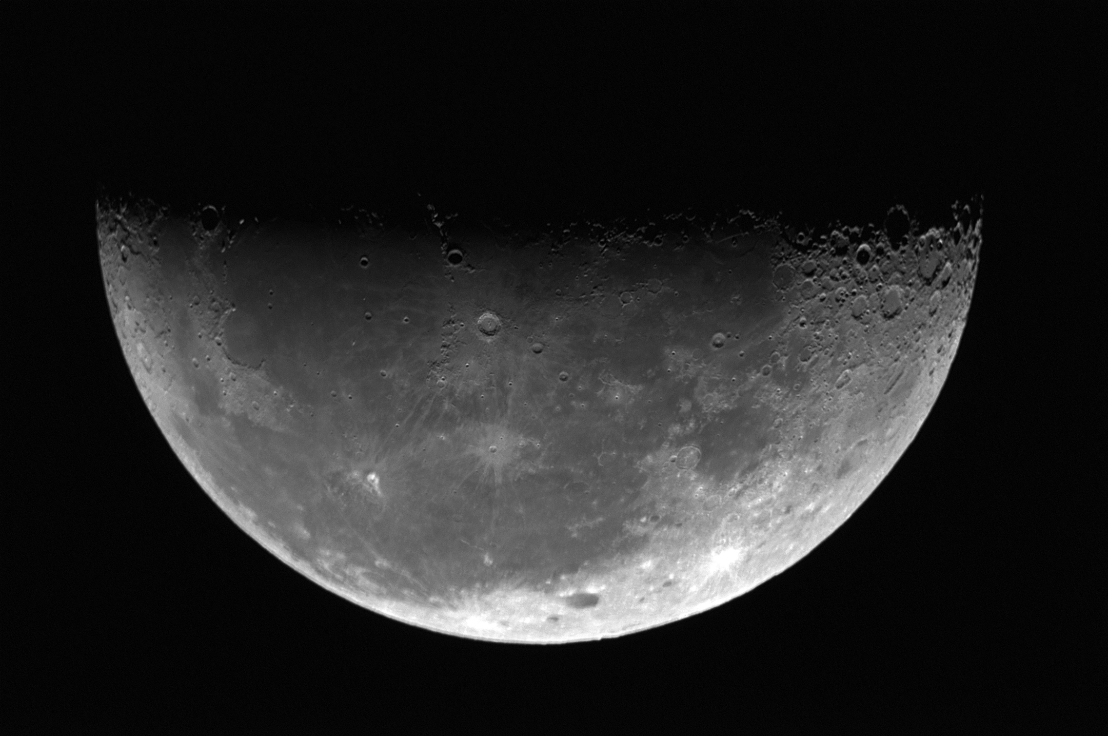

Lewis » 2010-11-01, 00:05
Date: 30-Oct-2010
Time: 01:50
Object: Moon
Scope: Celestron C8
Camera: Nikon D300s (Liveview focus)
ISO: 800
Shutter speed: 1/200
Original size: 4288 x 2848
Moon - Sources: 41 JPG stacked.
RegiStax 5.
Photoshop (AutoColor,Curve,Unsharp mask)
Re: 2010-10-30 Moon
文章社長 » 2010-11-01, 06:13
Lewis 很勤力的,天氣一好就不斷拍拍拍。
這個仰角的天體很容易有大氣色差,加片綠色濾鏡會銳一點的。另外有沒有鎖上反光板以減低開關快門時的震撼? 調焦或許可以再一步,可以參考Willis的調焦盤,因為按理疊加後再銳化不應是這樣子的,當然我不清楚香港的視寧度如何。
若追求完美的,拍攝時用RAW,疊加後才用JPG出圖會明顯好些的。個人體驗是疊加這個比例的月亮,及這種高對比度的場境不用疊加太多,選最好的5到10張疊加已足夠(例如年初我拍的日環食),15至20張以上會有反效果 - 疊加太多是會柔化影像的。

文章Lewis » 2010-11-01, 06:42
社長 寫:Lewis 很勤力的,天氣一好就不斷拍拍拍。
viewtopic.php?f=15&t=32
1. 已經鎖上了反光板才影,始終覺得C記LiveView好像比N記準。
2. 已經是用RAW影,但變了JPG後,好像少了點銳利感。
3. 其實我懶,應該在每個對焦點影多幾張。

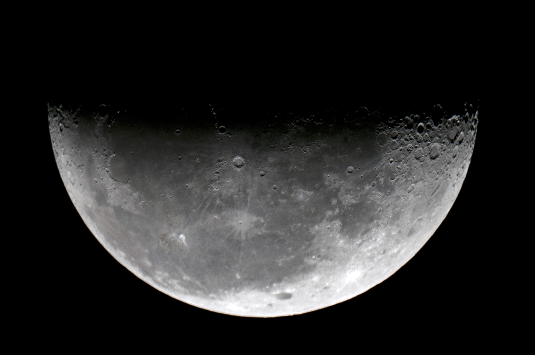

文章Lewis » 2010-11-01, 21:11
1. select 26 out 40 images which are more sharper than other.
2. use NEF sources directly convert to BMP.
3. Registrax again (with default parameter)
4. Photoshop (AutoColor, Curve, Unsharp mask)
It's seems that it's better a lit.
Re: 2010-10-30 Moon
文章社長 » 2010-11-01, 22:06
Lewis 天氣好就拍啊,可以儲夠一個月相週期 8-)
有機會要看看你如何拍,以及檢視一下你的望遠鏡,看看能否解決月面邊緣的柔化問題。

文章willis » 2010-11-03, 12:23
Lewis shows lots of improvement. Focusing is very important. Try to make a focusing mask for ur C8. It is rewarding.
Re: 2010-10-30 Moon
文章Lewis » 2010-11-03, 23:58
willis 寫:Lewis shows lots of improvement. Focusing is very important. Try to make a focusing mask for ur C8. It is rewarding.
Thank, but Is focusing mask help to do the focusing on Moon? I already have one.
Re: 2010-10-30 Moon
文章社長 » 2010-11-04, 20:35
no, focusing mask only work on point source, not even planets.
of course, you may get focused on a star nearby then slew to moon, but I fear your focus will shift due to the mechanical nature of SCT.
the best way is still focus by quantifiable way, like digital focusing. Or trial and error - focus and image, and refocus and image, then select the best. David is the very best example on this.
