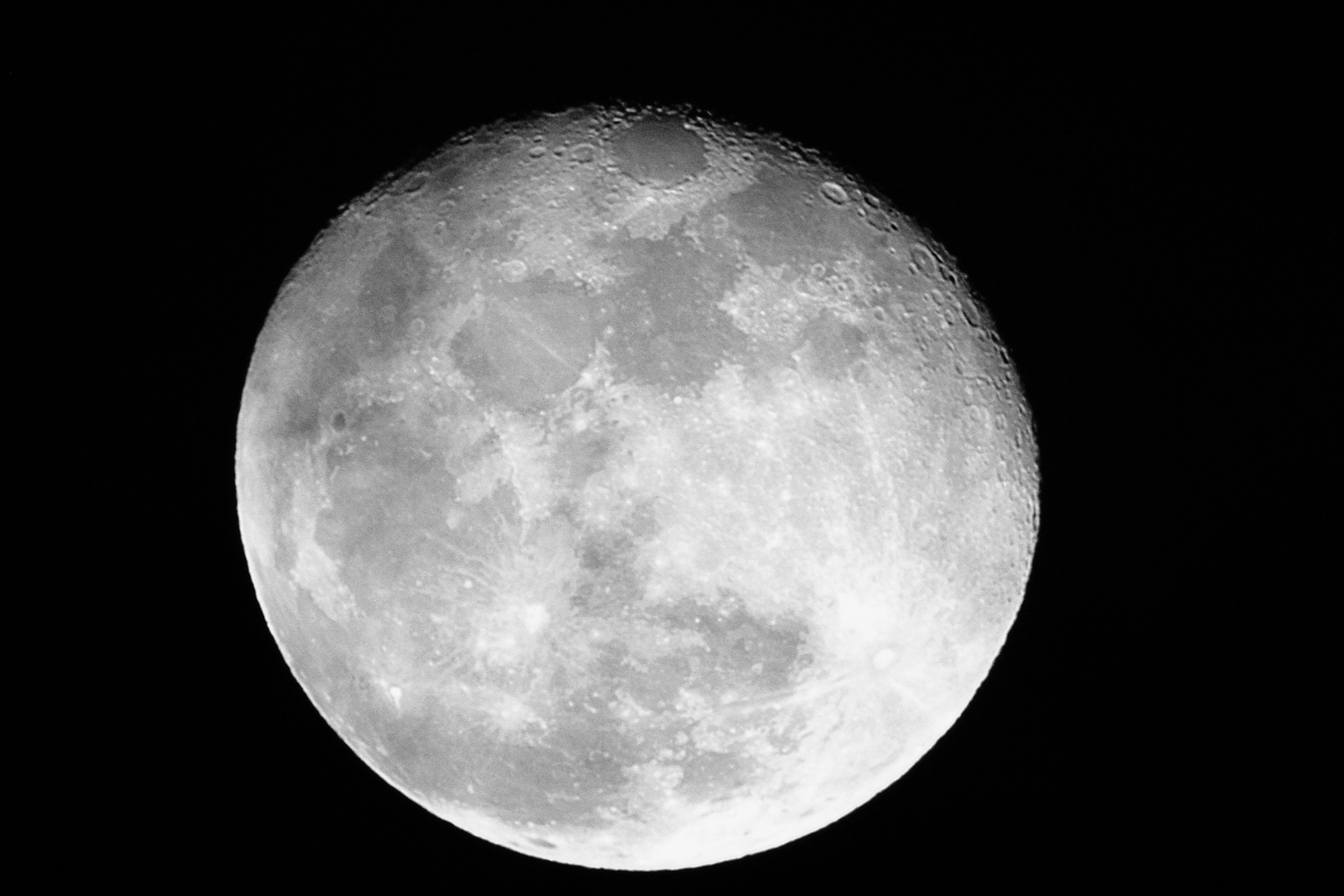

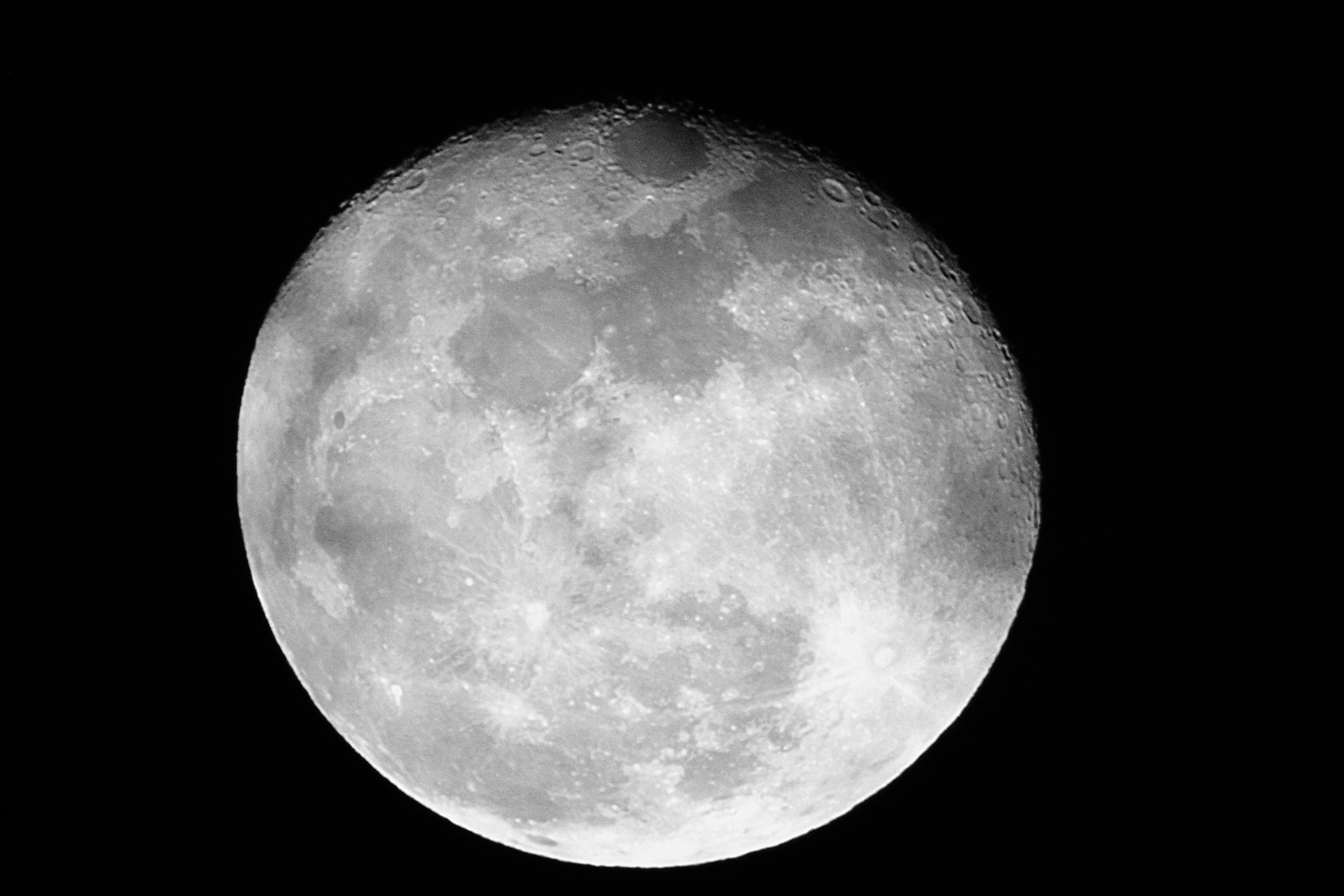

Lewis » 2010-05-03, 23:11
兩張試機相
Date: 2010/04/30 22:29:29
Canon 300D
Shutter speed 1/20
ISO 800
Single Frame
Maksutov-Cassegrains BK127MAKNEQ5Pro
Photoshop - Auto Tone, Auto Color, Smart Sharpen.
因為太急,只能用人眼對焦。

文章willis » 2010-05-03, 23:22
What is the ISO, seeing & transparency? 1/20 s is quite slow for this focal length... Keep on trying!

Re: 4月30日的月亮
文章David » 2010-05-04, 21:56
willis 寫:What is the ISO, seeing & transparency? 1/20 s is quite slow for this focal length... Keep on trying!
I also think that 1/20s is way too long for a good photo. I usually try to use something shorter than about 1/100s.
Re: 4月30日的月亮
文章Lewis » 2010-05-04, 21:59
It can see that the image is a little over, so next time is better.

Re: 4月30日的月亮
文章David » 2010-05-05, 07:21
Also, 人眼對焦 is highly inaccurate. I don't even trust my judgement when looking at liveview magnified at 10x.
I usually take many photos, with each taken after turning the focusing knob a little bit. Then a few photos should be in very good focus. This doesn't take long to do but will guarantee good result. ;)

Re: 4月30日的月亮
文章社長 » 2010-05-05, 09:20
其實若拍攝時能量化調焦位置便可以,Lewis 可以考慮造一個這樣的調焦刻度盤(留意Equinox 80慢速調焦鈕那個):
viewtopic.php?f=5&t=243
這個用紙造的也可以,貼在Maksutov上便可以,每個刻度拍一張,選出最清晰那調焦位置,然後再拍多張,便有機會從視寧度的或然率下拍到一些理想照片。
