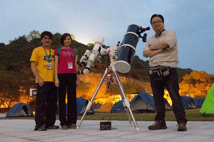

文章社長 » 2014-10-29, 14:33
Got the photo yet from Eric Ng (standing on left)
Quote from Eric Ng,
"Good stability with MN190 and TSA102"
SkyWatcher MN190 (馬克蘇托夫牛頓)
viewtopic.php?f=27&t=3973
