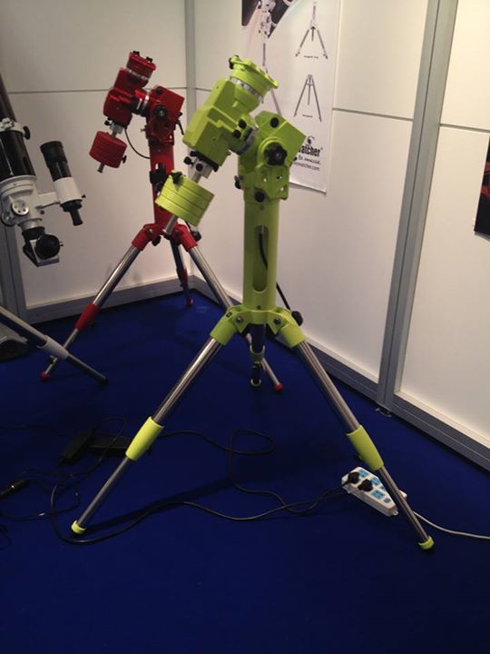

社長 » 2014-09-20, 15:23
要綠色或紅色? 透明的暫時無貨。

文章willis » 2014-09-21, 23:29
According to the photo, this mount seems got similar payload of that of HEQ5 Pro. I am waiting for something like the EQ5Pro or EQ3pro grade mount.

文章社長 » 2014-09-21, 23:42
willis 寫:According to the photo, this mount seems got similar payload of that of HEQ5 Pro. I am waiting for something like the EQ5Pro or EQ3pro grade mount.
不如說說具體你想承什麼鏡?
若這個測試成功,可以用來承承你的105APO,比HEQ5 Pro會輕一點,又沒有過中天反車問題。

文章willis » 2014-09-22, 00:23
I want a light weight mount for overseas imaging. HEQ5 pro is too heavy for this purpose. I guess a mount like EQ5Pro or lighter is enough for 80/480 or 105/650.

文章社長 » 2014-09-22, 00:32
then why don't you get a EQ5 Pro?
viewtopic.php?f=17&t=3972#p26461
EQ3 Pro is too weak for 10Kg equipment.
if you are just imaging with 80/480, then Star-Adventurer is good enough.

文章willis » 2014-09-22, 10:11
Yes, EQ5Pro is an option. However, it has been launched for long time. I just want to see if SW launches a successor of EQ5Pro. If I really want to get an EQ5Pro, I would like to buy a used one. But it seems that not many people owned an EQ5Pro. The second hand market is none!

文章社長 » 2014-09-22, 11:26
以你的用途,什麼dual encorder沒特別用途,反而赤道儀越輕便越好,那EQ5 Pro便夠了。
若想再輕便的,不用配重,直接在配重桿及三腳架上一個支點連接一條彈簧,只是極軸在+/-90度的擺動範圍內那彈簧是其直線性拉力範圍,你隨便一個角度平衡了,其餘角度都大致平衡,你可以用Hooke's Law核證一下。
問題是,那情況下整台鏡的重心不會垂直處於極軸之上。

文章社長 » 2014-09-23, 13:29
willis 寫:Yes, EQ5Pro is an option. However, it has been launched for long time. I just want to see if SW launches a successor of EQ5Pro. If I really want to get an EQ5Pro, I would like to buy a used one. But it seems that not many people owned an EQ5Pro. The second hand market is none!
另外若你能手動找目標,EQ5比EQ5 Pro好,4顆1.5v電池可以用超過一個晚上,省電輕便得多,不開GOTO又沒有過中天時自動停機要Meridian flip的問題,價錢又平宜一大截。
