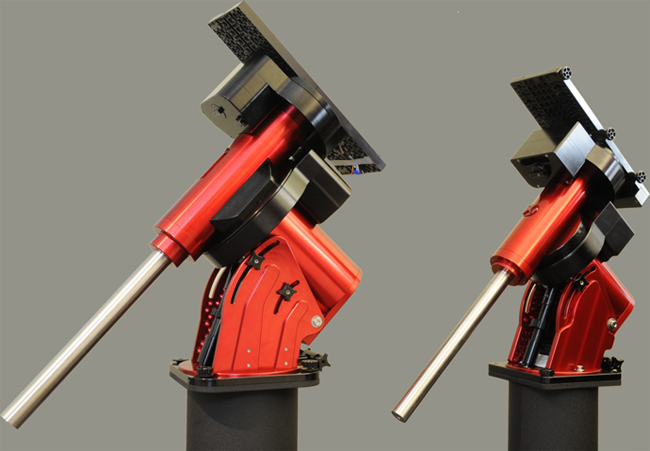

社長 » 2012-09-24, 09:56
有人想要我的Paramount ME嗎? 西藏交收 8-)
星河科研社為派拉蒙亞洲區代理:
http://www.bisque.com/help/paramountme/ ... #Chinabc-2
Paramount MEII:
http://www.bisque.com/sc/pages/ParamountMEII.aspx
This is an unofficial announcement as the Software Bisque Web site will be updated in the near future when we are ready to take orders. In summary:
Software Bisque is showing a Paramount ME 2 at PATS this weekend in Pasadena. This is a PATS exclusive, and the web site will be updated with official information soon.
The Paramount ME is no longer available. The first production run of the ME 2 is already underway.
The ME 2 is basically a larger version of the MX, and larger than the ME actually.
Same foot print however, ME 2 will fit on an ME pier.
It weighs 85 lbs.
Carrying capacity is 240 lbs (up from 150).
Pretty much everything is bigger.
Much more room for through the mount cabling.
Two USB ports on the Versa plate.
Auxiliary kycron connector for two sets of external high current DC power (just like MX).
Supplementary 5v and 12v supplies that run off mount power supply.
guider port, focuser port for pulse guiders.
Can track up to 3 hours past the meridian (with adjustable hard stops)
Uses the new MKS 5000 control system.
It will be priced less than the current ME... Introductory price is $12,750.00.

樓上已更新圖片及現接收訂單
