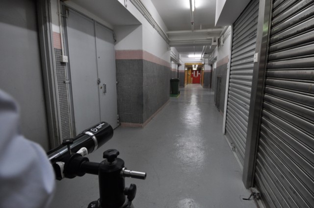

At the end of last December, I was told there is short tripod for HEQ5Pro. I was delighted by this news and asked Galaxy to reserve one set for me. This is by all mean improve the portability of HEQ5Pro. At the same time my friend Xiaoer needed to buy a new refractor which is used to couple with the LS75F. We went to Galaxy and shopped. When we arrived Galaxy, we were tempted by those scopes put messily on a table! A&M/LOMO 80/600, Tak FS78 and Pentax 75SDHF etc. Our curiosity drove us to try those scopes. Due to our background, doing experiment is kind of fun. If we can perform a star test and do some celestial observations, it would be great! However, the sky sucked almost for the whole winter, it is difficult to find clear skies for testing the scopes! So we tried an alternative, indoor test! Star test is a simple and accurate method to test and collimate telescopes. Instead of using a real star, Sirius or Vega, to perform star test, we used an artificial star. Basically it generates a spot of size 50um. When place it a several tens meters apart, the angle sustained will be smaller than the Rayleigh resolution. In our case, the spot size is 50um and the distance is 25.3m. The angle sustained is 50x10^-6/25.3 = 1.98x10^-6. Roughly all the aperture of all the tested scope is 80mm. The theoretical limit of the resolution, Rayleigh resolution, is 1.2x550x10-9/80x10^-3 = 8.25x10^-6. So the artificial star is virtually a star now! There were some advantages of using artificial star.
1. In Hong Kong, it is sadly that we cannot have bright real stars when in needed.
2. Even the telescope is the same, different nights would result in different star test result. The seeing, the turbulence of atmosphere, affects a lot.
3. Real stars are moving, but artificial star is stationary. One can perform high power magnification without caring about the tracking. Collimation is possible by using artificial star too!

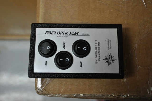

The artificial star we used is not white light, but R, G & B. This is a big advantage that we can test the color correction of the scopes in three widely separated wavelengths in the visible spectrum. Well! The artificial star is very good in testing telescope. But it got a big disadvantage! It costs you for more than HK$2000! Worth it or not, you think about it!

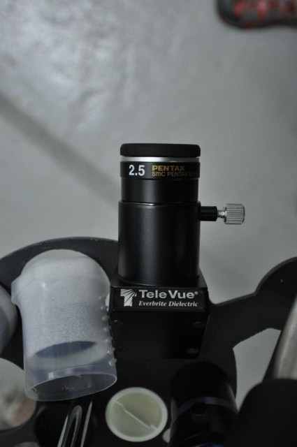

OK! Back to our main course, the optical performance of A&M/LOMO 80/600 Vs Takahashi FS78 Vs Equinox 80ED. We used TV Everbrite diagonal and Pentax XO 2.5mm eyepiece to boost the magnifications above 200X for all scopes. All three scopes gave very good green diffraction pattern, especially the A&M/LOMO. It just standout! Its’ 2nd diffraction ring was almost invisible. This result was quite expected as all telescopes are optimized for green light. We next turned the star test to red light. The red light performance is corresponding to most DSO and Ha performance. The A&M/LOMO gave excellent diffraction pattern. Both Tak FS78 & Equinox 80ED gave very good diffraction pattern. It seems that Tak FS78 gave a bit better performance than Equinox. Finally we turned the star test to blue. A&M/LOMO gave very good diffraction ring. While both FS78 and Equinox 80ED gave good diffraction pattern. It seemed that Equinox gave a bit better performance than Tak FS78.

The use of artificial star is very convenient. The seeing is not an issue and the result is reproducible if other controllable factors, say distance and brightness, are fixed. The result is quite obvious that the A&M/LOMO is by all mean the winner. All three RGB star tests of A&M/LOMO are way ahead Tak FS78 and Equinox 80ED. It is hard to differentiate Tak FS78 & Equinox 80ED, because we didn’t set all scopes side by side and do comparison. From the very beginning, we started the test after a casual talk. So no serious preparation was done. Only one tripod was used. This means we need to swap the scopes and memorize the star test result for a particular scope and do the comparison. Unless the result is very outstanding like the case of A&M/LOMO, otherwise it wouldn't be very reliable to tell the difference. In other words, there would not be big different in Tak FS78 & Equinox 80ED. If one really wants to differentiate them, a side by side artificial star test is needed.

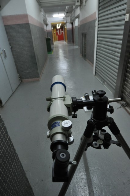

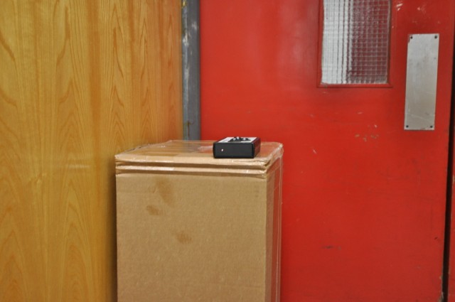

The artificial star is placed 25.3m apart
The artificial star

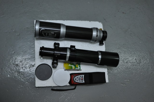

A&M LOMO 80/600, Equinox 80ED
Takahashi FS78
RGB artificial star

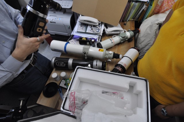

What a mess!

2. 這個人工星點是我在08年由德國帶回來的,"made in Italy" 要二千多元,上面標明是"for profession astronomers",我的老友APM的老闆Markus Ludes每天都用這個來測他的望遠鏡,所以我經常跟人家說那個品牌那個設計那個造工如何,是有一套客觀標準的,所以這個對我的情況來說很有用,下一正還會購置一些如大直徑的光學平面鏡等,因為看來大家都很有興趣這方面的測試,而非道聽途說的了解不同望遠鏡的性能。

4. 測試望遠鏡中,所用的部件要小心處理,市面上的天頂鏡,以四個品牌為最佳,分別是Astrophysics、Televue、Vernonscope、Stellarvue ,其中我選Televue中最高型號的Everbrite,因為取其結構堅固,由一塊實心鋁材CNC加工而成,對我這些經常用上手榴彈目鏡的人來說很重要,當然代價是要二千多元,但一如早前一次白鷺湖天文台小組觀星夜時驗證,一些看來正常的天頂鏡,在近200倍時已看到像差,在500倍時根本連成像都有問題,在203APO隨時推上600倍觀星的情況下,別無他選了。另外因為要減中間的光學元件以免引入像差,我儘量避免用巴羅透鏡,所以Supermonocentric 4mm目鏡也略為過長,最後用上了Pentax XO 2.5mm目鏡,以上面三台望遠鏡計,倍率都在200以上,甚至250倍,所以很合適。
