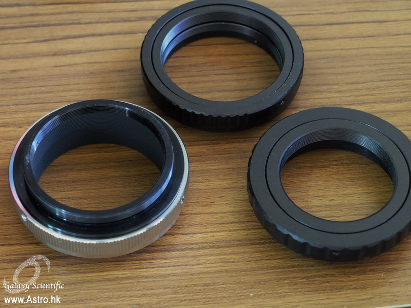

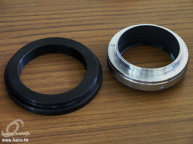

Officina Stellare 可以為不用用戶訂製接環,而我有時也會自己動手,剛為自己的RH200造了一個連接Canon相機接環的接環。
傳統的T Ring因為通光孔徑大小,全片幅尤其是f3大光圈下,漸暈(Vignetting)會很明顯,所以Skywatcher M48接環或其他品牌的 Wide T Ring等都是較好選擇。
我造的接環亦可以用M52光害濾鏡,當中比較推薦IDAS LPS-P2濾鏡或V4,前者的用途廣泛些。

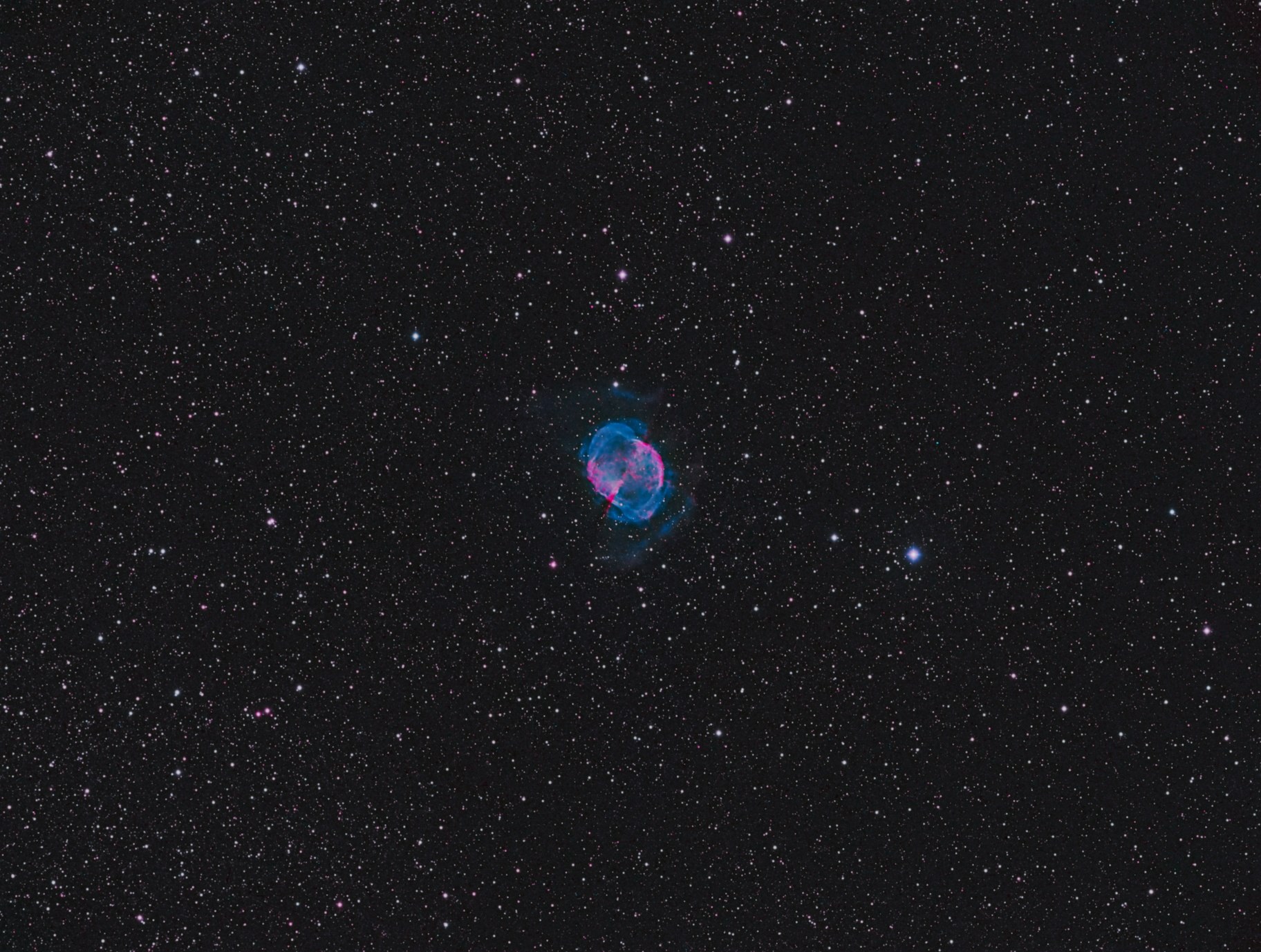

Take a look at this M27 picture by Davide Manca with his Officina Stellare Veloce RH200 and QSI 683WSG CCD camera, great result!

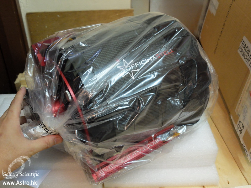

今日新到的RH200及Hiper 152APO,其實RH200真的很細小,像電飯煲一樣.... :mrgreen:

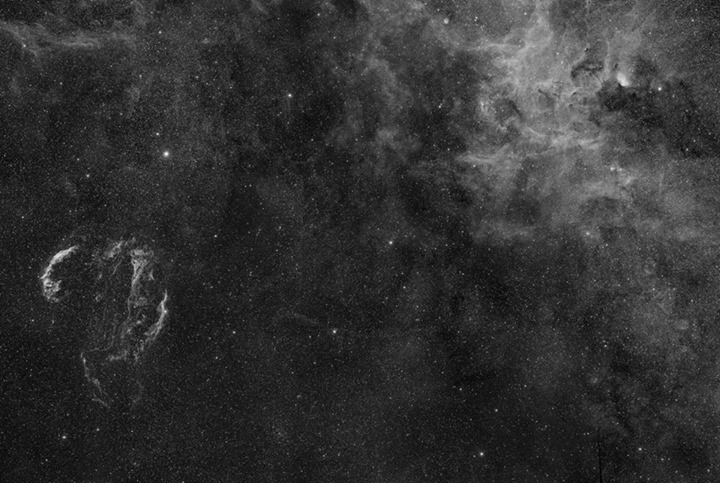

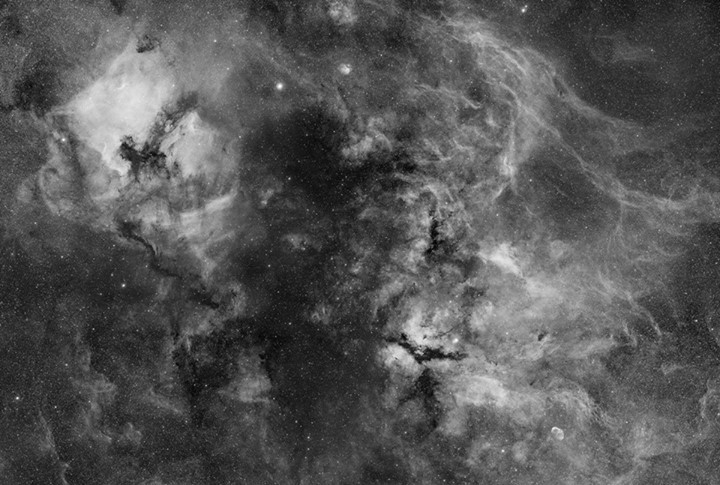

From Sean Walker (Imaging Editor @ Sky & Telescope Magazine) timeline. "Here's a big project I've been working on with Dennis di Cicco. we did a 30-panel mosaic of the Cygnus region using a Officina Stellare RH-200 (8-inch 600mm fl, f/3) and Apogee U16M CCD camera with 7-nanometer HA filter. Each panel was 80-minutes of exposure...". This picture is the full mosaic vastly down-sampled so you can see the entire uncropped field.

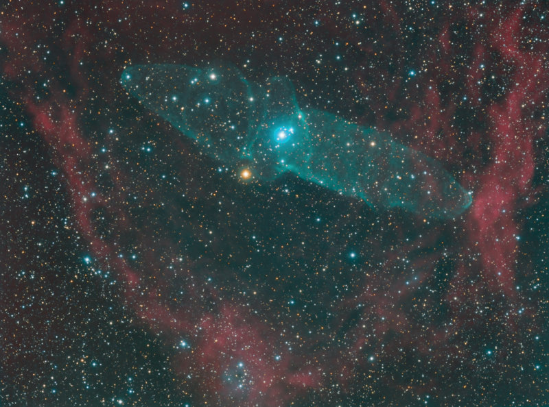

A really amazing picture, from Harel Boren! Ou4 (and SH2 129): A Giant Squid Nebula and a Flying Bat with his RH 200!
http://www.pbase.com/image/157835661
SH2 目標比較冷門,因為沒有太多參考案例,原來中間有一個藍色星雲,因為西藏已換了鏡沒法再拍OIII通道了 :oops:

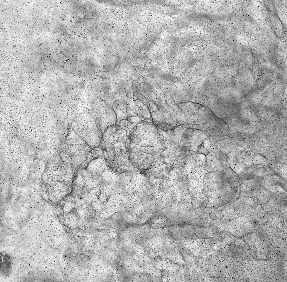

"Still waiting for the largest color mosaic of the Vela supernova remnant region! Still working on! From Australia, Bert Van Donkelaar and his Officina Stellare RH 200 astrograph just shared the new NII panels. 6 by 6 degrees, more than 7 by 7 Kpixels square (here reduced, of course). Both positive and negative images."

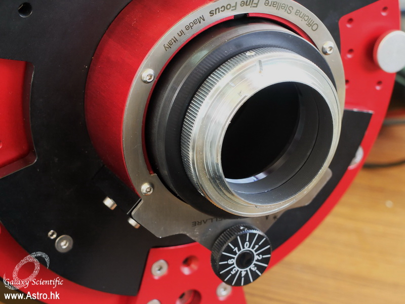

有幾點分享,
- 這台鏡回來不用調光軸,但要調一下焦平面,因為接環相機等都有機會不準直。但方法很簡單,參考調焦盤上刻度,檢視像場4角的焦準,然後調節鏡背的連接板4角Push-Pull縲絲便可以。例如昨晚用Canon 6D,像場兩側的焦準相差為調焦刻度盤上的1.5,那只需要調焦相應像場兩側的Push-Pull縲絲出入半圈便完成。只要正常裝拆及運送望遠鏡,一次調校便不用再理。
- 這望遠鏡在遠大折射鏡(也包括高橋Epsilon 180ED等系統)可容許的温差範圍內仍保持焦點穏定,這點在Sky & Telescope的測試報告已有論述。同時本身附上的原厰調焦座,手動調焦足以應付這f3光圈精確要求,所以除非在溫差極大的台址建台,否則根本不用電子調焦,甚至不用魚骨板調焦也可以。
