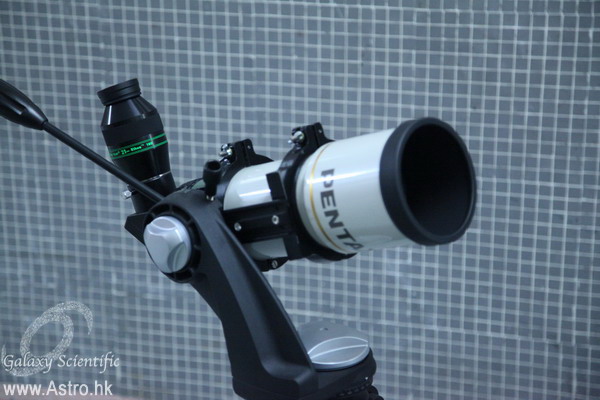

品名 Pentax 100 SDUF II 平場APO折射鏡
口徑 100mm、焦距 400mm (焦比 F4)

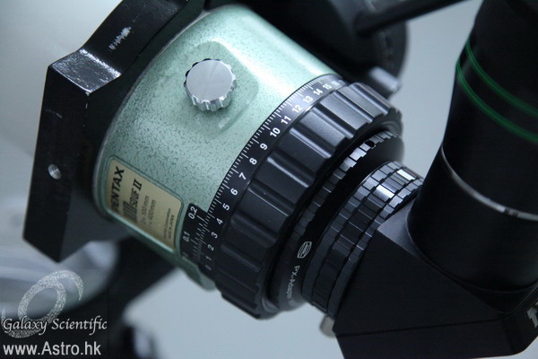

調焦 旋進式,最小讀數20微米、最小調焦精確度10微米
先上圖片其餘細節稍後發報,包括目視報告、像場星點比較等,例如:
- 與頂級三枚玉APM-TMB APO折射鏡目視對比
- 全口徑及收細光圈下的星點表現

Precision helical focuser with scale.

The drawtube has an inside diameter of 88mm, and fully illuminates 6 X 4.5 format with ease. The helical focuser includes a scale that allows precision focus to 0.02mm or better with a large knurled ring that fits the hand comfortably.

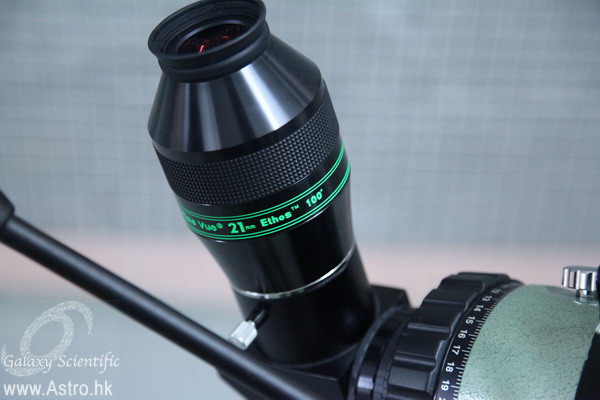

注意現有的接環,配2"天頂下,Ethos 21不合焦,但Ethos 13可以,稍後試試Ethos 17。

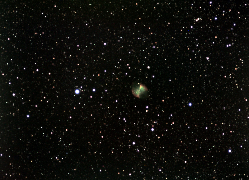

文章benben88 » 2010-05-15, 20:45
Let the photo speak for the scope.
Taken few years ago by ST2000 XM through L(60sX 20) RGB (120s each 2X2 bin) + Ha (60s X10) at Yuen Long , Hong Kong.
Not that bad for the CCD imager although it was designed for film photography.
The colour correction cannot match the 3 elements APO of today but I think it is acceptable as it is a fast F4 scope. There is no F4 3 elements system in the market (correct me if i am wrong) so it is unfair to compare this scope with F 5 or F 6 system.
I took this scope to Aussie twice as it is a really compact , light (4kg) scope. It offers me 20X with pentax XL 20mm and the view of the Omega GC ,LMC (lot of nebula inside)etc is owesome in the true dark sky at the outback aussie. i just grabbed it with my arms when watching the sky using this wide field scope. :mrgreen:
M 27 100 SD UFII
Combined Flatttened Ha + LRGB resized.jpg (206.95 KiB) 被瀏覽 24560 次

- 很方便的調焦筒,精度不俗,僅手動便可調至10um水平

樓上兩圖都是用7.4um的像素拍攝的,所以照片解像度很受兩者的焦距影響,700mm vs 400mm。
當然兩鏡的設計年代相差二十年,性能上始終有差距。
有點像開一部70年代的老爺平治車,需要知道它是不能跟現代最新型號的性能比較,但郤仍感到它那個年代的Ride Quality。
