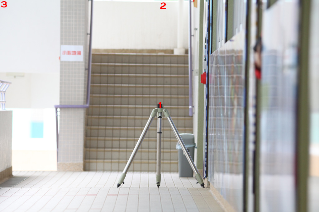

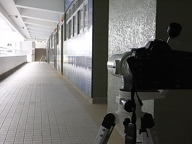

This time I did the test in corridor. I used the same artificial star which I used in previous Equinox 80ED test to perform the test. viewtopic.php?f=5&t=243&p=1753#p1753
The procedure is the same.
The testing detail is follow:

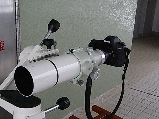

Telescope: Takahashi FS60C
Distance between the telescope and the artificial star: about 36m.
Camera: Canon 5D II
ISO 1600
Shutter: 1/125 s

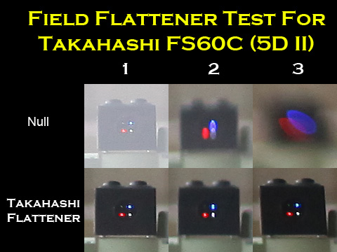

Before applying the flattener, the edge performance is bad. The imaging circle is very small. It shows strong coma. Without the flattener, the edge performance just ruins the photo. After applying the flattener, the edge performance improved. However the stars are not very round even at the middle of the top border. This means even for APS size DSLR coma is detectable. In addition, the image at position 3, upper left corner, shows distortion (See the "Test Result (100% Chop)" photo, locations) . However, there is a bonus of applying the flattener is that the contrast improved a lot. This is quite obvious from the photos. As a conclusion, without the Tak flattener, FS60C is a visual telescope only. If you really want to do image with it, a flattener is a must buy item.

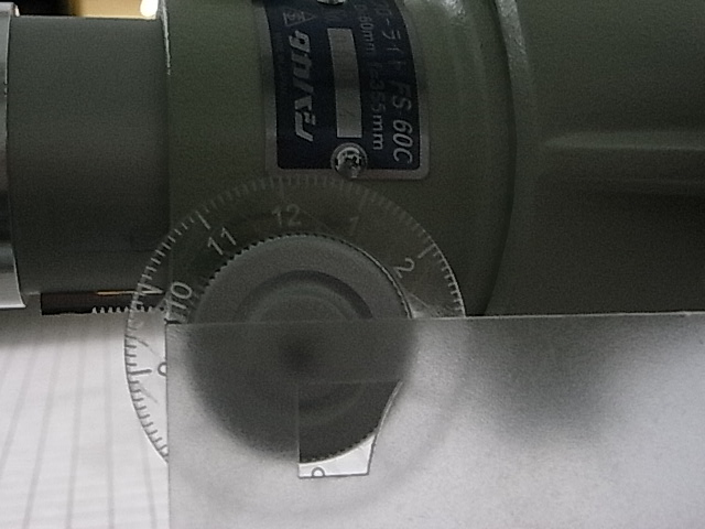

DIY large focusing dial

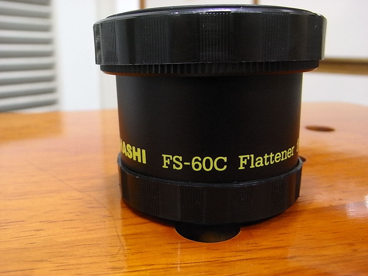

Takahashi Flattener
