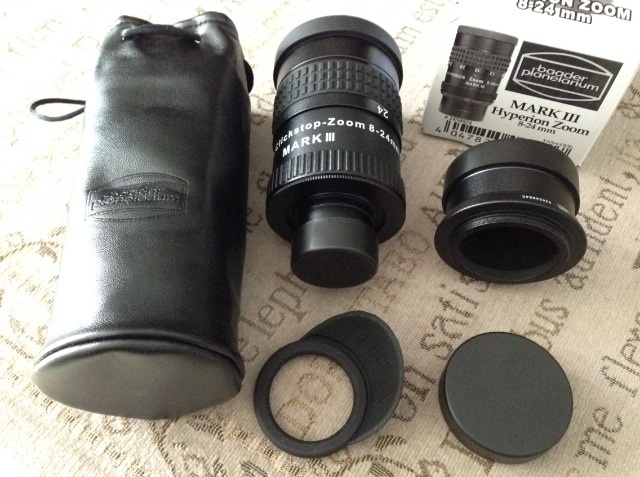

請教Baader Hyperion zoom 8-24mm Mk III
SkyDragon » 2015-07-23, 09:38
Zoom eyepiece是求方便,若純粹說質素的我也不會選。
方便在於:
1)觀星活動中
2)找出最佳倍率
3)懶,野戰時一個目鏡便算
在這樣的前提下,各位對這Baader zoom有什麼實際經驗嗎?
如耐用性,好像很多可以擰走的組件.......
有用家親身經驗?先謝謝!

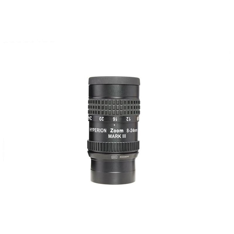

I once AB tested TV 8-24mm & Baader 8-24mm. No observable resolution difference between these two. The Baader got higher contrast. At this price tag, Baader is the best buy. The robustness is good! Now I have two Baader 8-24 zoom for bino-viewing. If u want to go beyond it, u can choose Leica & Zeiss zooms.

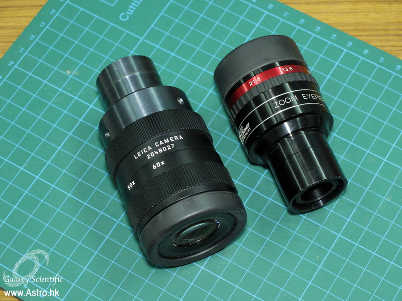

我一向不喜歡zoom,除了用台小日珥鏡輕鬆瞄瞄太陽時。
我有Lunt zoom 7-21mm,也有Leica zoom,刻意買上一代的,因為對比度更高,但用zoom本身就不是追求極緻的大視場、解像度或對比度,否則一定用定焦專科目鏡。那情況下我只能說Leica不如Lunt看得舒服。所以我全新買回來用了一兩次便擱在辦公室。目鏡用得不舒服是很致命的,十多年前進了些Televue Radian,用起來總是感覺很怪,眼睛不知應放哪裡的,所以我不會考慮這系列。

I only use minimal moving parts. Only those are needed, otherwise keep the unnecessary part in drawer. Baader is not exactly parfocal. One needed to adjust a bit. :(

買了一段日子,感覺是「平易近人」,比起這個價位的其他牌子Zooms,反差較"正常",因為一般的變焦目鏡反差偏弱。
用後觀感印正了Willis樓上的:
Willis 寫:I once AB tested TV 8-24mm & Baader 8-24mm. No observable resolution difference between these two. The Baader got higher contrast. At this price tag, Baader is the best buy. The robustness is good!
整體感覺良好,沒有買錯東西。
