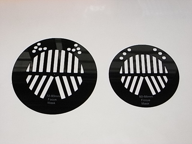

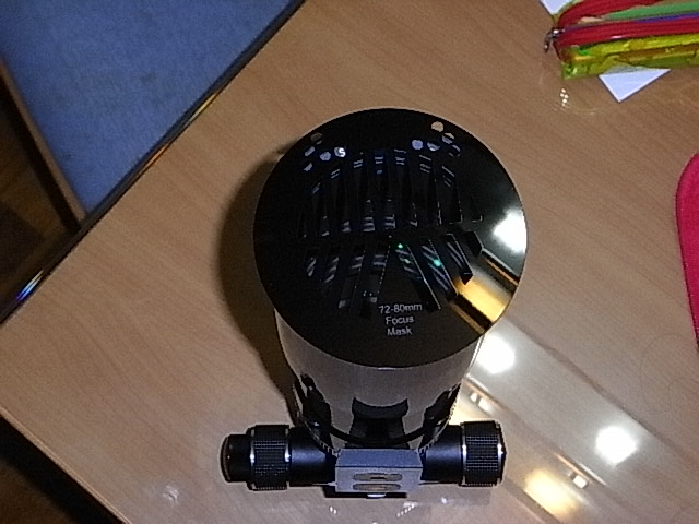

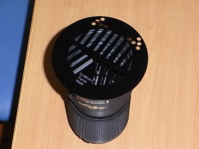

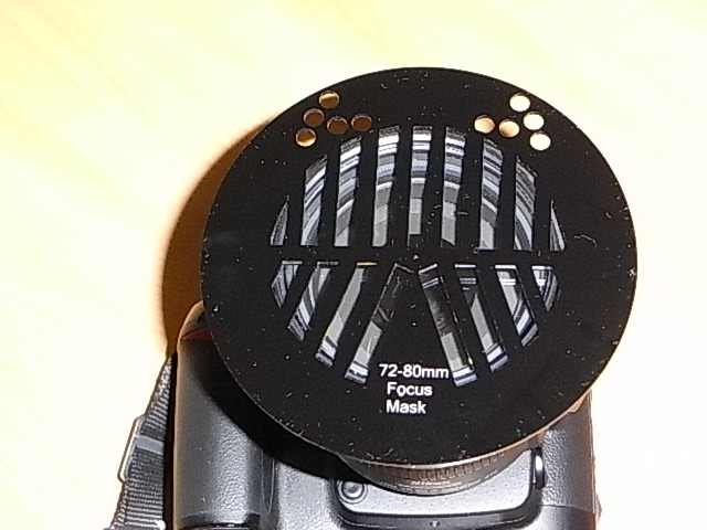

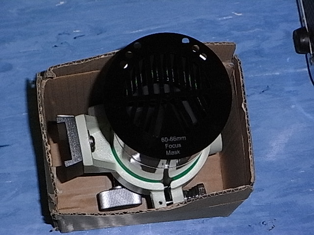

There are several factors affect the image quality. With a modest scope and mount, if focusing comes to second, I don’t know what would be the first. Even without an accurate electric Feather Touch focuser, if you have a focusing mask, the focusing would be improved a lot. Of course, if you have both, the accuracy can be down to a few microns. The focusing mask can be bought from http://focus-mask.com/index.html. However, there is free template provided by this website. One can use cardboard to make their free lunch box. If you want a decent one, you can order one from the website. In fact I ordered two focusing masks last year. As I found it very useful and I got more telescopes now, I tried to DIY focusing masks of different size by myself. I used Smart Sketch to re-draw the focusing mask and then use laser cutter to cut it. I deliberate drilled different holes around the edge of the mask. This can help to fit different tube sizes. With the Smart Sketch I just need to draw one mask, refractor version, and the other size can just be done by scale the image. Here are my products:
60-66mm & 72-80mm focusing masks
有幾個因素會影響圖像質量。有了一般級數的望遠鏡和赤道儀,如果對焦因素排第二,我不知道哪個是第一了。即使沒有一個準確的電動羽毛調焦器,如果你有對焦遮罩將改善了很多。當然,如果你有電動羽毛調焦器和對焦遮罩,精度可到幾微米。對焦遮罩可在http://focus-mask.com/index.html購買。然而,這個網站有免費的模板提供。人們可以用硬紙板,自製免費午餐。如果你想有一個像樣的,你可以從網站訂購一個。事實上,我去年訂購了兩個對焦遮罩。當我發現它非常有用,現在我有更多的望遠鏡,我就自製了不同大小的對焦遮罩。我用Smart Sketch描繪畫對焦遮罩,然後使用激光切割機進行切割。我故意在周圍多鑽幾個洞,這可以幫助在不同大小的鏡筒使用。在Smart Sketch我只需要繪製一個面具(折射版本) ,其他大小可以簡單的放大縮小便成。這裡是我的成品:
60-66mm & 72 – 80mm對焦遮罩
60-66mm & 72-80mm Focusing Masks
60-66mm on FS60C
72-80mm on 80-200mm (77mm)
72-80mm on 18-200mm (72mm)

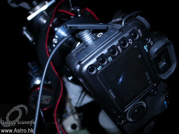

以魚骨版及電子調焦,可以把焦點調至最精確的一格,例如Feather Touch 3545調焦筒,配合電子調焦,每一格的變化是7.2um,所以我能做到焦準是+/-3.6um。而這情況下,Live View是幫不上忙的,我通常的做法是以人眼粗調後,再+/-5格每格拍一張,從11張中挑最好的,只要視寧度配合,一格已可看出變化。
這次在台灣高山上的溫差比香港大,由入夜至清晨失溫已超過四度,所以嚴謹的話,我的Kruppax鏡筒已已要重新調焦了。
