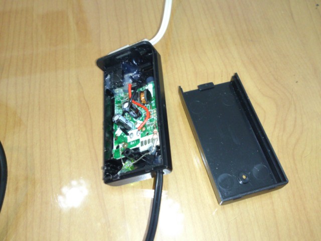

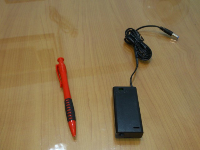

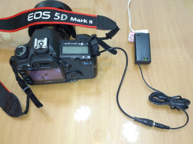

12V轉8.1V轉換器已到貨!最終版本非常靚仔!加上了電源指示燈和用上纖巧的塑膠外殼。我用上自己的5DII作測試,運作正常,沒有問題!大部分的訂戶可於星空小聚時交收。其他的要靠社長幫忙。

No! If u look at 5DII's battery, it is 7.2V. However, if u look at the bottom of 5DII body, it is 8.1V. When u are using adaptor, the voltage is 8.1V. Try to look at the bottom of ur 40D. It should be 8.1V.
For the dummy, there is no need to modify the dummy. Just buy the 350D, 40D & 5DII dummies individually from http://www.taobao.com

昨晚胆敢的试了!还好估计正确,没有调反polarity,是内正外负的。用12V黑砖块电池,40D,整夜未停过,是拍摄time lapse的好东西,真希望这样的产品能够量产。
