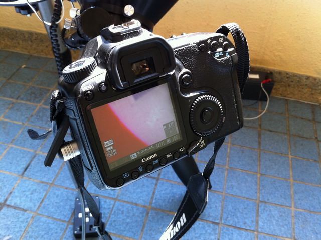

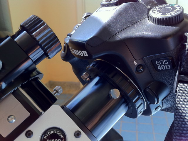

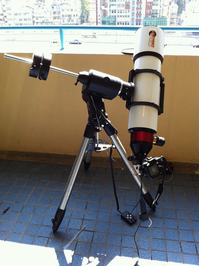

前數天我把Canon EOS40D接駁LS152T和B1800阻隔濾鏡,試試拍攝效果。鏡的口徑是152mm,焦距為900mm。
首先,我發現太陽表面圓盤上毛絨絨的細節在live view中幾乎完全看不到,如果沒有太陽黑子,是很難對焦的。我用ISO100拍攝,發覺曝光要1/10s才足夠。

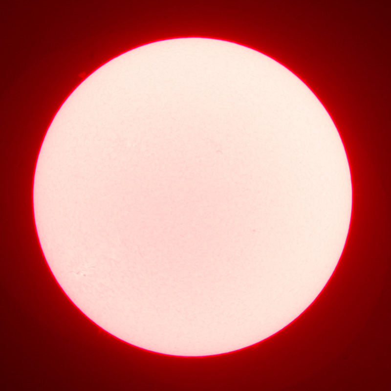

一般來說,太陽邊緣日珥和太陽圓盤需要不同曝光時間。不過你也可以用只一張日珥曝光正常的相,然後用它的綠色通道作為太陽圓盤(可參考Sky & Telescope July 2004)。附圖為原相和處理後的圖,沒有疊相。

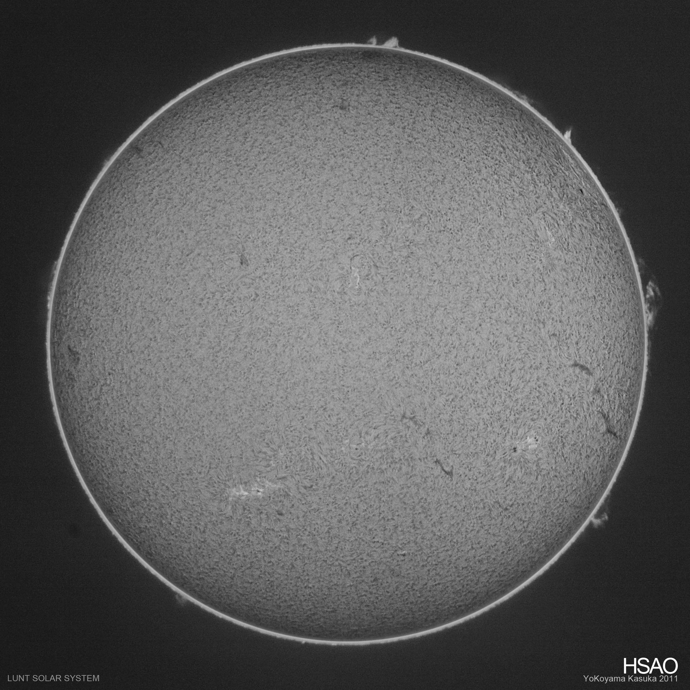

CANON 50D冷卻天文機
像機設定為黑白
DPP處裡輸出
REGISTEX疊圖處裡
PS處裡與合成

wyk 寫:CANON 50D冷卻天文機
像機設定為黑白
DPP處裡輸出
REGISTEX疊圖處裡
PS處裡與合成
謝謝分享,細節很豐富。 :P
能否分享多點資料?例如疊合了多少圖?用了Lunt的那支望遠鏡?曝光時間和ISO是多少?

文章mwtse » 2012-02-04, 19:15
David 寫:一般來說,太陽邊緣日珥和太陽圓盤需要不同曝光時間。不過你也可以用只一張日珥曝光正常的相,然後用它的綠色通道作為太陽圓盤(可參考Sky & Telescope July 2004)。附圖為原相和處理後的圖,沒有疊相。
為甚麼原相會有一個明顯的圓圈在太陽邊緣?

文章David » 2012-02-05, 21:32
mwtse 寫:為甚麼原相會有一個明顯的圓圈在太陽邊緣?
There are a few strange things in such photo.
1. Theoretically, only H-alpha light enters the camera. Then how come there are green and blue signals in the picture?
2. The central part of the sun is dimmer, rather than brighter than the rest of the solar disk.

文章mwtse » 2012-02-05, 22:18
David 寫:1. Theoretically, only H-alpha light enters the camera. Then how come there are green and blue signals in the picture?
May be the filter before the green pixel is not perfect, it allows a small amount of IR to pass though, so the CCD will get some exposure.
David 寫:2. The central part of the sun is dimmer, rather than brighter than the rest of the solar disk.
Not quite understand what you mean??
I just find that, the solar disc is not even in brightness, but the unevenness is not centered at the centre of the sun. Is the sun framed at the centre of the field of view?

文章oldfield » 2012-02-06, 10:37
1. The outer part is brighter since it's overexposed in red (see 2, if you have signal leakage in green/blue, that means you're overexposing red since it should be purely red if properly exposed)
2. The central part is dimmer since it's a result of signal leakage into green/blue channels
