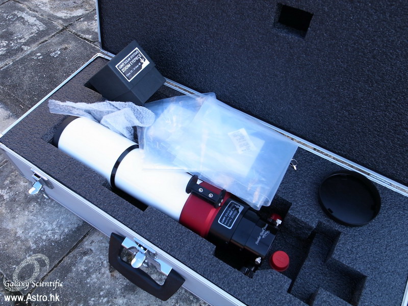

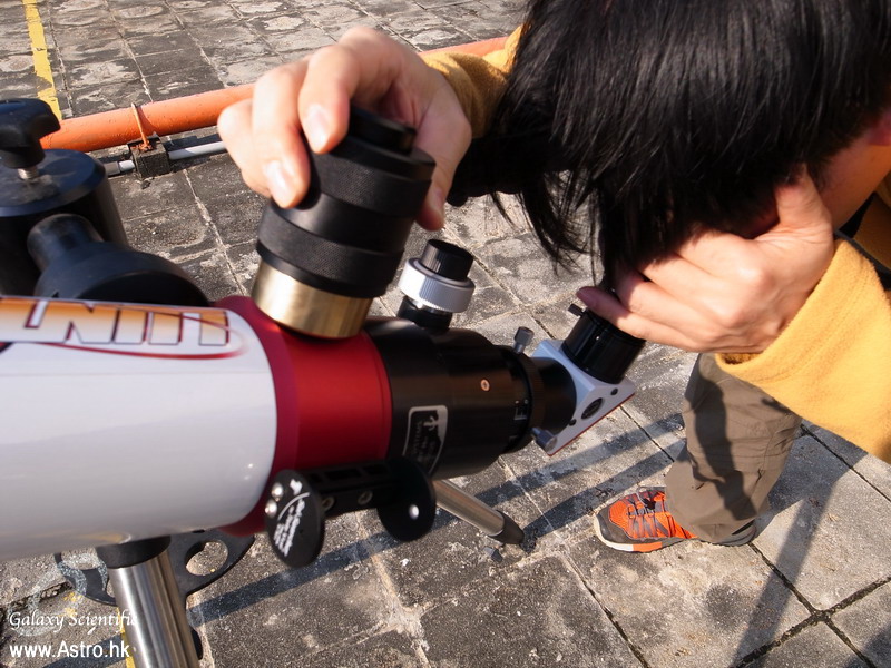

今天兩位同好收到的聖誔禮物 - 兩台剛抵港的 Lunt LS80THa/PT 日珥望遠鏡。

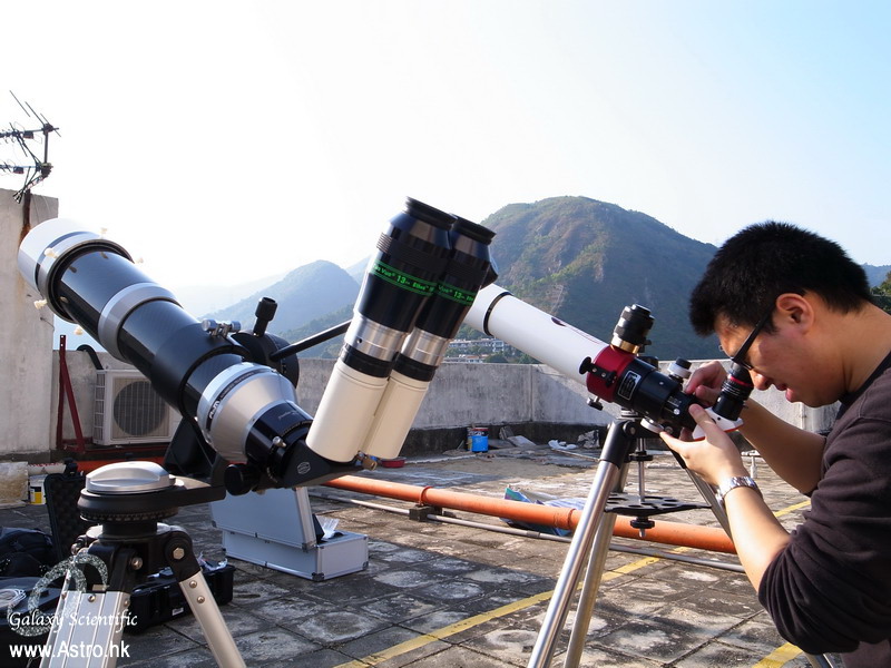

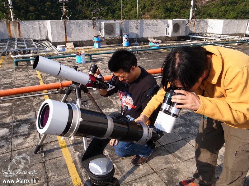

為了解這兩台鏡的性能,我出動自己的 Lunt Signature series unobstructed LS75F 作基準比試目視,及一試LS80T拍攝表現。也感謝我們的資深太陽觀測者David到場指導(他剛完成太空館太陽觀測工作坊)
viewtopic.php?f=6&t=481

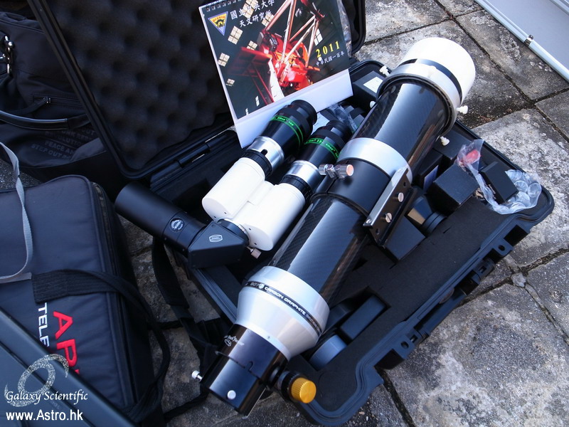

今天出動器材陣容如下:
Lunt LS80THa/PT 日珥望遠鏡兩台,包括羽毛調焦及標準調焦版本 (HK$27336 / HK$23960)
Lunt Signature series unobstructed LS75F 日珥濾鏡 (HK$31880)
Lunt B1200 Blocking filter (轉角兩個及直通式一個)
AM LOMO 80/600 APO 折射鏡
The Imaging Source DMK41AU02.AS 天文照相機
Baader Mark V 雙目裝置

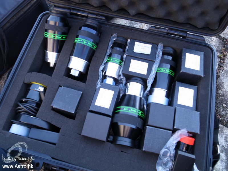

Televue Ethos 13mm 目鏡兩個
Lunt Zoom 7-21mm 目鏡三個
Sky Watcher AZ4 經緯儀
Giro XL 經緯儀

Let me define the abbreviations first. LS80T means Lunt LS80THa/PT. And LS75F/U means AM-LOMO 80/600 and unobstructed LS75F.
LS80T gives you a strong and concrete feeling and LS75F is just a block! Really it looks like a block instead of a filter. The LS80T is a simple grab & go solar scope while the LS75F/U is a bit clumsy.
The tastes of LS80T & LS75F/U are different. Both LS80T & LS75F/U deliver uniform images visually. I don’t have experience in imaging with these two scopes. So I cannot comment the uniformity of photography. Certainly I will produce some images later.
The LS80T gives obviously brighter images. The main reason I guess is because of the bandwidth of LS75F/U is 0.5A narrower than that of LS80T. (The bandwidth of LS75F/U is <0.65A and the bandwidth of LS80T is <0.7A) However, the LS75F/U gives better solar surface details. But the prominences viewed under the LS80T are sharper and brigther.
The newly equipped pressure tune of LS80T is gorgeous! It just likes the Feather touch version of etalon tuning. The pressure tune is firm compared with the mechanical tune of LS75F/U. This sophisticated design makes fine Doppler tuning possible.
Final verdict: If u care about the convenience, go for LS80T. If u care about the surface details, go for LS75F/U. If u care about the prominence, go for LS80T.

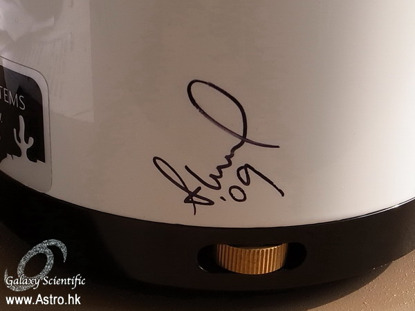

2. LS75F現已停產,而我手上的unobstructed LS75F的精度比常規LS75F高,頻寛也窄些,因為是限量版,全球只造了5片。

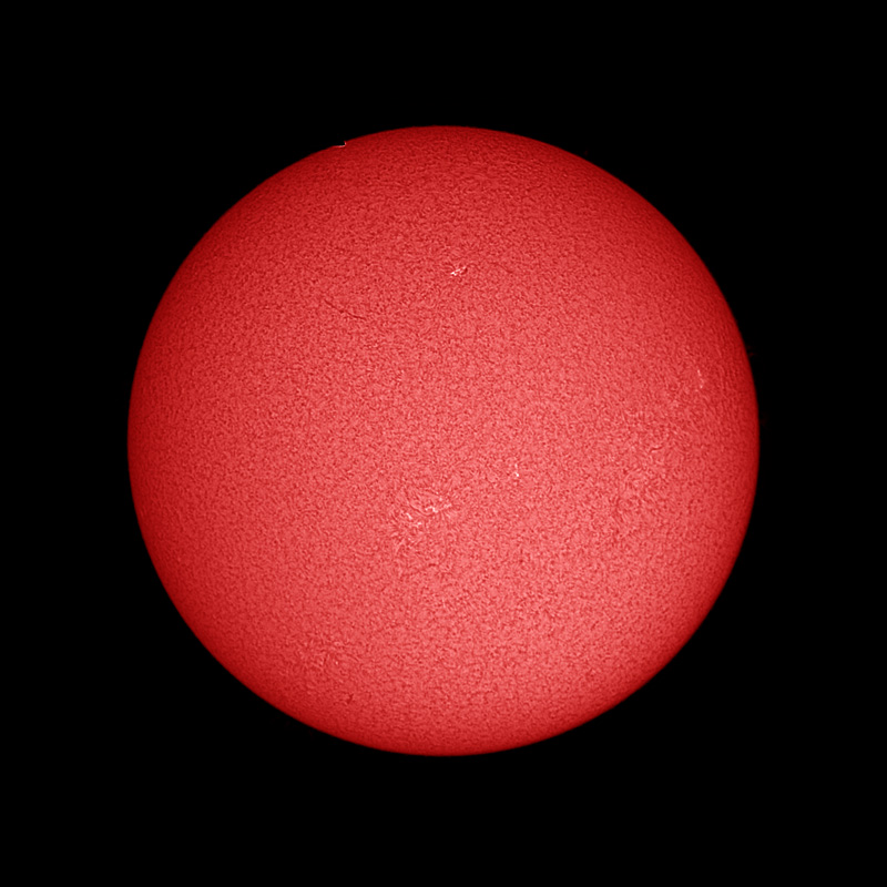

昨天隨意拍的照片,LS80T + DMK41,因為沒有用赤道儀,所以讓太陽漂過視場然後在Registax用"extend"功能以顯示出全日面就算了 8-)
拍攝時約下午4時30分,太陽仰角很低所以視寧度及透明度並不好,但這照片足夠檢視這台LS80T的照明均勻度。

Wow, it is a very uniform image!
The only thing I like about the LS75F unobstructed is the amount of surface details that it shows. If there is a sunspot, I believe it will show much more details. However, for other phenomena like filament and promience, it is inferior to LS80T.

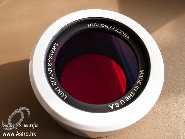

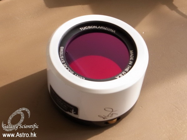

上幾張我手上那片LS75F Signature Series日珥濾鏡,腔振濾鏡內沒有墊片,而頻寛也比一般的LS75F窄一點,約為0.65埃水平。

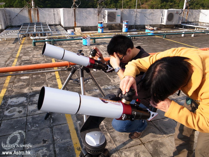

讓我也來分享昨天的所見所聞,其實這個對比非常有趣,除了是LS80T和LS75F之間的對比外,也算是整套太陽望遠鏡和獨立外置太陽濾鏡之間的比較,同時LS80T是一支全新型號的太陽望遠鏡,看過的直至今天也許剛剛只有幾人,而LS75F則是上一代的產物,這也間接形成了兩代太陽利器之間比拼。
首先說說LS80T,雖然昨天的環境因素並不理想,除了大陽本身不算活躍,大氣也不太穩定,但初次從LS80T還是得到了震撼的感覺,在大約30倍觀測太陽的全貌,亮度十分充足,而且對比度相當高,顏色的表現也很結實,不但能輕鬆看出四周日珥,更分辨出很多表面的細節,在利用新設計的壓節器時,能夠分別對日珥和表面的細節進行強調,使到影象更加銳利,經過調較後也顯得較立體一些,在進行80多倍的高倍觀測時,影象亮度仍是十分充足,而細節也稍為突顯出來,並沒有感到明顯的淡化或平面化,表面非常全面。
而LS75F是安裝在一支非常厲害的80口徑天文望遠望鏡上,看上去的感覺都是非常強勁,表面的細節量非常豐富,而且顯得更細膩一點,雖然仍然擁有充分的亮度,但卻顯得比LS80T暗淡一點,色彩上也略為紅一點,從LS75F看出來的影像儘管擁有更多的細節度,但在低倍下,有些LS80T明顯看到的地方,LS75F卻未能突顯出來,能夠被看重同時卻略為整體化,不夠鮮明;但在高倍觀測下,LS75F則是另一個故事,看到的細節開始突顯出來,影像仍然保持非常高的對比度,而且也較從LS80T上看到的略為仔細,不過這時的亮度進一步下降,看起來反而不及LS80T舒適。
綜合而言,其實兩者都在太陽觀測時帶來非常高級的享受,表現上各有一些特色,LS80T擁有較LS75F大的5口徑,並引入了新的壓力調節系統,使到影象更為光亮和結實銳利,而LS75F則擁有0.65較窄的頻寬整合,以獲得更多的表面細節和更細膩融合的影象,確實很難去定個明確高低。
然而,我個人認為在太陽觀測時,高端望遠鏡加上外置太陽濾鏡本身的優勢並不大,若非以必攜性為首要考慮,配合高端望遠鏡下,除了影象的對比度略為高一點和更優於高倍放大觀測外,在口徑差異的影響下,在太陽觀測上並不能絕對優於單獨的太陽望鏡,反而,對比起80APO,LS80T在太陽觀測上得到了更銳利和突顯的成象,也許是LS80T本身的鏡片質量也達到了很高的水平,又或者用於太陽觀測上,調頻系統和濾鏡鏡組遠比望遠鏡本身重要,而不經意間,用於太陽觀測的投資上也無意間得到了優勢。
