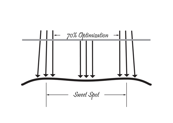

Below is a graphical representation of the performance of an internal Etalon.

Under low magnification the user will note a sweetspot in the eyepiece. If the Sun is placed in the center and an eyepiece is chosen that allows the Sun to be about 40% of the field of view, you should see uniform detail around the entire disk. In some cases the sweetspot maybe slightly off center. This is an unavoidable result of tilted optics and mechanical tolerance holding those optics.
With the Sun at about 40% of view, you will have an dark area around the Sun equal to about a Sun radius..
Moving the Sun around in the field of view you will note that the proms will drop off quickly as the image moves to the edge of the field of view. This is due to the off axis rays becoming greater than the acceptance angle of the Etalon. This is NOT the result of a poorly tuned Etalon (however, you can re-tune to get this detail back at the loss of the center (basically de-tuning the Etalon to match that angle)), or the result of mis-aligned optics.
Note that when you magnify the image you are using a much smaller area of the field of view and will note that the sweetspot quickly disappears as the heart of the system is utilized.
Note: the narrower the bandpass of the Etalon (higher R for narrower bandpass) the faster, or more pronounced the sweetspot.
The image at top (had to get there eventually :) represents the ideal internal system. We try to provide what we refer to as a slight “bird” shape. The Sun would sit within this area provided that the magnifiaction was set such that the Sun was 40-50% the field of view. The center comes down very slighly in order “push” out the sweetspot.
The narrower the bandpass of the Etalon, the narrower it’s acceptance angle. Therefore, lower bandpass systems will deteriorate faster at the edges.
The above deterioration can be ofset by placing a wider bandpass Etalon in the system. ie: if we placed a <.08A Etalon in the 152T, we could increase the sweetspot to 70-80%. Hmmmm, I designed the 152T for high resolution, high magnification viewing. Research of the active areas, and NOT for a quick overview of the entire Sun. That can be done with a 60/PT or a 100/PT. I believe that I would be doing a dis-service to the customer if I provided a systems that worked okay at low mag by simply showing a uniform, if less contrasty Sun, but showed very little detail close up. There’s a reason the University of Hawaii moved the 152T to the top of the volcano and typically use it at 100-200X.
