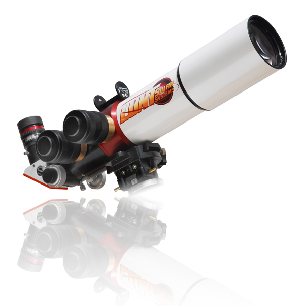

The next generation of Solar telescopes continues to Evolve...
Attached is a picture of the new LS80THa with the internal double stacking DSII. Here is a bit of info... The image is shown with the optional DSII added.
The LS80T/PT (pressure tuned) is a complete and dedicated Solar Telescope with an Image Scale of 408. (Image scale is calculated by the effective image size at the focal plain and the clear aperture of the scope.) A precision aligned ED refractor with a fully un-obstructed 80mm optical aperture.
This package provides a significant step up into the Intermediary category of Daytime Solar Observing, Maintaining the most advanced technology of Doppler True Tuning for fine adjustment of the center wavelength, allowing research of the Sun’s disk and surface details at increased image scale. Prominences, flares, super granulation, filaments, and active regions will be observed.
The LS80THa package is fully upgradeable with several options including the NEW evolutionary Dual Internal Stack Etalon System (DSII). The DSII eliminates the need for an external double stack etalon reducing cost and eliminating obstructions. The system is 100% un-obstructed. The band pass is reduced to <0.5 Angstroms. See the Sun's weather in stunning high definition.

True Doppler Tuning allows for a shift into and away from the user. Adding a 3D like component to the viewing experience.
While it has minimal effect on proms due to their being at the edge of the disk, it does have an effect on filaments and active regions on the surface.
While looking at a filament at the center of the Sun the user has the ability to Doppler shift from the base of the filament to the tip, following the filament thru its structure toward you and away from you. Allowing for enhanced visual and imaging capability for the observer as well as a research tool for the avid hobbyist.
The pressure tuning system provides an order of magnitude more precision to the tuning of the desired features.
No-one brings you closer to our nearest Star than Lunt Solar Systems... The next generation of Solar Instrumentation.

Re: 最新 Lunt LS80T 太陽望遠鏡
文章willis » 2010-08-19, 09:40
Wow! I guess this LS80T will outperform unobstructed LS70F + any APO. Any comment? The price is reasonable too.
文章社長 » 2010-08-19, 09:57
it's LS75F, not 70.
I doubt if anyone can see the resolution or brightness difference between 80 and 75, so it's back to basic again - PT vs Front mounted filter.
But I agree that this version is good for school / education purpose for it's all-in-one design. But note the weight at 14lbs is not light either.
