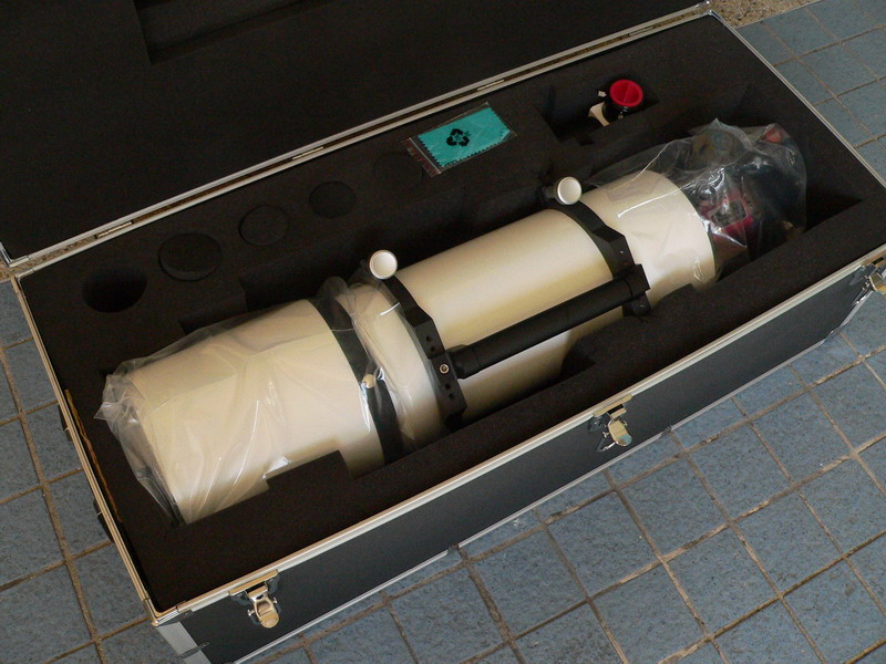

LS152T套裝包括一個黑色鋁箱、抱箍和Lunt 7-21mm變焦目鏡。阻隔濾鏡方面,我選購了較大的B1800。
這鏡的體積明顯比較一般6吋折射鏡細小很多,不需重型赤道儀,因此使用時很方便,一個人便可把鏡裝上。相比口徑相若而且價錢超過HK$100,000的LS160F外置濾鏡,則起碼要接駁體積和重量較大的7吋折射鏡才能使用,相信一定要有固定天文台的富豪或機構才能擁有。

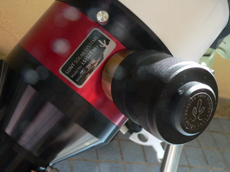

LS152T的鏡身和一支普通152mm口徑、焦距為900mm的折射鏡完全沒有分別 (LS100T的焦距為800mm。),只是在鏡後裝上一個hydrogen-alpha濾鏡單元(Hydrogen-alpha module),這單元包括hydrogen-alpha濾鏡和氣壓調頻系統。
如果想觀察Calcium-K波段,可除去這hydrogen-alpha濾鏡單元,然後裝上一個需另外購買的Calcium-K濾鏡單元 (Calcium-K module) 。如果想作夜間觀星或一般白光太陽觀察,則可除去這些濾鏡單元,裝上合適的調焦系統和適合的白光太陽觀察器材。

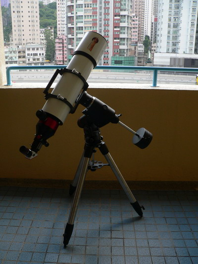

我把LS152T裝上Skywatcher HEQ5Pro赤道儀,需要三個平衡鎚才可達致平衡,目視和拍攝問題不大,但相信使用較大型的赤道儀會較理想。

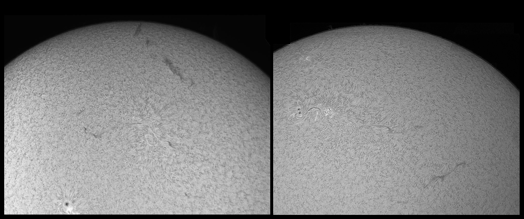

比較LS152T和LS100T的解像度和影像均勻度 (左圖為LS100T的影像)

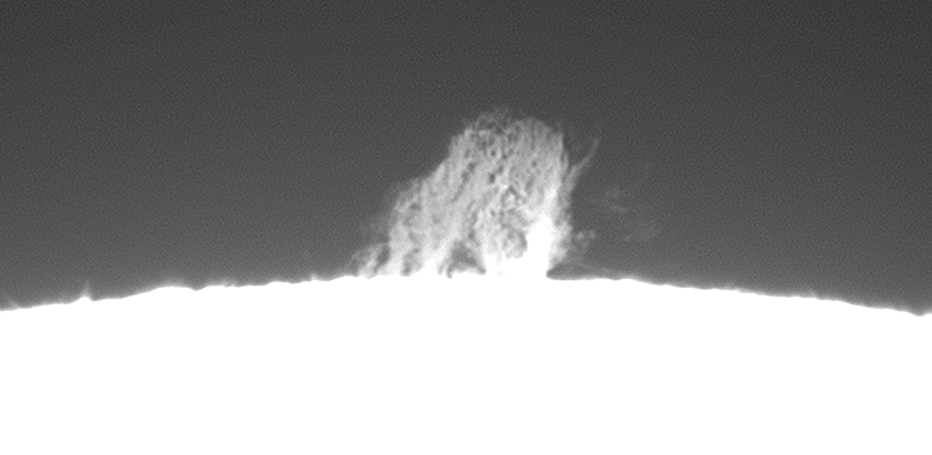

插入DMK31相機進行低倍拍攝,由電腦螢光幕可見,反差和光度的均勻度明顯比LS100T優勝。大口徑的集光力强,這個焦距為900mm的鏡,如果加入2.5x增焦鏡拍攝日珥,曝光時間仍可少於1/100s (當然,這數字也取決於相機的增益設定。),對應付日間較差的視寧度有不少幫助。如果用LS100T加入2.5x,曝光時間仍要接近1/30s。

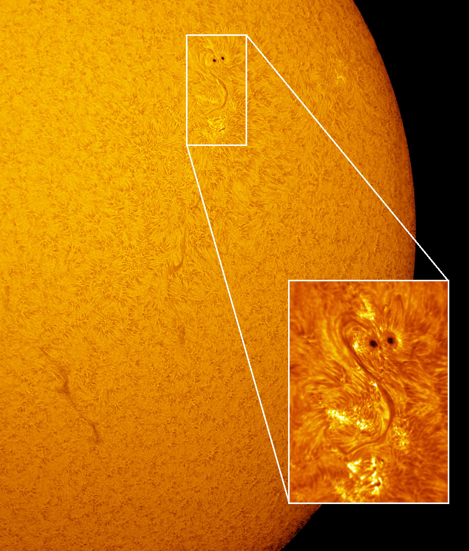

The detail & uniformity are stunning! :o I guess u can make lots of world class solar images with this super rocket! Certainly u can go beyond the well known sungazer:
http://www.sungazer.net/index.html
At the same time, I dare not to post any solar images with my little LS35T... :oops:

LS152 is the largest aperture solar telescope in the market, with an aperture that is only slightly smaller than the largest external filter LS160F. The set arrived in an aluminium case with tube holder and a Lunt 7-21mm zoom eyepiece. I purchased blocking filter B1800 since it is intended for imaging. For visual only, B1200 is good enough according to Lunt website.

The main body of LS152T is no different from a typical refractor. The back side of the scope is fitted with a red component called a hydrogen-alpha module with a 60mm internal filter. It also includes the pressure tuner for adjusting the wavelength.
If one wants to observe in Calcium-K, this module can be replaced by a Calcium-K module which can be purchased separately. If one wants to use the scope for nighttime observation, the module can be removed and replaced by a suitable adaptor. Then one can just add some white light solar observation accessories to view the white light sun.

I went back to lower magnification (75x) to check the uniformity of the image in terms of brightness and contrast. I found that the uniformity was much better than the LS100T that I had used. In fact, as far as I could tell, I didn’t notice any non-uniformity.
Then I tested its performance in photography. Using a DMK camera, the first thing that I noticed was the much better uniformity of the image, confirming my visual impression. The large aperture allowed me to image at very large magnification. With LS152T's focal length of 900mm and using a TV2.5x powermate, I could image a prominence with an exposure time of less than 1/100s (Gain was about 850.) This helped to combat the poor daytime seeing. The focuser of LS152T is the feather touch focuser from Starlight Instruments, allowing very accurate focusing which is important for photography.

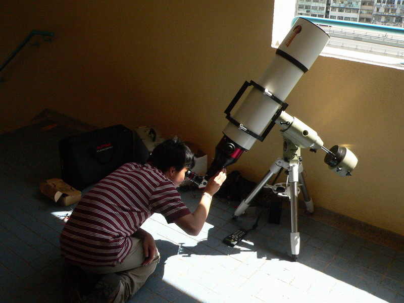

I set up LS152T with a bigger mount a few days ago - Skywatcher EQ6. The whole set up is very stable. Two counterweights can just balance the scope.
Will try to add a binoviewer next time. :D

David 寫:I set up LS152T with a bigger mount a few days ago - Skywatcher EQ6. The whole set up is very stable. Two counterweights can just balance the scope.
the setup is very sexy / handsome / muscular, and it takes a muscular man like you to move it around, but I see your two counter weights are at the end of the shaft.... :?
with such aperture, you can push up to 100x plus, yet you may want to maintain full disk view on that, what about binoviewing 2 Ethos 13 or shorter? I got such feeling after observing with NPL college's LS160F 8-)
