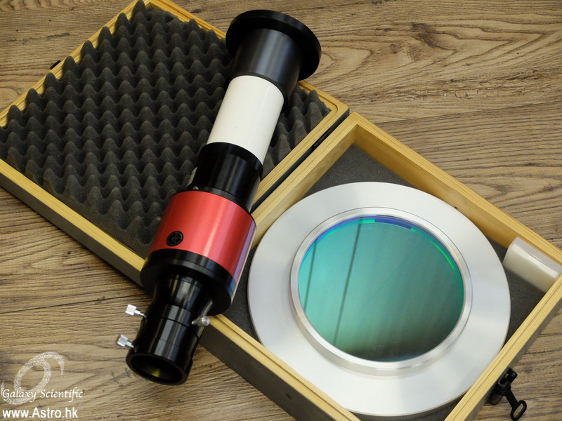

剛剛要處理一個小項目,把用戶的APM-LZOS 203APO 改成Ha太陽鏡,初步看要用以下元件,
180 mm D-ERF > 203APO > 1:4 Telecentric > Blocking filter > Etalon > 天頂鏡及目鏡

我們把手上的APM-LZOS 203 f/7 APO折射鏡轉化成Ha太陽鏡的模組,光路是 : ERF > 203APO > 4x 遠心透鏡組 > 專用的 Lunt LS60F etalon > B3400 blocking filter > 常規天頂及目鏡。

no, with 4x Telecentric, it's 5680mm focal length.
Etalon can only handle a very small incident angle light beam in order to function properly, and that etalon need to be specially picked (not those high or low tuned thing) to be useable in such application.
