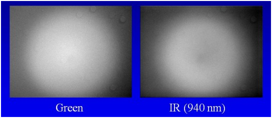

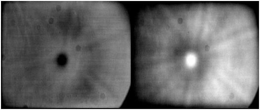

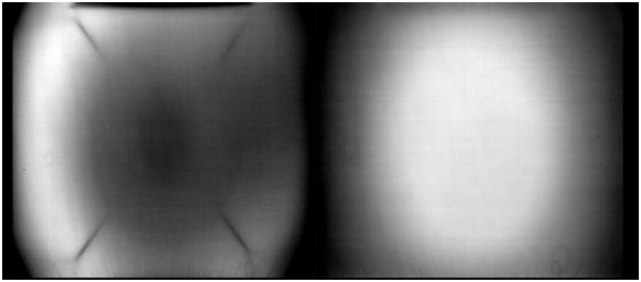

我在自己的家里建造了一个平场拍摄系统,以便能够使用不同颜色的LED光源拍出真正很好的平场文件(使用天文望远镜,和CCD相机)。拍摄器材包括:不同光波长的LED灯,内部涂成黑色的大的亮场盒(制作均匀光源的盒子),F6焦比的望远镜。图一的平场文件是用一个大家拥有都觉得很牛X的昂贵的折射镜拍摄的,使用近绿光和IR(940nm)的光。这个系统拍摄的平场完全没有任何渐晕变化!左边图像边缘看上去像是渐晕变化的部分其实是中部过多的光被与相机连接的转接环反射的结果。右边图像圆环状的部分也是同样的转接环反射的结果。

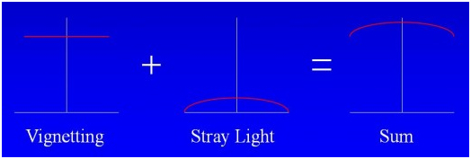

The center to edge variation here is about 6%, which would require flat fielding in an astro-image. The problem is light pollution for most people means that their sky at night is a greenish yellow color, but if they took a flat field using a flashlight with an incandescent bulb, which has strong IR, the astro-images would have an inverse donut illumination pattern. There is another concern here. Many astrophotographers are doing photometry with their systems, and quite often compare two stars in different parts of the field to make their measurement (differential photometry). They would flat field their data assuming the pattern seen in the green image was vignetting, which means a sensitivity dropoff at the edges, but it is not. Sensitivity is actually constant to the edge. Figure Two illustrates this problem.

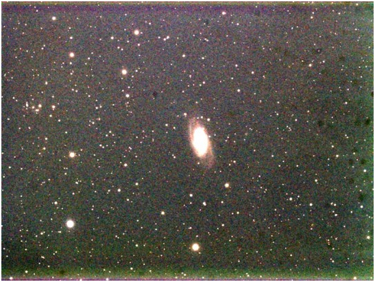

图片中,中央到边缘的亮度变化大约是6%,这在天文照片上是需要叠加平场文件了。问题是,对于大多数人来说,光污染意味着,他们的夜空是黄偏绿的颜色,如果用白炽灯做光源拍摄的平场,因为白炽灯含有强烈的IR光线,天文照片会有反向的圆环状特性。还有另外一个问题。许多天文摄影人使用他们的系统做光度测量,并且经常需要对比照片中不同部分的两颗星来进行测量工作(示差光度测量)。他们会对照片做平场处理,因为他们认为绿色的照片肯定是渐晕的,在照片的边缘会有微弱的减光,但实际上不是这样。边缘的感光度跟中心部分是一样的。图二演示了这个问题。
Figure Two: Stray Light looks Like Vignetting
图二:漫射光看上去有渐晕
This actually occurs with photometry. To properly map out the sensitivity of the image one must move a star around the field and measure its brightness at many places. Or, eliminate the stray light!
这是在做光度测量时的实际情况。为了适当的映射照片的感光度,必须把一个星点在照片不同的地方做测量,或者,消除漫射光。
The stray light, particularly in the infrared, is usually caused by the manufacturer using black anodized aluminum surfaces in the telescope. Black anodized surface have about 50% reflectivity at 940 nm. Figure Three shows a number of "black" objects at 940 nm, as well as a white business card. You "see" the problem, literally. Truly black surfaces would be as dark as the interior of the nosepiece on the right side of the image.

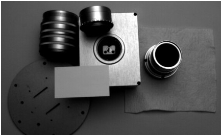

漫射光,尤其是近红外部分的,通常是因为设备制造商使用黑色阳极氧化铝做表面。黑色氧化铝表面对IR(940nm)部分仍然有50%的反光。图三展示了一些“黑”色的配件,还有一张白色的名片。你看,问题在于,真正的黑色,应该像右边的接环中间部分的黑色一样黑。

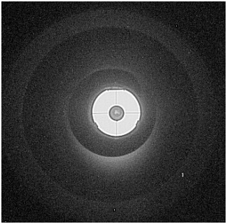

很容易检查你是否存在这些问题。使相机对着天空或白色表面,略微失焦,然后取下相机,观察镜筒。你看到的是,望远镜的光圈被黑色的虚空包围。我使用的是拍图一时使用的豪华高端APO,我看到的就像图四所示。

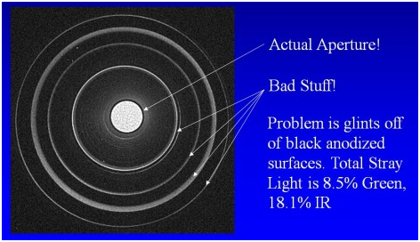

As you can see, I had lots of glints off the coupling rings. I made a special camera for taking this image by modifying an ST-3200 to have a 6 mm F/12 focal length pinhole lens right in front of it. It was revealing, once again literally. Below I show the results for a Chinese Newtonian telescope. You can see the aperture and the secondary spider in the middle. However, that glow around it is 13% of the total light hitting the focal plane at 940 nm.
就像你看到的,有很多双环亮光圈,我使用了其他的相机和牛反望远镜也做了拍摄,效果如图五

I know many of you are thinking "Why do I need to worry about this – the sky is dark?" The answer is, it’s not. You are pointing your telescope into a hemisphere of light. It may be dim, but so is what you are imaging. In fact, for the high end refractor, the fraction of the skylight that you want to hit the chip is only 1/7300th of the light entering the lens, and you want to knock down that unwanted stray light to the 1% level, or almost a million times total.
我知道你们许多人会想“为什么我要担心这个问题-天空是黑色的?”回答是:不是的。你的望远镜指向的是一个光半球。天空是暗谈的,这就是你拍的东西。事实上,就算是高端的折射镜,透过望远镜镜片的光线,只有1/7300投射到了CCD芯片上,你肯定想把不需要的漫射光减少到1%的级别,或者几乎十千万分之一。

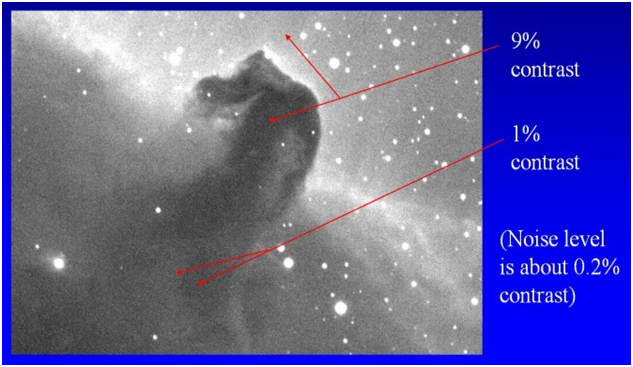

The other important part of this issue is that deep sky objects all have very low contrast against the sky background. Figure Seven shows a picture of the Horsehead Nebula captured by Tony Hallas with a luminance filter on a dark night from a good sight. Note that the interesting features require detection of objects at the 1% contrast level, and world class work like Tony’s reveals features down to 0.2% and less. By the way, the brightness of areas of an astro-image are easily measured using CCDOPS Crosshair mode.
该问题另一个重要的部分是,深空目标与天空背景的对比度很小。图七展示了托尼.哈拉斯使用L滤镜在一个很好的拍色地点拍摄的马头星云。请注意:图片中如果有能引起兴趣的东西,需要至少1%的亮度差异,托尼作为世界级的高手可以做到0.2%甚至更低。图片中区域的亮度可以用CCDOPS的十字模式轻易的测出。

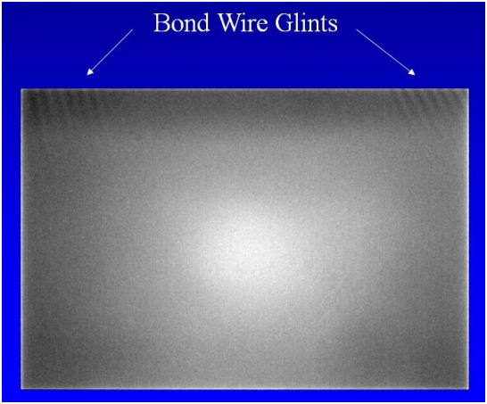

I may have led the user to believe that with a simple can of spray paint his problems are solved. As with most things in life, it is not quite that simple. I have made some effort to determine the limits of CCD cameras to detect low contrast objects, and have found that at the 1% level the CCD itself has spectral variations of sensitivity across its surface. Note Figure Nine, revealing bond wire glints. Light reflects off the gold structure and bond wires at the edge of the CCD, then reflects off the CCD cover glass, and produces this effect. Figure Ten shows a Single Shot color ST-8300 image of a galaxy from a light polluted sight with the contrast pushed, showing further evidence of the metallization changing the color of the sky background near the upper and lower images of the image. All of you reading this paper have this problem – check your images.
并不总是仅仅涂黑的问题!
我可能已经误导用户认为用一小罐涂料就能解决他们的问题。就像我们日常生活中遇到的其他问题一样,事情远远不是这么简单。我曾经努力去确定CCD相机在探测低对比度物体的能力极限,发现在1%对比度的级别上,CCD相机的芯片表面存在不同地方光谱敏感度不同的情况。注意图九,揭示芯片结合线(半导体封装时的焊线)导致的不正常亮度变化。芯片边缘的芯片焊线轻微的反射了CCD玻璃表面的光,形成了这种效果。图十显示了ST-8300C在一个有光害污染拍摄的星云图片,进一步显示了芯片金属焊线造成的天空背景颜色变化,在图片的上、下部有明显的痕迹。所有读这篇文章的人都存在这个问题-检查你们的照片。

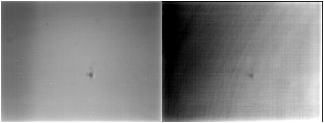

有时候是CCD自身存在问题。许多用户在不断的接近极限,他们在东京或者北京拍摄,哪里的深空目标与天空背景的对比度要比托尼.哈拉斯应付的恶劣50倍。图十一显示了会发生什么,一张STL-11K拍摄的绿色通道平场,和右边一张STL-11K拍摄的红色通道的平场。注意绿色通道平场中心部分的的冷点,在红色通道平场中变成了热点。像这样的问题在拍摄平场的时候是没有办法回避的,哪怕是使用超级理想的平场光源。很不幸,有这样问题的芯片不会被柯达(现在是TrueSense)认为是有瑕疵的。发现这个问题后,我调查 了产品线上的几台STL-11K,发现,对于这种程度的效果来说这确实是一个不常见的相机。然而,这些问题在程度上有1%的变化,位于CCD的中央也不是那么的引人注目。

大多数的业余爱好者使用LRGB方式拍摄彩色照片。一直存在一个讨论:是否应该用放通所有波长光线的C滤镜,或者用带红外截止功能的L滤镜来拍摄L图像。注意图十二,下面的平场使用流行的KAF-8300CCD拍摄。绿色通道的平场在左边,除了几处灰尘痕迹,看上去很平整。右边的平场是用较多IR 光的LED做光源拍摄的。注意右边光滑的亮部,这是较多的IR光线投射到了芯片上,这增加了整张照片从左到右的的亮度变化,照片被明暗分隔成网格状的情况更明显了。两张照片都是全尺寸的10%。芯片没有问题!
