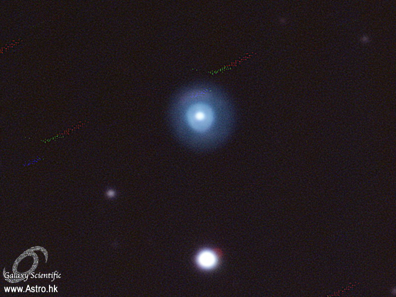

社長 » 2010-12-30, 09:26
這個NGC2392叫愛斯基摩星雲,因為外形像穿了皮草的愛斯基摩頭像,在中型望遠鏡下也十分光亮及看到一些細節,十分可愛的。
這幅照片僅以203APO接上Canon 5D Mark II,及用了LPS-P2濾鏡,以ISO1600曝光30秒便成,因為表面亮度高,所以在我上水自家天台這種北極星僅見的天空下也可輕易拍到。
因為星雲本身細小,只有0.9x0.9角分,即與木星大小衝日時相若,所以用1420mm焦距拍攝也有點力不從心,而且也很受視寧度影響。
先上張單張中央局部截切,300%出圖,稍後發表疊加圖。
Eskimo GS.JPG (56.06 KiB) 被瀏覽 8520 次

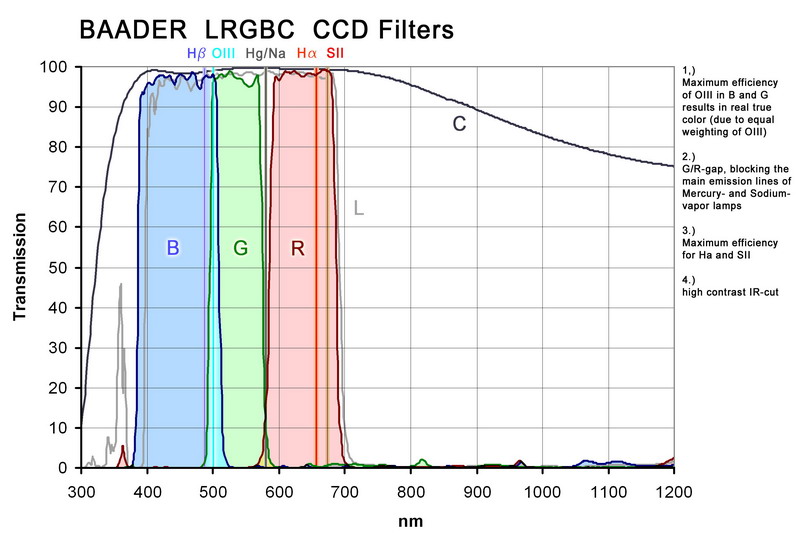

that's my thought after "process" this, may be I will use DMK41 with Baader RGB filter, that's the same filter and filter wheel I used for Jupiter imaging.
viewtopic.php?f=16&t=43
The Baader RGB filter is perfectly parfocal, and have a nice tranmission gap to cut off light pollution while have max transmission at key spectrum lines, so well suit for deep sky imaging also.
I prefer DMK41 for it's 4.65um (vs 5.6um of 21 series), a bit oversampling may be better for this tiny nebula, so I can use resampling method to process it in Registax.

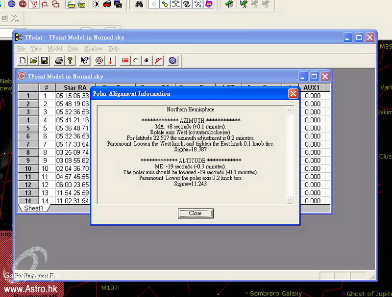

I spend a hour or so yesterday to run the T-point and now the Paramount polar alignment error is <0.3arcmin, pointing RMS is 61arcsec. So you can imaging the efficiency of this setup - slew to the object by GOTO, and the object is at dead center of the camera, use IC capture of DMK camera and record a short video of may be 30 frame x30sec exposure (max exposure of DMK is 1hr), and then process in registax. Actually I image a few objects with 2hrs this morning.

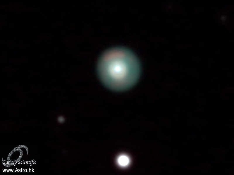

先來一張今晚用DMK41拍的吧,一時沒想到用Registax處的先天限制,出現了RGB噪點.... :oops:
Copy of 2010-12-30 Eskimo DMK41 RGB ver1.JPG (138.61 KiB) 被瀏覽 8487 次

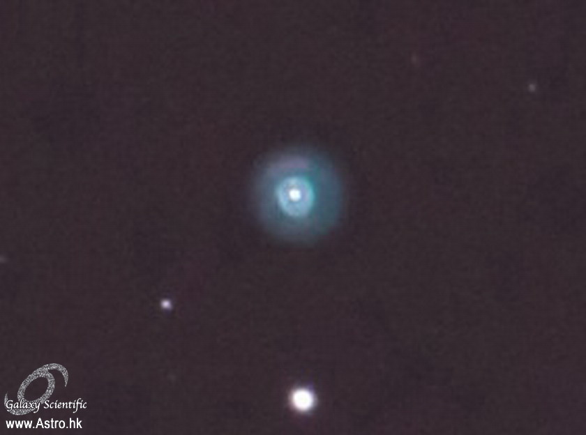

再來一張昨晚用5D Mark II配LPS-V4拍的,65x30sec @ISO1600,或許要多做些後期處理,或疊加少些,以帶出那些草皮的細節,因為在個別幀中是看到的。
照片中央裁切,300%出圖,沒平場沒暗場。
Eskimo ver3.JPG (40 KiB) 被瀏覽 8480 次
