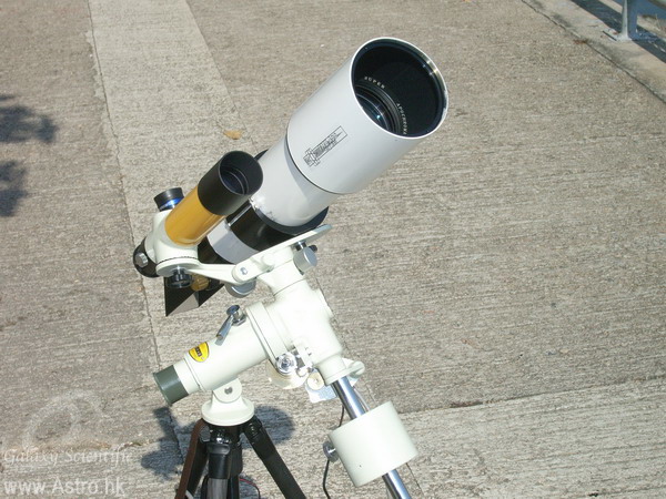

APM-TMB 80/480
TV 0.8X Reducer/Flattener
AstroTech Flattener (zero power)
Guide scope (modified Takahashi finder scope)

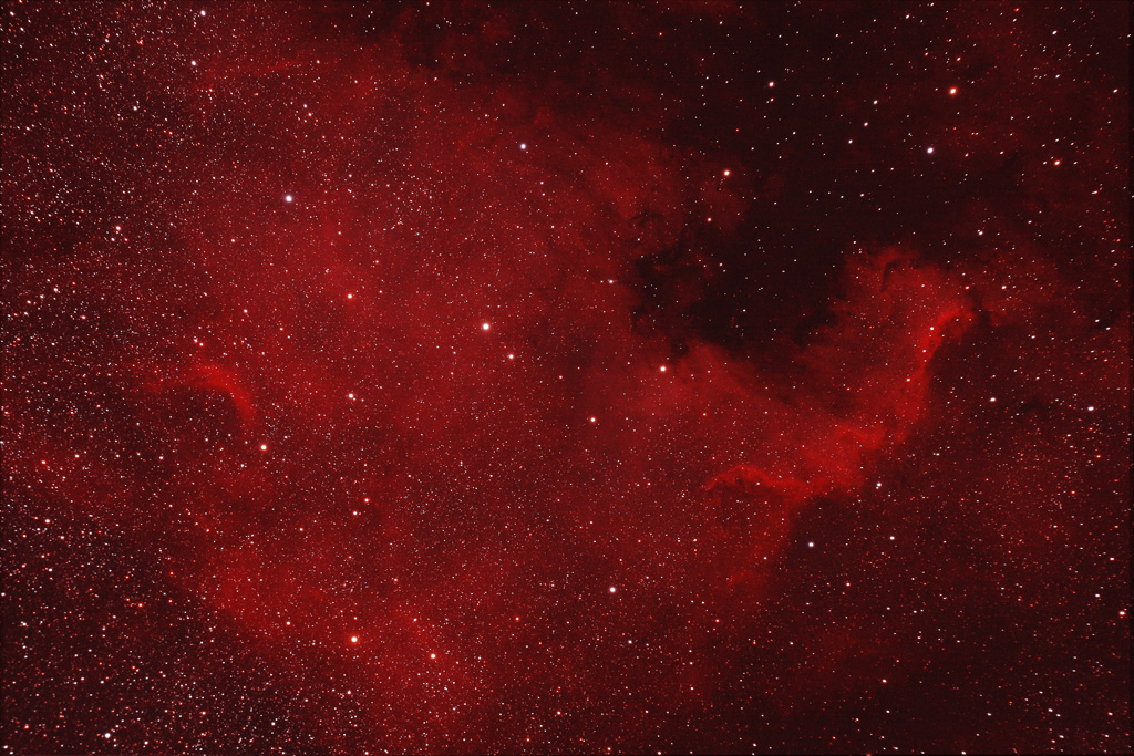

North America Nebula: (North America Nebula _APM80480_AstroTech_6x4mins_PS_1024x768.jpg)
APM-TMB 80/480
AstroTech zero power flattener
Baader LPS-P2
ISO 800
6x4mins
No flat field
No dark frame

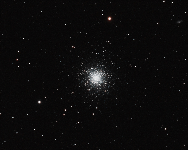

M13: (M13_APM80480_AstroTeach_9x6mins_2_centre.jpg)
APM-TMB 80/480
Baader LPS-P2
ISO 800
9x6mins
No flat field
No dark frame

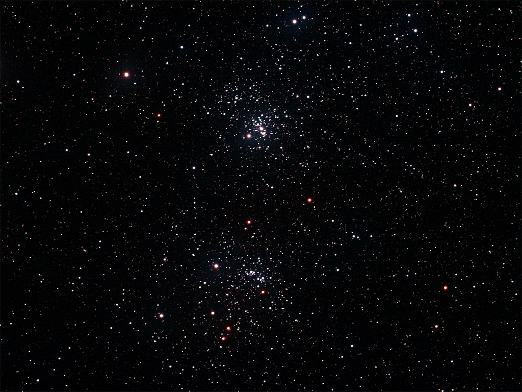

Double Cluster: (Double Cluster _APM80480_TV0.8_2x3mins_3_1024.jpg)
APM-TMB 80/480
Baader LPS-P2
ISO 800
2x3mins
No flat field
No dark frame

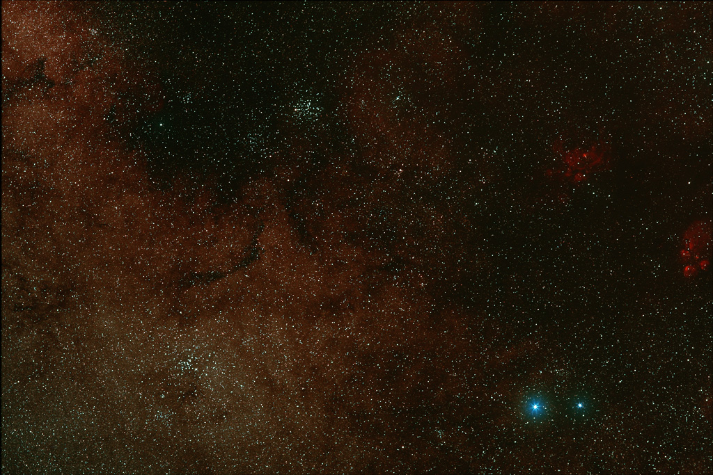

Scorpius M6 M7: (Scorpius M6 M7_135_PS_1024.jpg)
Canon 135mm f/2.0 @f/2.8
Astronomic CLS clip-filter (CCD version)
ISO 800
10x3mins
No flat field
No dark frame

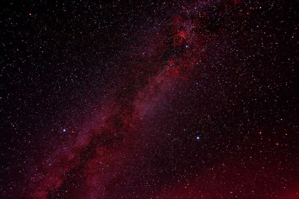

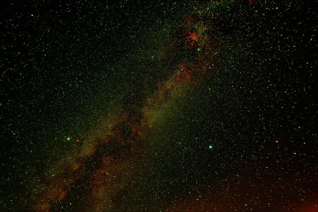

Milky Way: (IMG_9622_PS_25.jpg)
Tokina 11-16 f/2.8 @11mm & f/4
ISO 1600
30s
No flat field
No dark frame
Milky Way
Double Cluster
Double Cluster _APM80480_TV0.8_2x3mins_3_1024.jpg (786.97 KiB) 被瀏覽 19728 次
M13

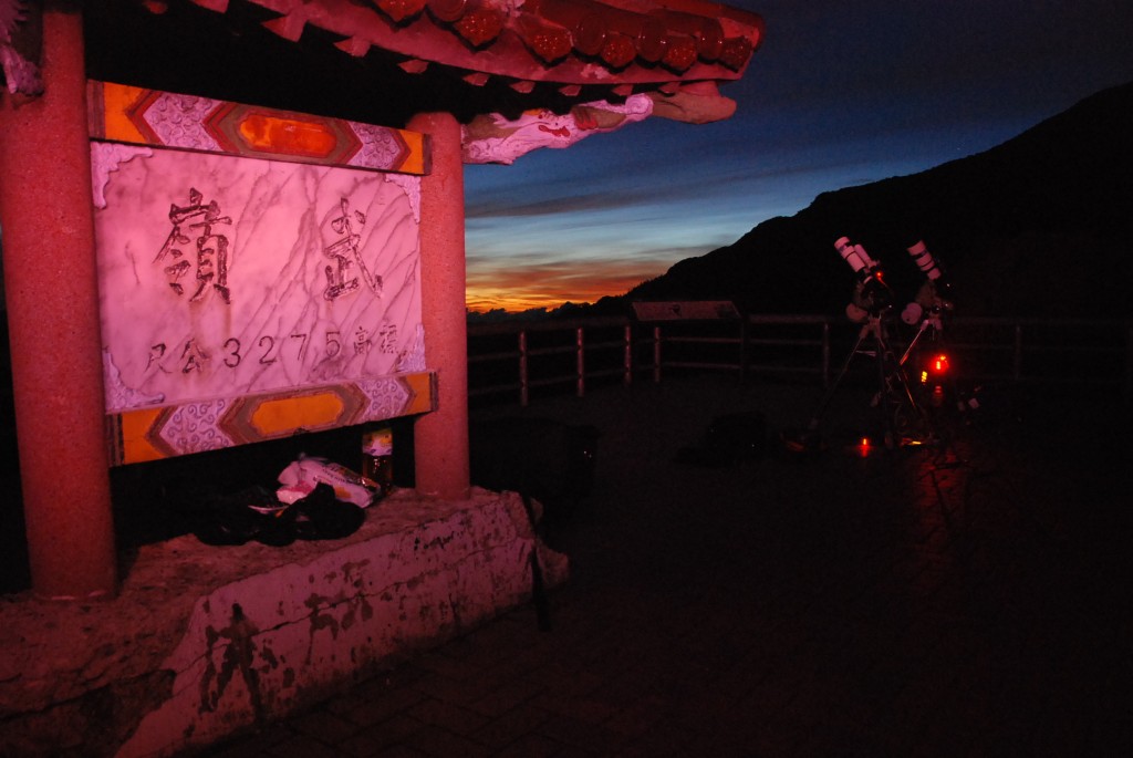

Clouds below our legs
Hehuan Mountain's daybreak
武嶺 3275m

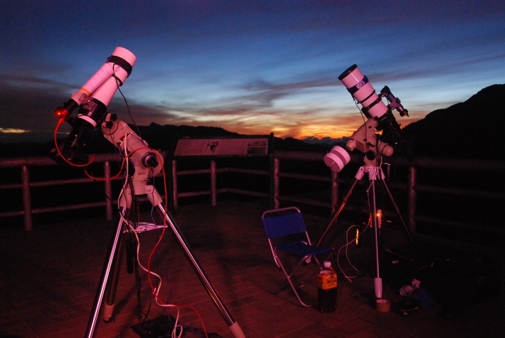

APM-TMB 80/480 & APM-TMB 105/650
Balcony view

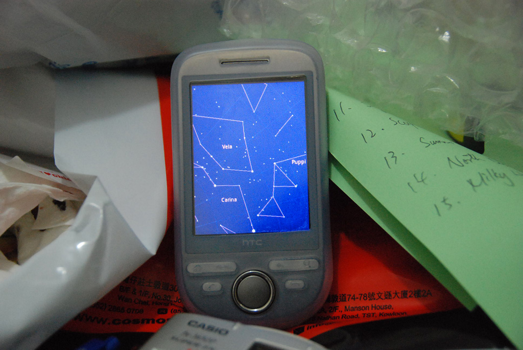

跟阿炫介紹上山的朋友借電子羅盤對北極星,北極星馬上就在極軸內,挺方便的
然後~~~這幾天就有幾個朋友來問我了~~我根本不知發生什麼事?哈哈哈~
是不是你啊?帶了什麼神兵利器?台灣朋友一直問我到底是什麼東西?

Both 社長 & I didn't talk to any people in 武嶺。 May be someone saw me while I was using my mobile phone to locate stars. My mobile phone is a smart phone which uses Android as the operation system. The program I used is call "Google Star Map". All Android phones can run this program. It can help us to locate stars. The attached photo is my HTC Tattoo. In fact there are lots of Android phones can do it. Say HTC desire, Motorola X10, Samsung Galaxy S etc. u can browse this link for a demo of Google Star Map.
http://techcrunch.com/2009/05/12/google ... the-stars/
HTC Tattoo.jpg (232.39 KiB) 被瀏覽 19660 次

- 應在香港再次挑戰一下 M13

很欣慰看到你首次正規出擊拍攝深空便有此成積,很明顯,調焦、追蹤、構圖、環境已不是任何阻礙,有很多愛好者在這幾點上隨時掙扎經年的,而你現時只餘個別濾鏡及系統組合、曝光等操控而已,可以想像,你下次出擊的作品水平會是相當高的 :P
