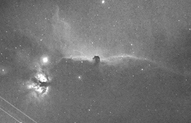

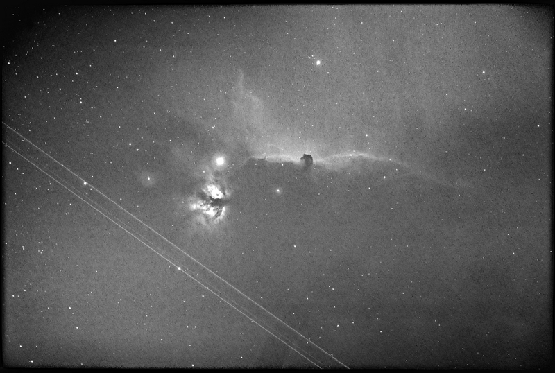

Scope: FSQ 106+ 0.73x QE reducer
Mount: Skywatcher NEQ6pro
Filter: H-alpha Filter
Camera: Canon 450D (Modified)
Guiding System: LVI II
Guiding Scope: 350mm guide scope (A modified 9x50 finder scope)
ISO 800: 1200 sec
ISO 800: 900 sec
ISO 800: 600 sec
Total: 2 hr 16min 43sec
Flat frame: Yes
Bias frame: Yes
Dark frame: Yes
Place: Dongguan ChaShau
今次就主要試用 H-alpha 拍攝效果,能否敵過光害。當晚煙霞強勁,能見度低[Orion 只能看到七粒主星情况下],而且氣温很高。半夜都不冷,我 450D 應該很多 noise!只要玩嘢之作!好過無啦! :?
Horsehead 450D Neq6pro LVI II FSQ106 reducer 2hr16min43sec halpha closeup V1.jpg
Horsehead 450D Neq6pro LVI II FSQ106 reducer 2hr16min43sec halpha closeup V1.jpg (256.05 KiB) 被瀏覽 4713 次
Horsehead 450D Neq6pro LVI II FSQ106 reducer 2hr16min43sec halpha V1.jpg (261.2 KiB) 被瀏覽 4713 次

文章willis » 2011-12-29, 10:17
There was star elongation in one direction. Did u see any guiding error from LVI's curves? Is it the 0.73x QE reducer from Tak? The vignetting is obvious. Or did u stretch the curve too much?

文章社長 » 2011-12-29, 11:13
funoooo 這照片可塑性很高的,繼續累積曝光時間吧,但建議曝光時間不要太短,也不要用不同曝光時間的疊加。
用單反就算是改了濾鏡的拍Ha效率是低些的,因為只有1/4像素能感光,所以真的要5到10小時以上才稍後看頭,你的f3.7光圈已算快了。
看我在西藏的環境,f6.2配黑白CCD也要拍7.5小時才成這樣子,你要更長時間才可達到同樣的訊噪比了:
