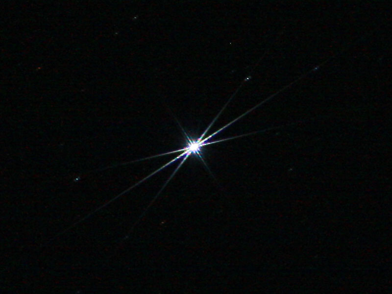

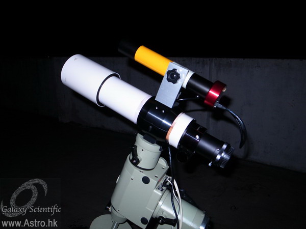

Due to family gathering, Lewis & I arrived Sai Kung at about 00:00 last night. The sky condition was clear when we arrive, but after we setup the equipment, all the clouds started to run around! Together with the annoying moon, it is hard to shot any DSOs! Anyway I tried the North America Nebula, but failed! The P2 has no use in this situation. After that I tuned the target to practice the equipment. I picked the area around Deneb because the Cygnus is taking a bath in the Milky Way. May be I can photo the background color of Milky Way. However, I failed again. Anyway, I practice the focusing & auto guiding. Without the electric Feather Touch focuser, this is what can be done with a stock Equinox dual speed focuser, see focusing.jpg. The focusing star is Vega. About the auto guiding, this is the first time I used the China made 220mm refractor to guide a 500mm. From LVI’s real time guiding curves, I know that there is 1 to 2 pixels error in the guiding scope. This which means there should be some star elongation. Indeed the photo showed this. According to my previous Taiwan trip experience, this may be due to poor balancing or poor cables arrangement in the setup. Perhaps the focal length of the guide scope is not long enough compared with the main scope. The pixel error in the guide scope may be amplified in the main scope’s image. Anyway, the bloody clouds didn’t allow me to find the reason out. The clouds just cover the Cygnus area from time to time and so as my guide star, Deneb. At about 03:00, we gave up. When we just finished packing up all the equipment, it started to rain! We are so lucky!
Equipment:
Equinox 80ED
AstroTech Flattner (Zero Power)
50mm China made refractor of 220mm focal length as guide scope
HEQ5Pro
40D
P2
LVI
Deneb, 3 mins
Using focusing mask, Vega

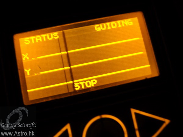

正如9月份Sky & Telescope測試導星器中也提到一句,導星的實時表現也有其功效。Willis你在台灣對這個感受良多了,其實很多時拍深空時,星點拉線並非單純導星問題,例如導星鏡支撐的剛性問題、平衡、陣風等也是另一因素,而LVI的XY軸實時導星表現就是那麼重要,幫你實時診斷問題,而非事後完成曝光才發現有事。

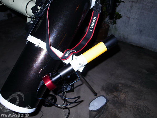

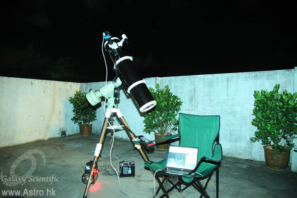

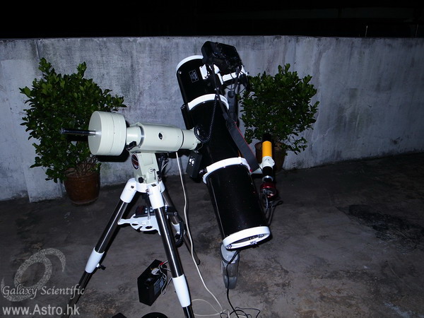

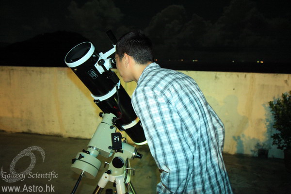

工作坊昨晚繼續進行,我和David到了石澳,可清晰看見天蠍人馬的銀河核心,以及天鵝天區隠約的銀河。
昨晚可說是大豐收了,我和David主力測試兩台自製150口徑牛頓反射鏡,一台是他04年自行磨製,花了數十小時才完成拋物面的。另一台是我指導澳門一所中學磨鏡班,其中一張作品。
viewtopic.php?f=6&t=286
viewtopic.php?f=6&t=73

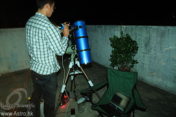

我們昨晚的流程如下,見照片:
- 到埗後首先以澳門中學自製望遠鏡拍攝M8,主鏡焦距924mm、導星鏡為高橋40/240導星鏡,另加2x巴羅配LVI導星
- 之後David用他的APM-LOMO 80/480配TS2平場鏡及LPS V4濾鏡拍攝北美星雲,追蹤簡直是完美的,從沒看過這樣的LVI心電圖,David甚至懷疑LVI是否壞了,嘗試用手遮擋導星鏡,馬上Star Lost,確認沒問題 :mrgreen:
- 然後用澳門中學自製望遠鏡觀看木星,在Lunt 7-21 Zoom目鏡下表現出色,換上TMB Supermonocentric 6mm,細節進一步提升,到4mm的230x下,對比度有些柔化了。再指向天琴座的Epsilon double double雙雙星,四顆緊密雙星完全分解,之間呈現漆黑天空背景,清晰可見第一衍射環。第一次自製望遠鏡的作品水平如此,絶對理想了。
- 最後我用澳門中學自製望遠鏡觀拍月面及木星、David用他的自製150反射鏡拍月面。
