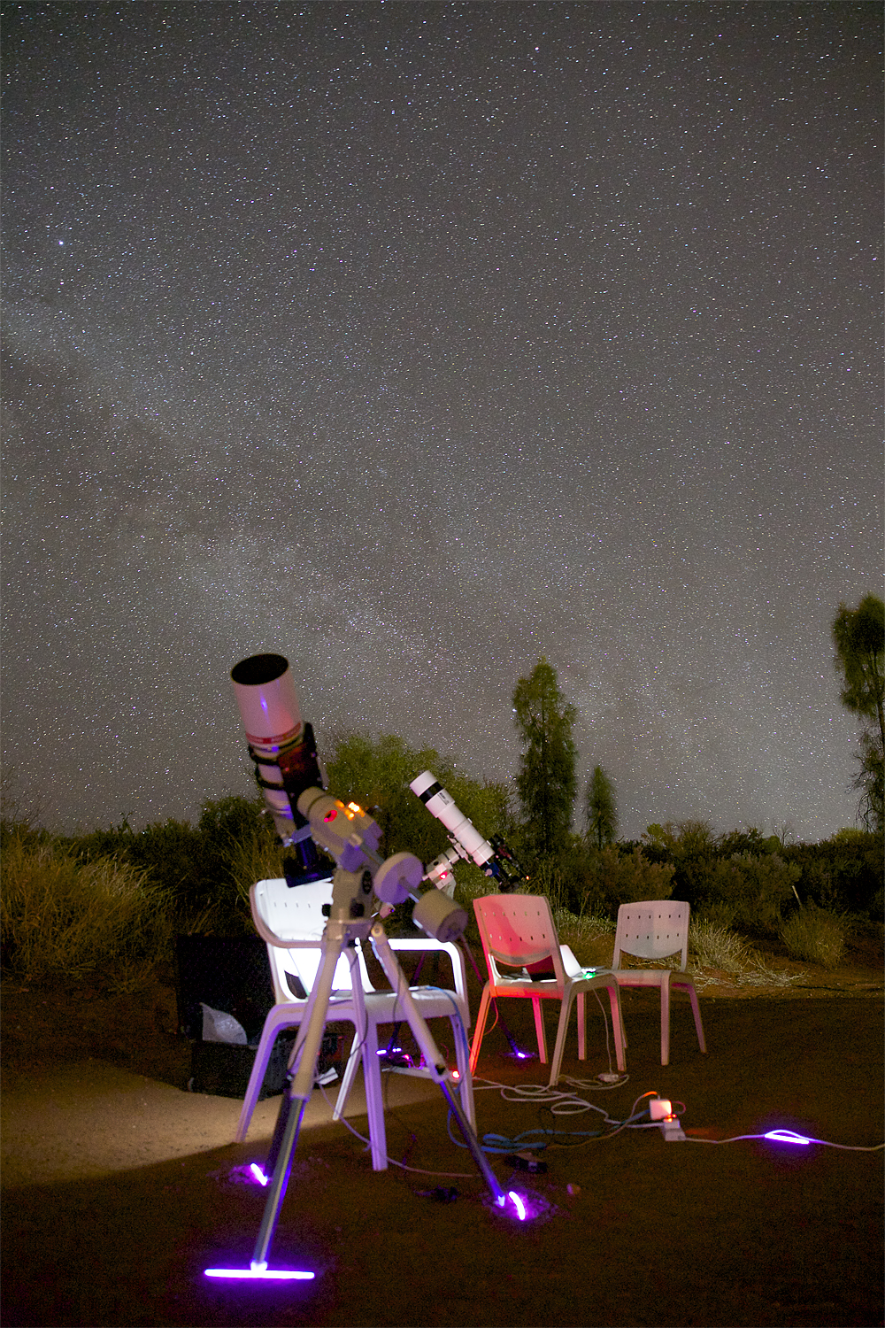

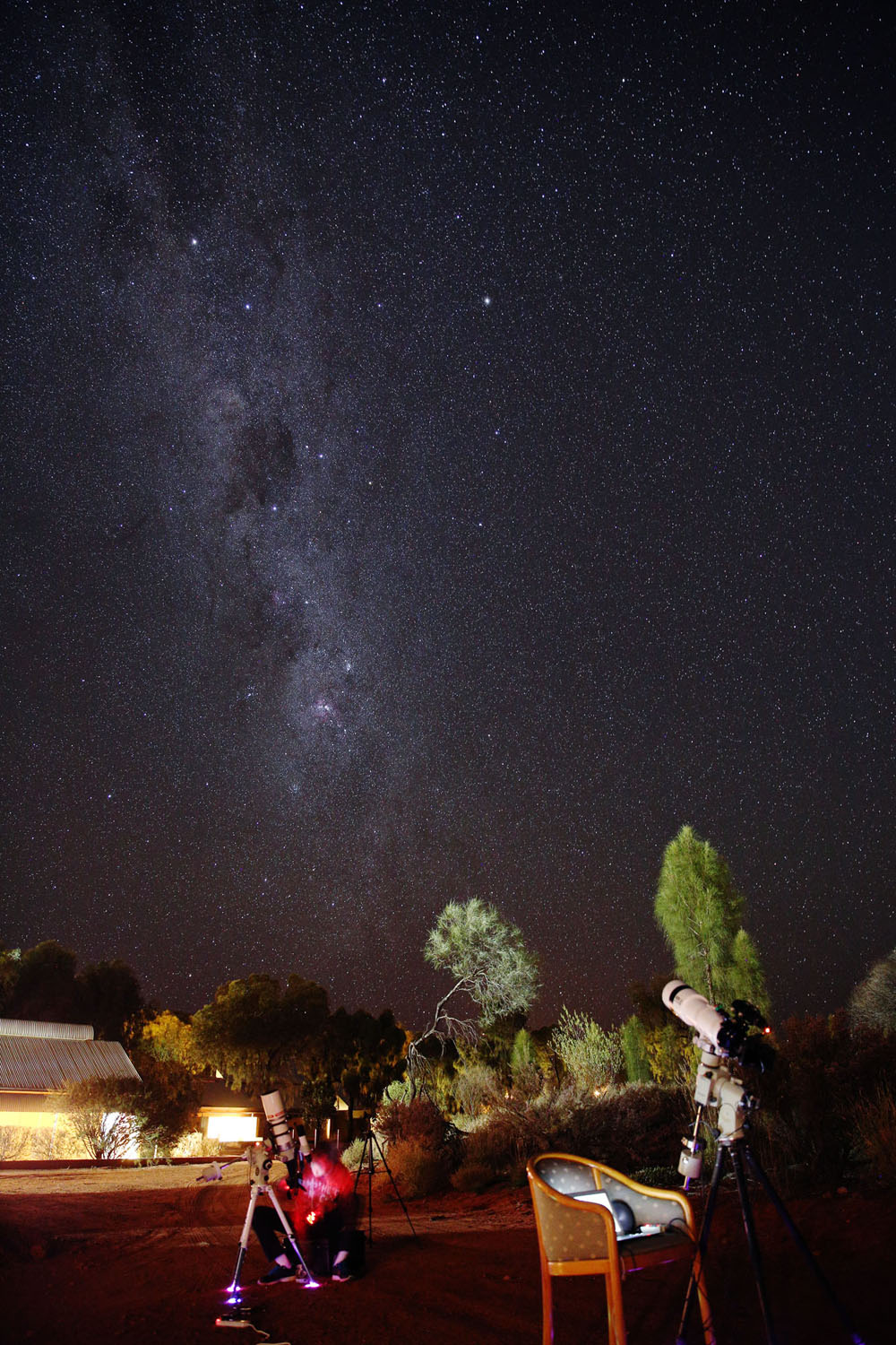

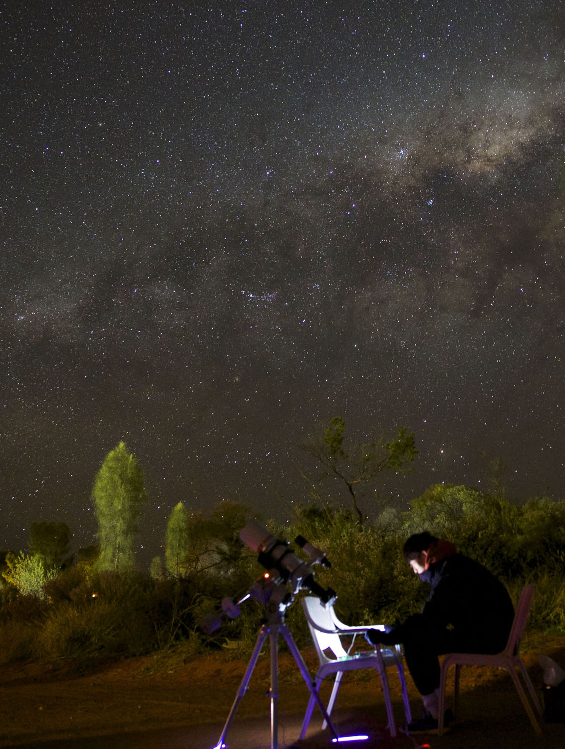

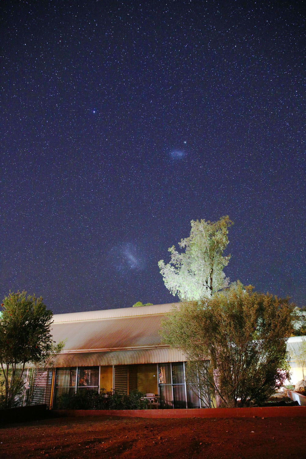

7月尾和25個學生到澳洲東南部考察地理及到中部觀星。由於只得3 晚的觀測時間, 拍攝還是掃射式。但天空質素實在好, 所以照片還可以。
好像發錯了主題...
無論如何, 先上傳一些環境照:
工作中的望遠鏡
南天銀河
工作中的學生
大小麥哲倫星系

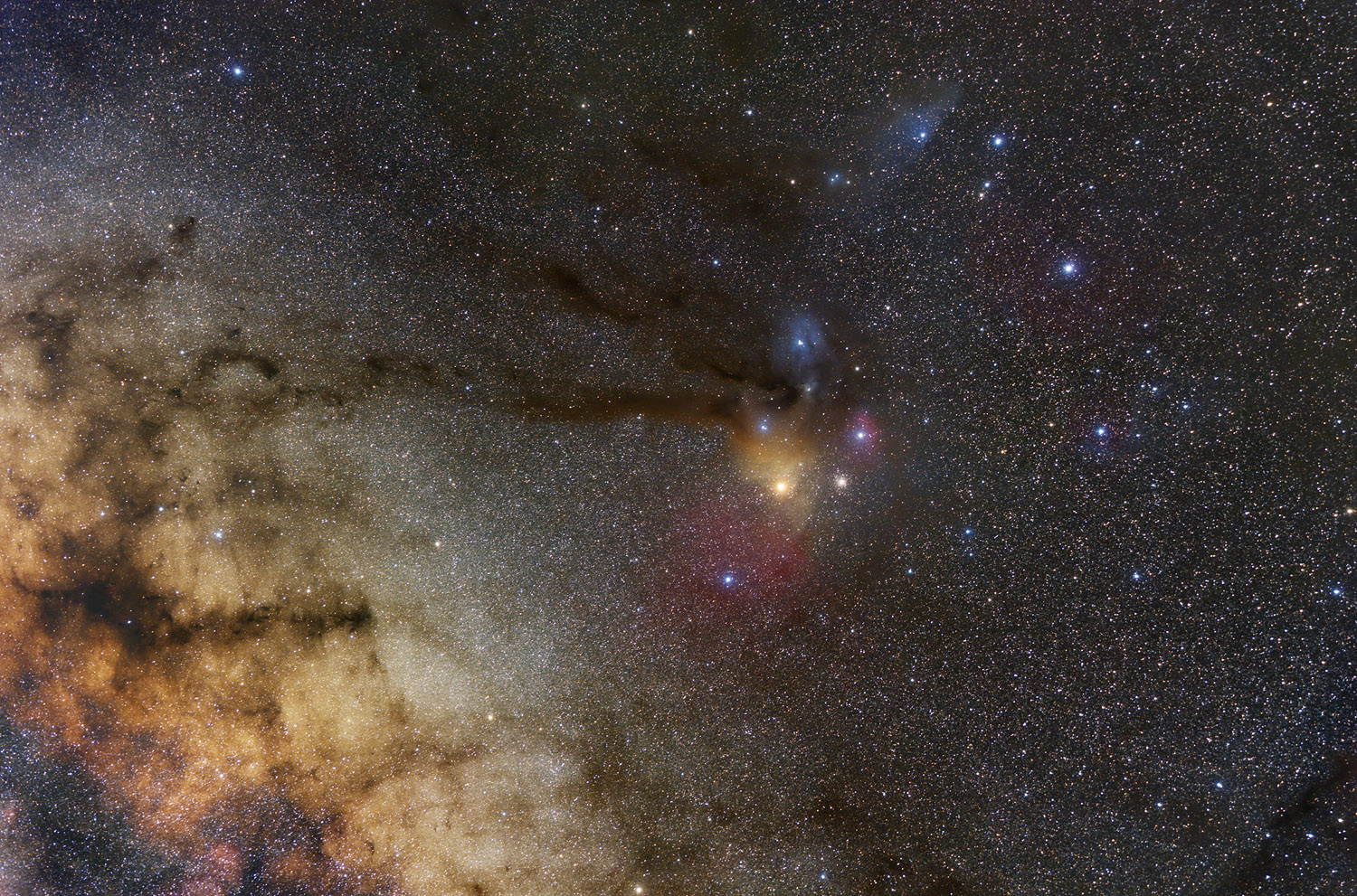

IC4592 (The Blue Horsehead)
Optics: Borg 125SD, 7870 0.7x reducer
Mount: Takahashhi EM11
Camera: Canon EOS 6D modified, ISO800
Exposure: 30x300sec (2.5 hrs)
Guiding: Lodestar, 50/200 guidescope, PHD (dithering enabled)
Softwares: Photoshop, DSS, Pixinsight, BackyardEOS

文章社長 » 2014-09-22, 21:12
PaulNg 寫:既然係咁出張比家睇:
這馬頭我也有拍,陰差陽錯,西藏拍攝時總遇到些問題,至今沒處理好  :oops:
用這類Borg鏡拍的照片可以很有美感,但不可細看,至少不太適合100%出圖。
用它拍RGB然後跟冷凍相機的L合成還可以,但單靠這鏡本身是打了點折扣的。
viewtopic.php?f=17&t=3604#p22830
看到你使用的軟件有點好奇,請教一下,為何不單靠MaximDL拍攝(有Dithering),然後用PixInsight處理便算?
P.S., 論Dithering我較喜歡TheSky用的spiral dithering,MaximDL只有Random的不太好。

The double-fan diffraction and CA were outside the APSC region. This was exactly what I encounter before. After fine tuning for full frame, moving it "about 4mm" further, both double fan & CA will be improved. In my case, matching 7870 and APM 80/480, the stars at corners are not perfect. However, the result is acceptable. Maybe Borg reducer works perfectly with Borg objectives.
Re: 7月尾澳洲Ayers Rock之旅
文章社長 » 2014-09-23, 07:15
willis 寫:The double-fan diffraction and CA were outside the APSC region. This was exactly what I encounter before. After fine tuning for full frame, moving it "about 4mm" further, both double fan & CA will be improved. In my case, matching 7870 and APM 80/480, the stars at corners are not perfect. However, the result is acceptable. Maybe Borg reducer works perfectly with Borg objectives.
情況不只這樣,是星點有一定光暈的,尤其是光譜藍端,所以我說拍單反講求整體美感可以,或以單反做彩色通道,跟其他鏡配冷凍相機的L通道合成還可以,單靠自己100%出圖不太成。
就算我的Borg 60ED配7870,合成f4.1也是這樣。
單平場不減焦應會好些,但我未測試過。
文章PaulNg » 2014-09-23, 08:23
I'm glad to hear that. I'll do further adjustments to test it out. I can live with FSQ-ish diffraction gaps, but this is too much.
社長 寫:情況不只這樣,是星點有一定光暈的,尤其是光譜藍端,所以我說拍單反講求整體美感可以,或以單反做彩色通道,跟其他鏡配冷凍相機的L通道合成還可以,單靠自己100%出圖不太成。
單平場不減焦應會好些,但我未測試過。
小量藍/紫光暈不是太大問題, 在我的照片中這樣的光暈還是可以接受的. 我另外配了一個2.5"的flattener, 試拍過一次沒有這樣的問題,所以我相信是7870的設計不太好。我其實非常希望可以有一個高質的減焦平場鏡匹配125SD,不知道給triplet用的Riccardi 0.75X可不可行。

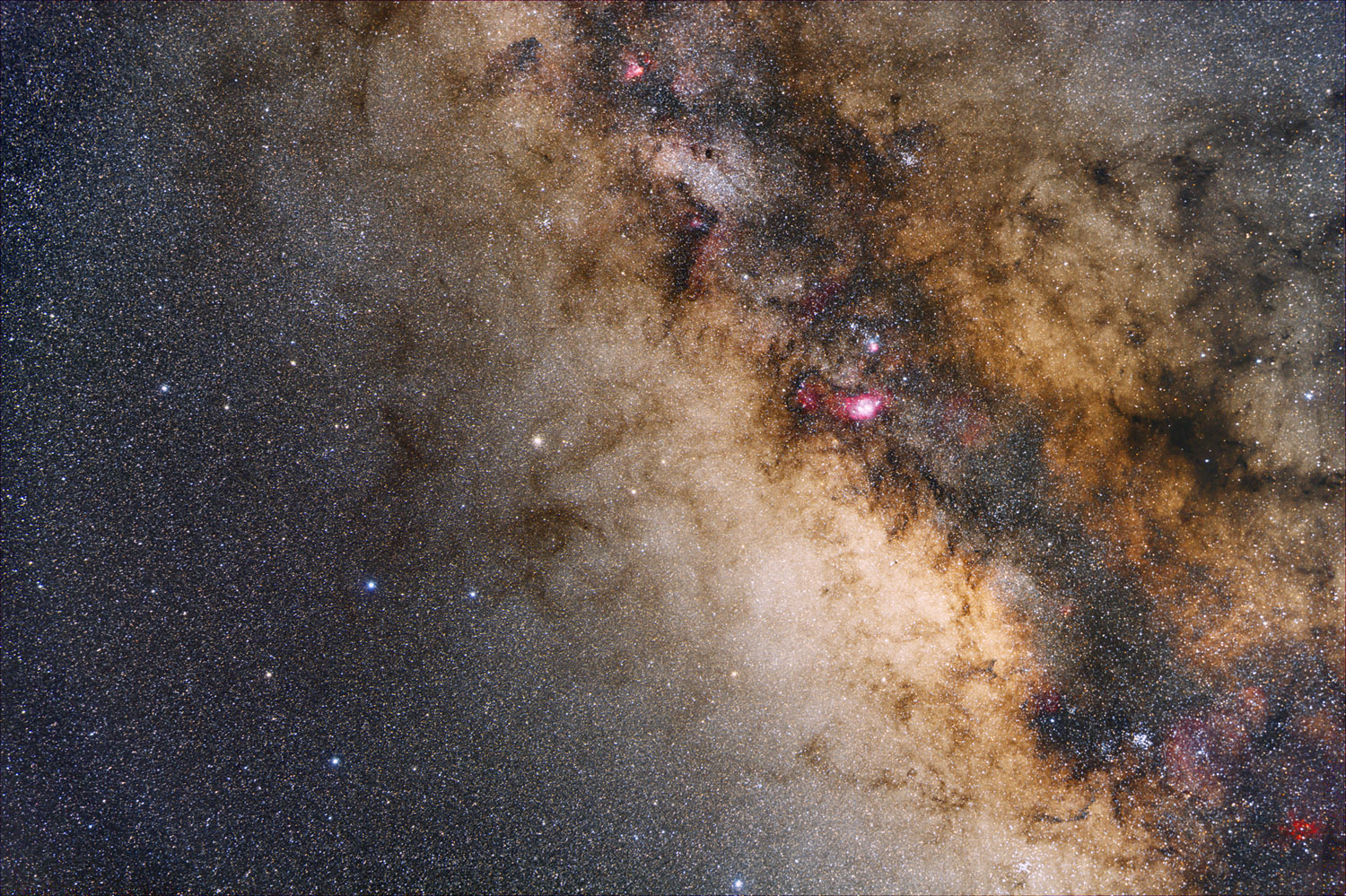

天蠍頭及中心
Canon 5Dii modified, iso1600, 24-70ii (70mm f/4)
Exposure 3min x 30
Toast-pro

用球頭做不到精確構圖及相機角度旋轉,所以做成這兩張mosaic失敗的作品.
Milkyway Centre and Sagittarius
Canon 24-70mm F/2.8 Lii (70mm f/4)
Canon EOS 5D Mark II, ISO1600, 3min x 25
TOAST Pro

PaulNg 寫:用球頭做不到精確構圖及相機角度旋轉
我到過澳洲出席天文館會議,但未試過在當地拍攝。
有點懷疑拍廣角銀河,或多或少到這面貎已差不多? 感覺在不同地點,天空質量好的話,拍到這深度也某程度上到頭了? :roll:
P.S., 亦是同樣原因,我一直避免用球頭,寧可用一片鋁角去解決橫直倒的問題。
