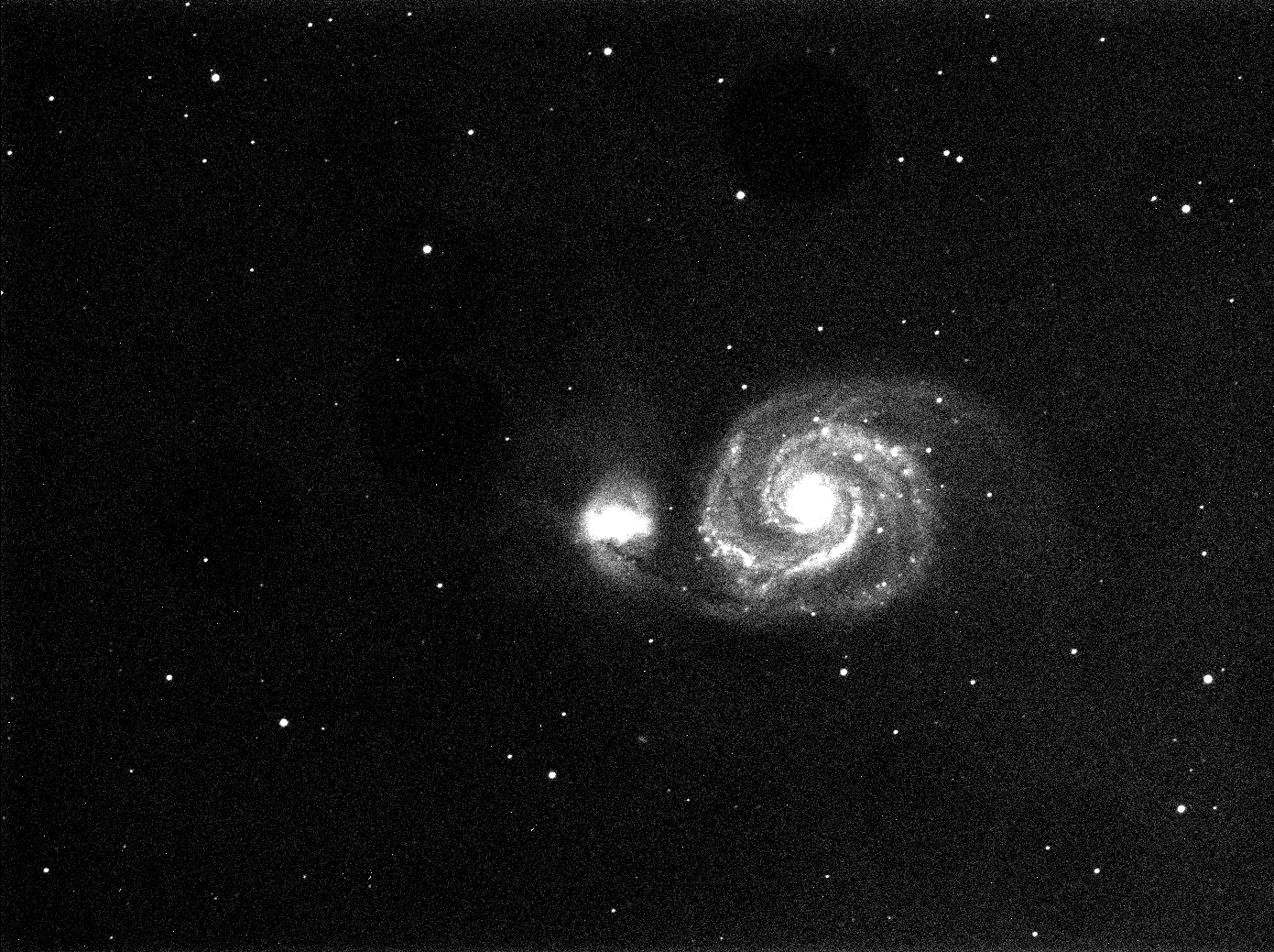

Just try 10 min autoguiding M51 by PHD. The Dec side of the scope is not balanced as the front of the scope is a bit heavy.
Autoguiding result is still acceptable though not perfect.

Single capture 10 min autoguided M51. No dark or flat.
Autosave Image -001L600.jpg (1.39 MiB) 被瀏覽 18911 次

Raymond TSE 寫:Single capture 10 min autoguided M51. No dark or flat.
可塑性很高的M51,Raymond 好波!! :D
給有志在香港弄遙控天文台的愛好者又一枝強心針。
早兩天下班後幫一位朋友弄他的APM 203 APO + Paramount ME,我也鼓勵他在自己的天台試試實現一個簡單的遙控配套,至少拍深空時不用整晚坐在鏡旁守候著。

Star imaging is no longer a single person event. Just setup after dark. Diner with family. Watch tv etc.
Previously each image outside is about 1 hr exposure in total. Now thinking about 10 hrs each when you can
Save ard 2 hrs exposure each night , such as during this week.

對,有了遙控天文台,便可以向一些以打游擊來說永不可能實現的目標進發,若是打游擊+好天空,或遙控觀測站+普通天空,我不一定選前者。幸好我現在是遙控+好天空。

Lucky this week with almost 7 clear nights from Monday to Sunday.
After solving the goto question on Wed 06-03, I was able to collect 5 consecutive days of photos from Wed up to Sun nights.
Already gathered 3.8hrs of L frames for NGC3628 and 6.5hrs of L frames for M51.
RGB & Ha for M51 to be done later.
Very pleased with this kind of efficiency for imaging session up to 2.30 am odd each night.
No need for all night through.
With automated imaging software, the efficiency/photo quantum could further be extended.
Cool !
Raymond
